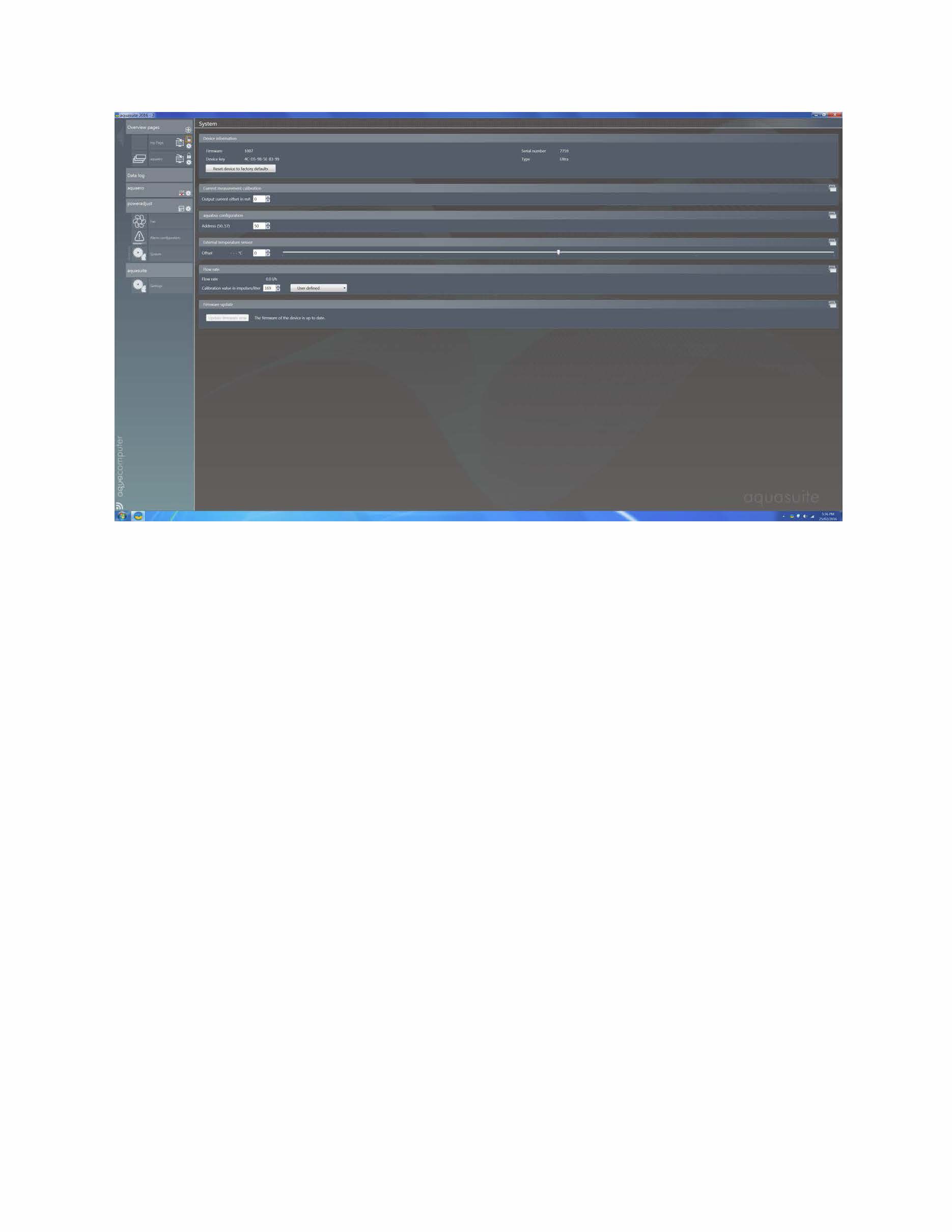

OK here are attachments, that's the only way I could upload them. I have try saving settings but no go.
This is by far the longest I ever spend on trying to configuring either software or hardware on my PC :(

I still don't think your address assignments have been changed. Please plug in all three via usb only if you can and show the address assignments for each. If you can't do all three, one by one is ok.
The image above has the default address. Don't know if that's what it's supposed to be but I want to see the change.

The image I posted was when PA3 was connected via USB before I discovered that the only way I can see PA3 under devices connected via aquabus when I would use 4pin cable .Now when I use 4pin cable to connect directly the first PA3 to aquaero it works, but now if I connect 3pin cable that is connected with the first PA3 (daisy chain) to the second PA3 they both get disconnected.
They both have different ID's that I have assign while they were connected via-USB I can only do 1 at a time I don't have a slitter, but afterwords if I use that 4 pin cable and connect each of those 2 PA3 individually, they show under devices connected via aquabus and they have different ID ...50 and 51 I can make screens of it but that's exactly how it looks, something strange when I try to daisy chain them
Things go wrong when I try to daisy chained them, what cables are you using, that really shouldn't make huge difference, it seems if I use 3pin that came with PA3 nothing works i have try different 3pin cables, same thing ?(
