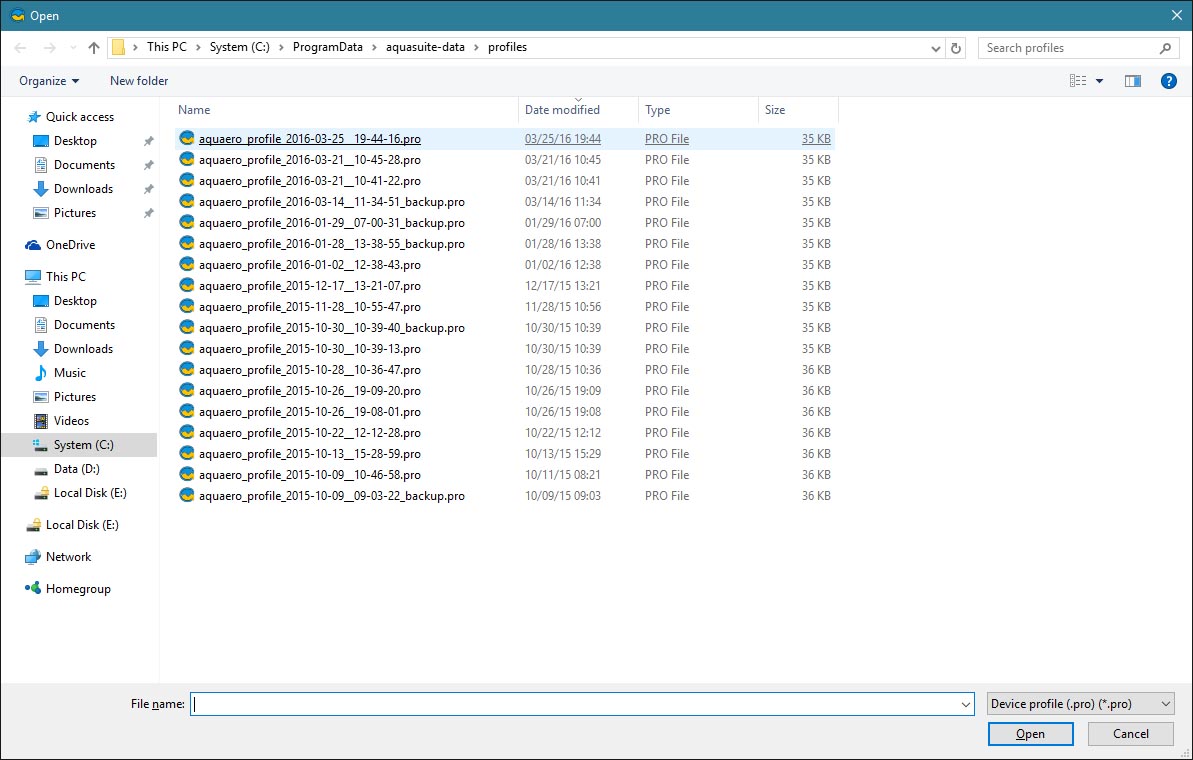

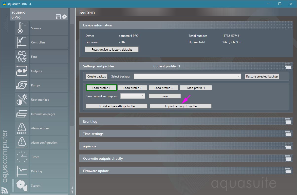

Staring with aquasuite 2016, the program automatically saves the current aquaero profile to disk before updating the firmware.
Then after the firmware and aquasuite update, you just reload your profile from disk, and all settings should be as before..
I don't remember exactly, but if during the update process you are asked if you want to save or keep current data/profile, say yes.
After updating go to aquaero > System > Settings and profiles, and click on Import settings from file.
Then select the latest dated profile in the list and you are good to go.
You can also save profiles manually whenever you want, in case you try different things, and still have the previous profile to go back to.
