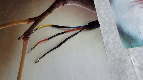

This is how I created them:
After soldering them I used some heatshrink to protect the solder-joint
Then I single sleeved the cables.
I have no idea why it's not working.....

Did you megger the cable with an ohm meter after sleeving to confirm continuity between the two plugs?
Donnerstag, 29. Dezember 2016, 07:12
your cables are reversed! Compare the pin numbers on each side of the cable.
:S I think you are right :pinch:
Looking at this:
I now see that black and yellow are reversed. :whistling: Stupid me!
I'll try it out this evening Tnx!! :D
