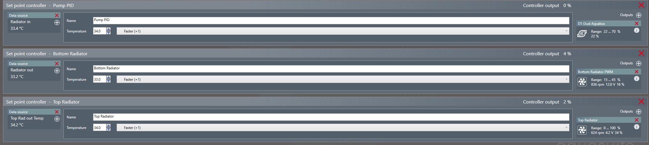

Just installed Setpoint Controller and it's working great.
Thanks
