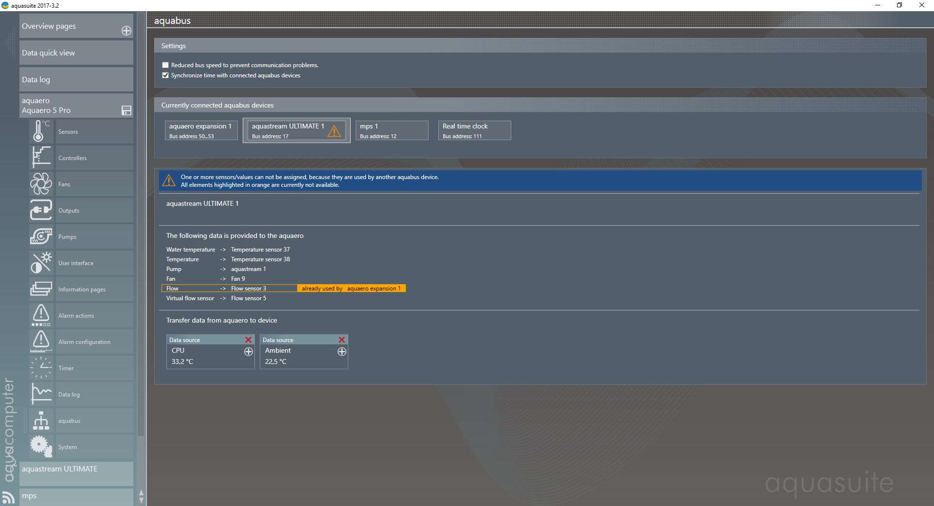

Montag, 8. Januar 2018, 20:47
Hello,
I updated to the latest version(2017 3.2). But since the update my Aquaero 5 Pro won't display the flow sensor connected to the Aquastream Ultimate. Attached is a screenshot of the problem according to Aquasuite.
Hoping someone can help me.
»Mechanic-B« hat folgende Datei angehängt:
  • Flow sensor.jpg (137,55 kB - 263 mal heruntergeladen - zuletzt: Heute, 06:13)
Dieser Beitrag wurde bereits 1 mal editiert, zuletzt von »Mechanic-B« (8. Januar 2018, 20:49)
Dienstag, 9. Januar 2018, 01:27
You have to connect the flow sensor to the aquaero or slave aquaero. There is no other solution
Dienstag, 9. Januar 2018, 13:58
Hello
I have not been on these forums for a while but recently noticed there is an updated for Aquasuite.
Is the update free for all users so I remember newer version of the software would be chargeable.
The aquasuite 2016-5.3 is the only version which is free for everyone who has no license for newer versions.
Mechanic-B
Dienstag, 9. Januar 2018, 19:09
wpuser,
That is a usable workaround. However it has a negative result to the possibilities of the Aquastream. Unfortunately it comes as a result from the firmware update, since it worked in the previous version.
And in my personal case, would create quite the amount of work. Maybe it is possible to fix in the next update.
Dienstag, 9. Januar 2018, 20:38
It is not possible to fix that because it is no bug or anything like that. The latest firmware for aquaero slave devices can also transfer the data of a flow sensor now; that was not possible with the previous version. More data also means more shared resources which can lead to conflicts in some setups like yours. Since the aquabus management has to follow a specific topology and we do not have endless resources to map everything into anything, we had to prioritize some values over others. In your setup it would be more likely that a customer connects the flow sensor directly to the master device to minimize the whole communication chain.

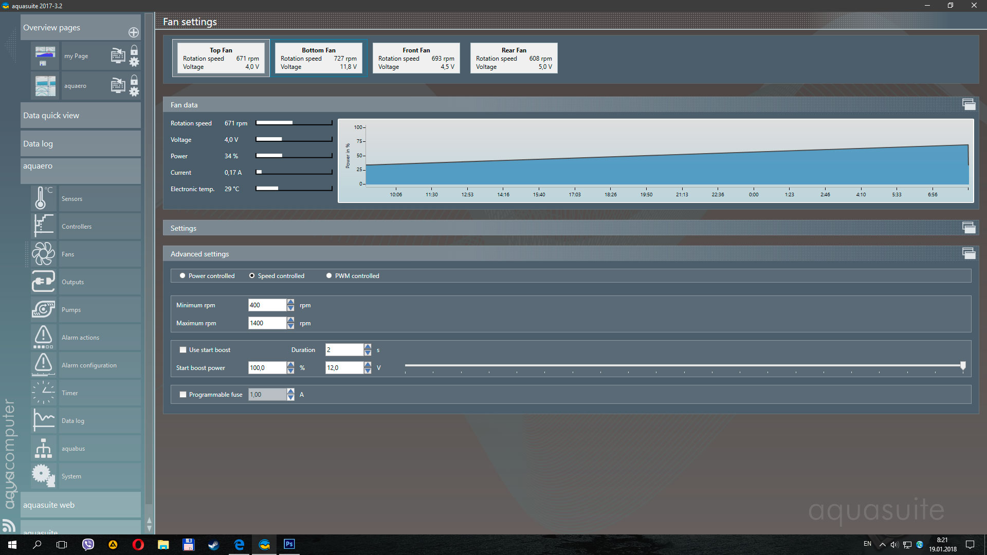

Dienstag, 23. Januar 2018, 02:18
Why aquaero do the start boost for fans even if it disabled in fan settings?
»Syberon« hat folgende Dateien angehängt:
  • screen1.jpg (391,7 kB - 174 mal heruntergeladen - zuletzt: 14. März 2026, 14:38)
  • screen2.jpg (281,77 kB - 218 mal heruntergeladen - zuletzt: 29. März 2026, 21:56)
Dienstag, 23. Januar 2018, 06:52
I'm OK if new version of aquasuite prohibits aqua devices from being seen by 3rd party software (like AIDA64) but I want to be sure it is not a bug...
Thanks.
no, maybe the protocal has changed in the last version
your fan is SPEED controlled, when you set your fan to POWER controlled you have the normal behavior.
Syberon
Dienstag, 23. Januar 2018, 10:24
And why this behavior for speed controlled fan? Speed limits calibration?
Dienstag, 23. Januar 2018, 12:58
This is a closed loop controller.
The controller give 50% output, this is scaled to a rpm setpoint (depend on your min max settings).
The controller try to hold this rpm.
This is a normal behavior.
Syberon
Dienstag, 23. Januar 2018, 13:36
Thanks for explanation:)
