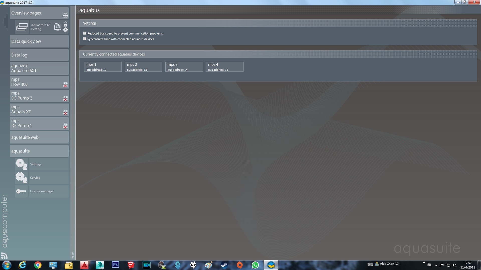

MPS Not connected
Mittwoch, 11. April 2018, 12:51
Dear all
My device update software and firmware after
Not connected MPS
please help me
Thanks All
