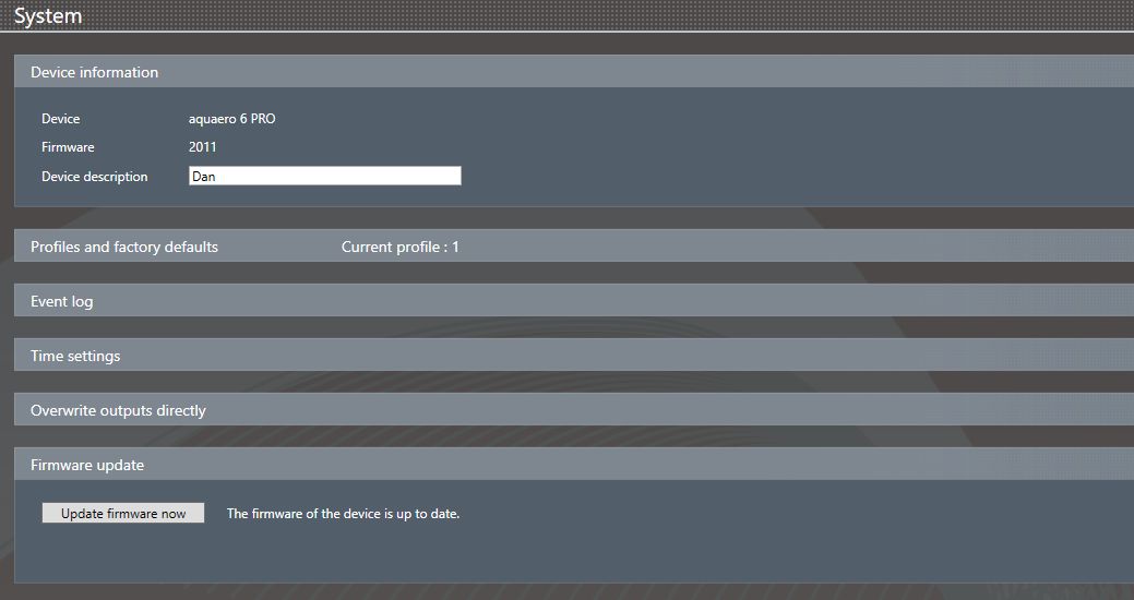

Freitag, 24. August 2018, 00:00
Nope, I'm running 2011 and it also says "The firmware of the device is up to date."
Maybe because I have an Aquaero 6 Pro (I mistakenly stated I had an Aquaero 6 XT above)?
I have tried to update the firmware twice through Aquasuite, and it remains on 2011.

GTXJackBauer
Freitag, 24. August 2018, 01:54
What version of Aquasuite are you running? I believe you're on 2017 while we're on 2018 as I also have the 2100 firmware version because I upgraded to 2018.
In most cases, when you update to the newest annual software suite, it will need us to update our firmware. Usually because of new features and or hardware that can all be part of the AQ system.
Just make sure you save everything prior and follow the instructions on keeping your existing settings, etc.
Dieser Beitrag wurde bereits 1 mal editiert, zuletzt von »GTXJackBauer« (24. August 2018, 01:56)
Freitag, 24. August 2018, 08:48
This message means your specific combination of aquasuite and the required firmware for the aquasuite version that you use and not the firmware version in general.
bakedbeans6
Freitag, 24. August 2018, 14:44
OK, that makes sense. I am on Aquasuite 2017-3.2 -- I guess it's time to upgrade!
Thanks, Shoggy!
EDIT: Updated to Aquasuite 2018-6 and firmware 2100... OOOOH IT'S SO PRETTY 8o Thanks for all the help, everyone!
