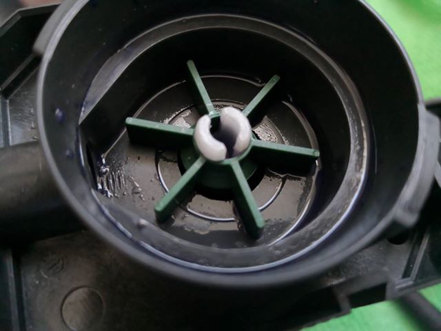

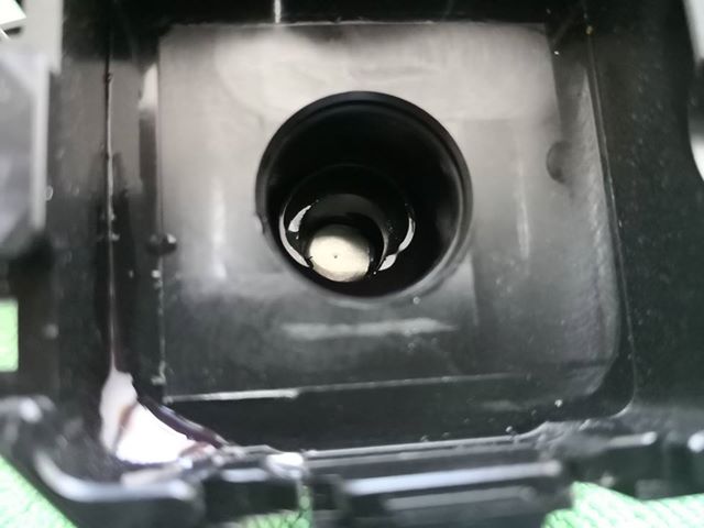

hi there ... just done what You daid here aare some vid ...all aroud pump in side was clean after all I have done all the same pum rotate highly but flow rate very slow ... just dont know what to do now ...
https://www.youtube.com/watch?v=MZjmTdUzmyo&feature=youtu.be
https://www.youtube.com/watch?v=eUV1BJCNHOs&feature=youtu.be
https://www.youtube.com/watch?v=yFC5AmqiEu0&feature=youtu.be

Based on the residues that the impeller shows I am quite sure sure that at least your CPU block must be clogged.
I can not tell from the photos or video if the impeller runs smoothly on the axis. If you try to remove the axis and push it back in again, this must be possible without any noteworthy resistance.

Donnerstag, 27. September 2018, 08:30
Good eye shoggy. I also saw that but wasn't sure what it was. Great chance with the use of color fluids breaking down and maybe plasticize, you could have clogs in that loop. I would recommend a complete tear down and have a look in the CPU block.
