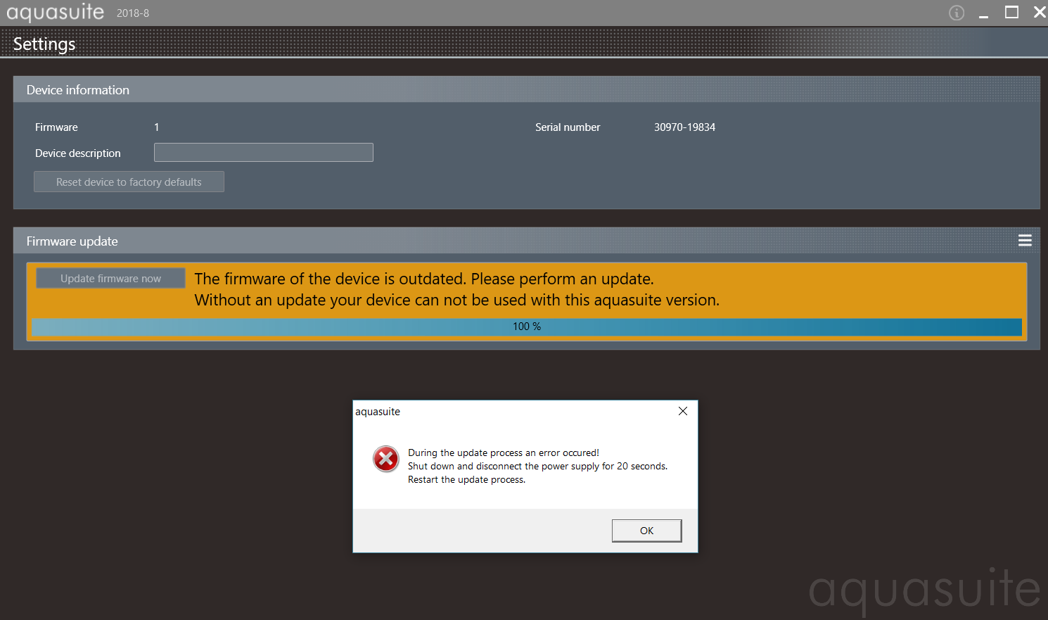

Hello! I am an English speaker in the United States. I purchased a new Quadro from Aquatuning.de. First time working with you and this retailer. When I started Aquasuite 2018-8 for the first time, it said that it needed to update the firmware on my Quadro before it would work with that version of Aquasuite. I clicked to update firmware. It reached 70%, then displayed an error. I've attached the error message. When the error message displayed, the fans connected to the Quadro stopped spinning. When I had first booted, they spun at full speed.
I have not been able to update the firmware. I've tried many different times. The LED now flashes red and the fans never spin up. I've tried on an Intel computer and an AMD computer, and neither have worked. I've disconnected all fans and the temperature sensor. I've tried changing the USB polling rate, but I couldn't get that to work (I'm running Windows 10). The manual does not describe a way to factory reset the device so I have not been able to try that. I don't know what else to try.
Please help me! This device seems really nice but I can't use it!
»cobaltskky« hat folgendes Bild angehängt:
Freitag, 9. November 2018, 08:30
Please send an e-mail to info@aqua-computer.de and include your postal address.
