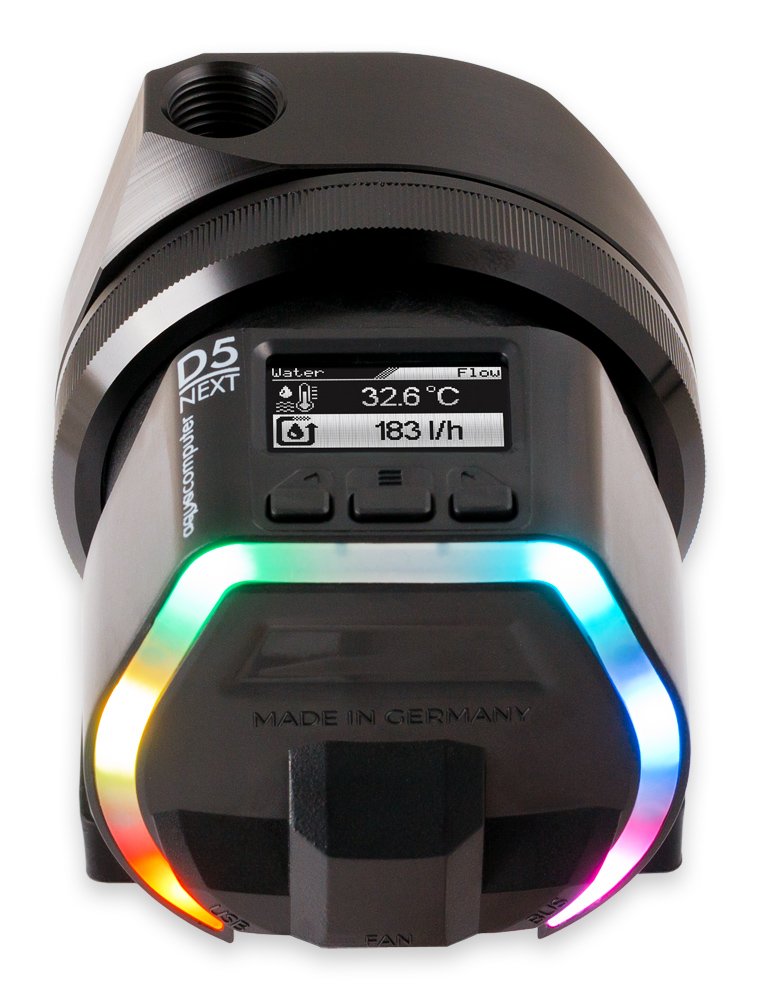

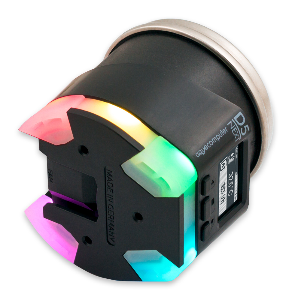

We are proud to present our latest development to you today:
D5 NEXT - the complete solution
(Photo shows D5 NEXT with ULTITOP D5)
Durable ceramic ball bearing motor, highly developed electronics
Based on the ingenious principle of the Laing D5 ball motor with ceramic bearings, we have used our know-how from more than 15 years to create a pump that is unparalleled worldwide and covers almost all electronic tasks in water cooling just in a single device.
Quiet and powerful
The pump combines the outstanding running characteristics and performance of the legendary D5 pump with electronics that simply leave no wishes unfulfilled.

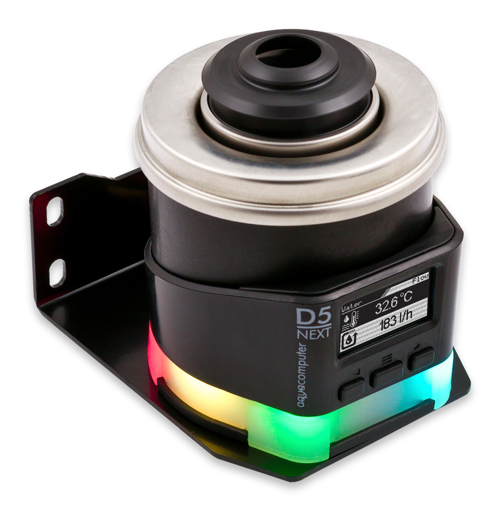

(Second photo shows D5 NEXT with ULTITOP D5)

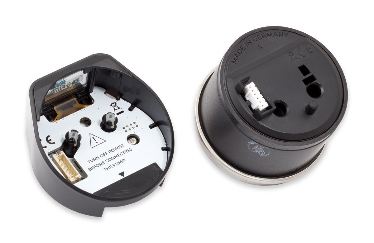

Ingenious: Pluggable electronic unit for easy installation
In order to make the assembly as easy as possible and to enable later updates of the electronics, we have divided the pump into a motor unit and an electronics unit. Both modules are securely connected by simple plugging and can be easily disconnected to mount a pump top.
In addition, the electronic unit can remain connected to the computer during pump maintenance. All cables and the fixing of the pump do not have to be loosened!
Fan control, sensors, RGBpx, AMBIENTpx, alarm buzzer - allready integrated
But the D5 Next is more. It controls a complete water cooling system including the fan, already has all necessary sensors and can even take over the lighting including AMBIENTpx for the ambient backlight of your monitors – controlled by RGBpx.
Even an acoustic alarm in case of errors is integrated and an additional RGBpx lighting integrated directly into the pump for great optical effects.

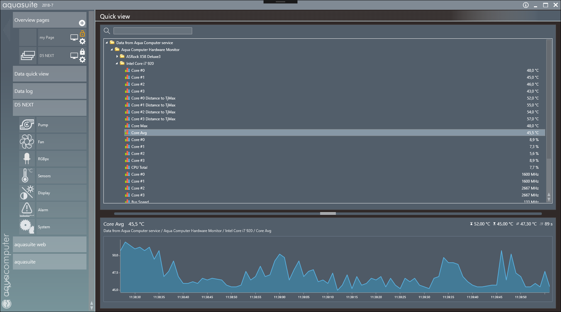

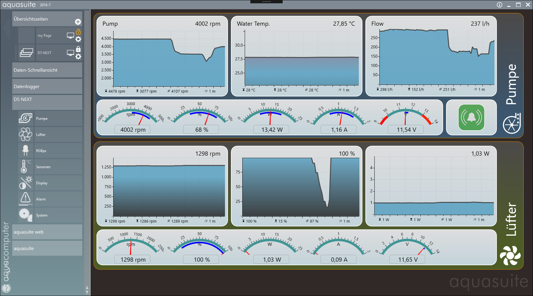

aquasuite: The benchmark for control software
With the aquasuite software we set the standard for control software. From freely configurable overlay pages shown at the desktop or aquasuite Web as IoT connection to integrated hardware monitoring or data analysis - there is simply nothing comparable at the market. With the D5 NEXT, the aquasuite is included in the scope of delivery and you can start immediately.
The D5 NEXT communicates with the aquasuite software via a USB 2.0 interface and you can comfortably make any settings and monitor the pump data.

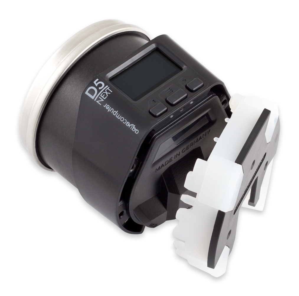

Decoupling system - directly integrated with LED effects
We have integrated an innovative, FEM optimized decoupling system made of ultra-soft silicone and provide the necessary accessories with a mounting bracket for all possible mounting types! The silicone decoupler is also illuminated with great effects given by RGBpx LEDs integrated into the pump. For example it is possible to visualize the speed of the pump by the LEDs. In the event of an alarm, an optical alarm is shown by red flashing LEDs at the pump.
If the pump is attached to an expansion tank and not attached via the decoupling system, the decoupling system can be exchanged against a flat silicone insert which is included in the scope of delivery and can also be illuminated.
Of course, the LEDs can also be deactivated and their brightness adjusted.
OLED, USB, Virtual Flow, water temperature - everything you need!

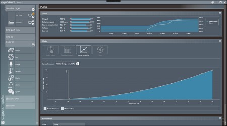

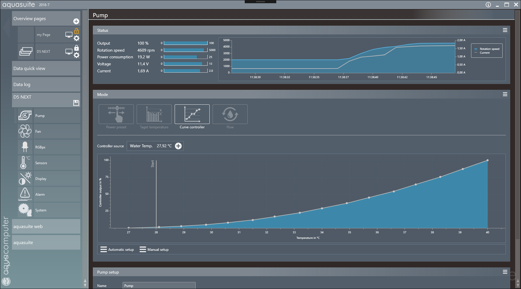

The performance of the pump can be set directly on the display of the pump or via USB with the aquasuite software. Speed and current consumption are monitored by the electronics. The integrated Virtual Flow sensor technology even allows the flow rate to be set directly and the pump adjusts itself automatically.
Fan output with 25W power and many control options
Via the fan output of the pump PWM controlled fans can be controlled e. g. according to the water temperature. The well-known controllers including curve and setpoint controllers are available. The D5 NEXT can also switch off the fans completely. The power here is max. 25 W and should therefore be sufficient for almost any system.

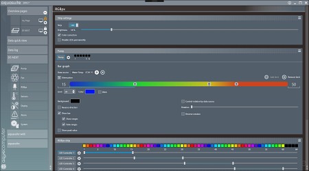

Controlling up to 64 digital LEDs with RGBpx
The support of RGBpx also deserves special mention: The D5 NEXT offers the same functionality as the QUADRO fan controller. Up to 64 RGBpx LEDs can be controlled individually in color and brightness after many controls.
LED bargraphs, sound effects, monitor backlighting (AMBIENTpx)
All wishes are fulfilled: From bargraphs that display temperatures, CPU load or other monitoring values to sound effects, artificial snowfall and the enormously complex AMBIENTpx function that illuminates the background of the monitors depending on the current screen content giving a perfect ambient light, everything is possible.

Software sensors: Use hardware sensor data to control the system.
Monitoring values of the PC or other Aqua Computer components can be used to control the pump, the fans or RGBpx effects. Up to 8 software sensors can be defined. These sensor data are transferred to the D5 NEXT by the background service of the aquasuite using the USB connection.

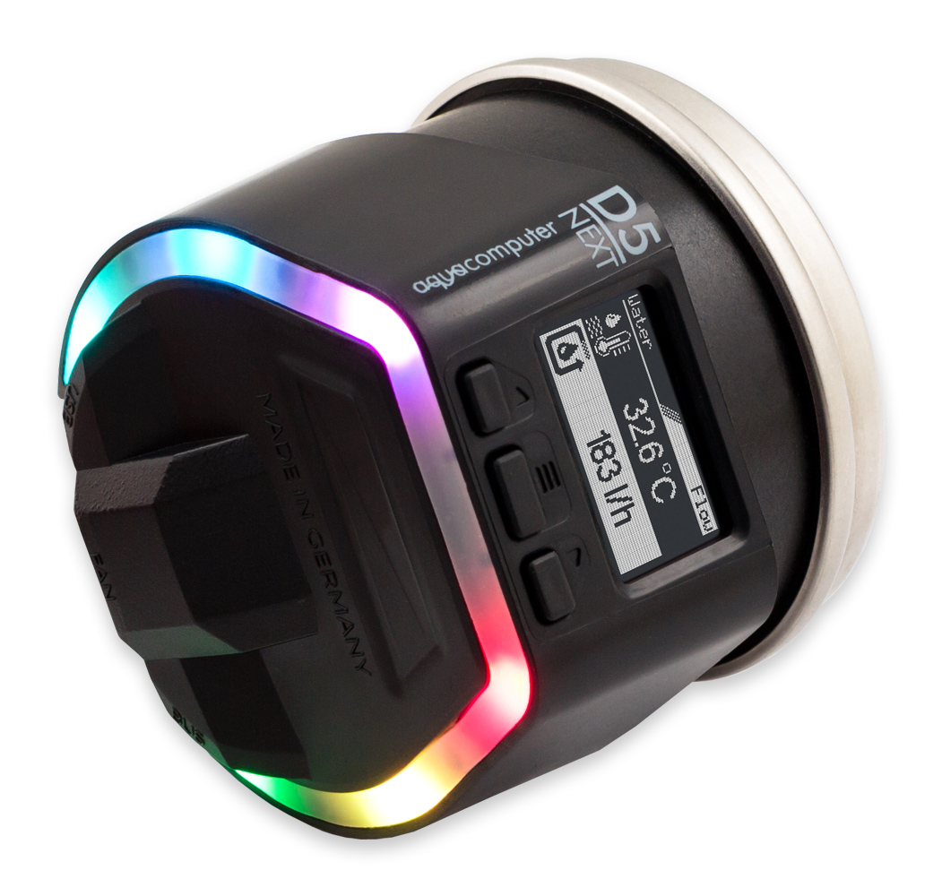

Mechanical keys combined with touch operation
The pump is operated via mechanical keys or via an intelligent touch slider (only available if decoupling is not used). For example, performance specifications can be set quickly and directly with a simple finger move.
OLED with freely configurable display screens
The OLED display with 128x64 dots shows menus, overview pages and charts. Of course, almost everything can be adjusted individually.

The D5 NEXT is pure high-tech. It combines a mechanically perfectly constructed pump with an extremely low noise level and electronics that is unique worldwide. The integrated decoupling system adds additional functionality.
We can't show you all the functions here - test them for yourself, we are sure we can convince you.
In connection with the also new ULTITOP D5, which has been optimized for silent operation, we can present today a pump that will convince you!
(third photo shows D5 NEXT with D5 ULTITOP)
Technical data:
  • BLDC Motor
  • Ceramic bearing, ball motor (aluminum oxide / hard carbon)
  • Pluggable motor and electronic unit
  • 3,7 m Delivery head
  • PWM fan output and switch-off function, 25W, 2A, option for flow sensor
  • SATA power connector
  • USB interface
  • aquabus interface or RGBpx output for max. 64 LEDs
  • AMBIENTpx support
  • integrated very accurate water temperature sensor
  • Virtual-Flow: Calculation of the current flow rate from the motor data
  • integrated alarm buzzer, freely configurable alarms
  • 6 RGB LEDs integrated in the pump with adjustable effects (e. g. rotation dependent on pump / fan speed)
  • Graphic OLED with 128x64 pixels
  • 3 buttons and touch slider for menu operation and selection of display pages
  • 8 software sensors for external data, e. g. CPU load, CPU temperature, etc.
  • Pump performance controllable according to flow specification
  • max. power consumption: 23 W pump motor, 25 W fan, 17 W RGBpx. Total power max. 65 W, typical 20 W.

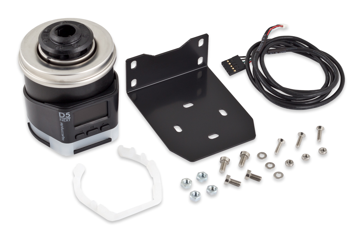

Scope of delivery:
  • Pump consisting of motor and electronic unit
  • Decoupling kit
  • silicone insert for mounting without decoupling
  • mounting bracket (black coated)
  • USB cable (internal)
  • screw set
