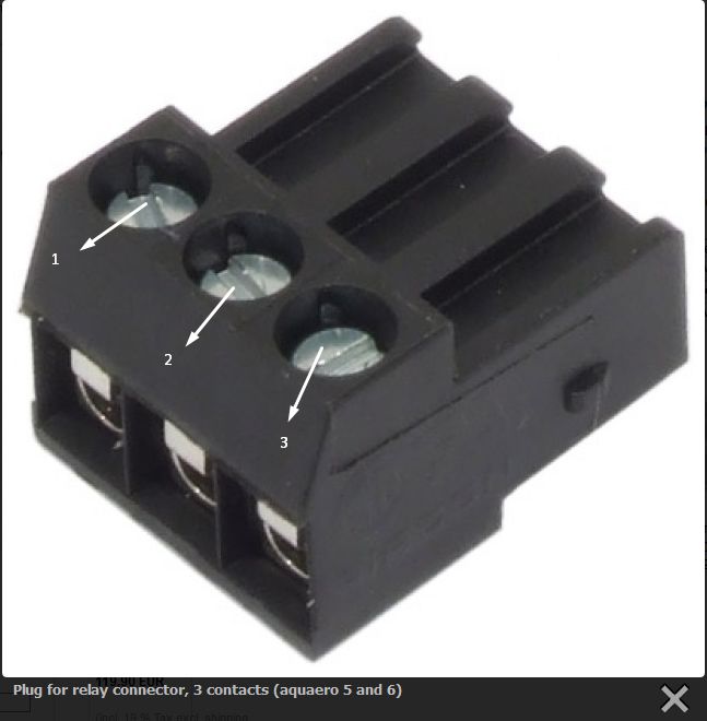

But how do i what the positions are on the relay plug?
see atachment
sorry me not a techincian guy. just an over joyed newly watercooling dude that went full in to it :)

See the attached Picture for the Pins on the Relay Header.
