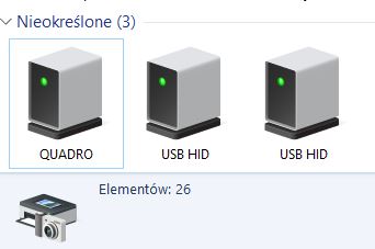

Today I connect QUADRO to my PC and OS detect it but Aquasiute not..
»kn5« hat folgende Dateien angehängt:

So, if I connect Quadro directly to MB Asus Crosshair VI Hero (internal connector, there are only two!) Quadro is recognized by Aquasiute :)
If I connect via HUBBY7 (53230) then, it is not detected by Aquasuite, but Windows detects the device.
Other devices like D5 and USB ports on the front work fine with HUBBY7.
Unfortunately, I need more than two USB ports. (Aquaero, D5, Quadro, USB x4 ...)
Aquaero also not working witt HUBBY7
Is HUBBY7 damaged or is it incompatible?
Thanks
