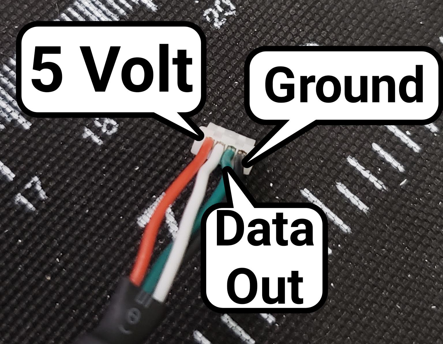

RGBpx Pinout and the 4th Wire
Sonntag, 13. November 2022, 18:35
I think the 4th conductor on 4-pin ARGB connectors is data out. Corsair uses this in conjunction with their RGB hub to daisy chain the LEDs in one strip or fan to the next. The 4 conductors are +5VDC, Ground, Data In, and Data Out. RGBpx pin 3 (white wire) is not connected to anything because AC does not route the Data Out back through the connector and cable like Corsair does. Here is a picture of a Farbwerk360 that shows what is on each pin.

Hi and sorry for delay. I needed to order some connectors as well however below is the result.
https://youtu.be/WFTsLIfoW9o
As you can see on the clip, the green wire going from Farbwerk 360 is in the end not connected at all. There is a conflict in wire colors between the 50cm cable going from Farbwerk 360 and the 50cm extension cable, they simply doesn't match anymore and is "upside down" - black became red, red became black, green became white and white turned to be green. It's how these parts just been shipped to me and I guess they haven't been assembled correctly at the factory. It's just cosmetics and something to remember when connecting LED strips, otherwise a short circuit will occur.
