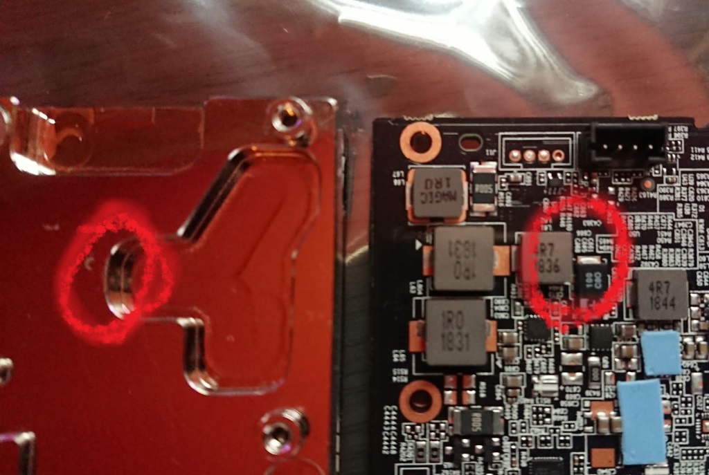

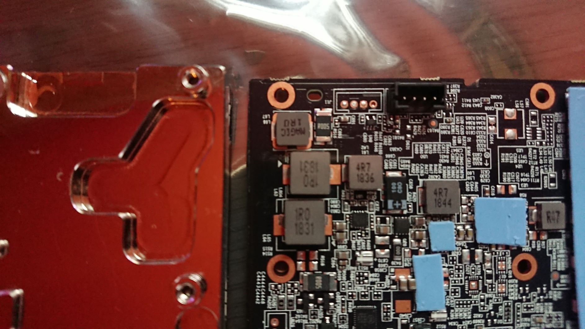

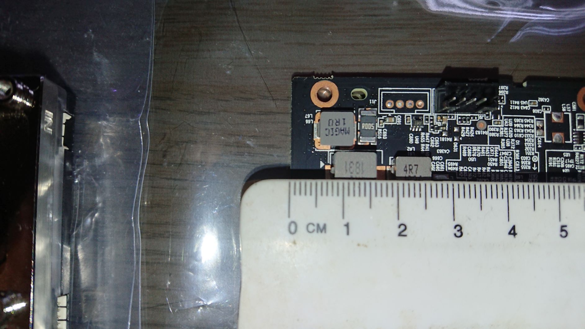

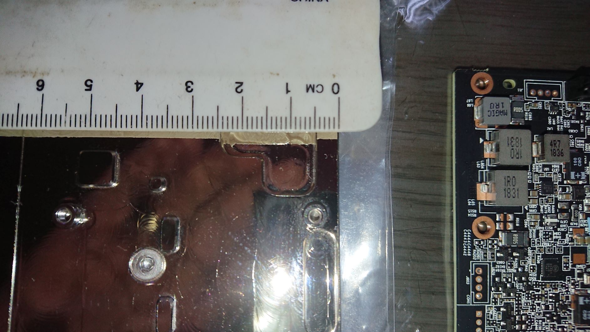

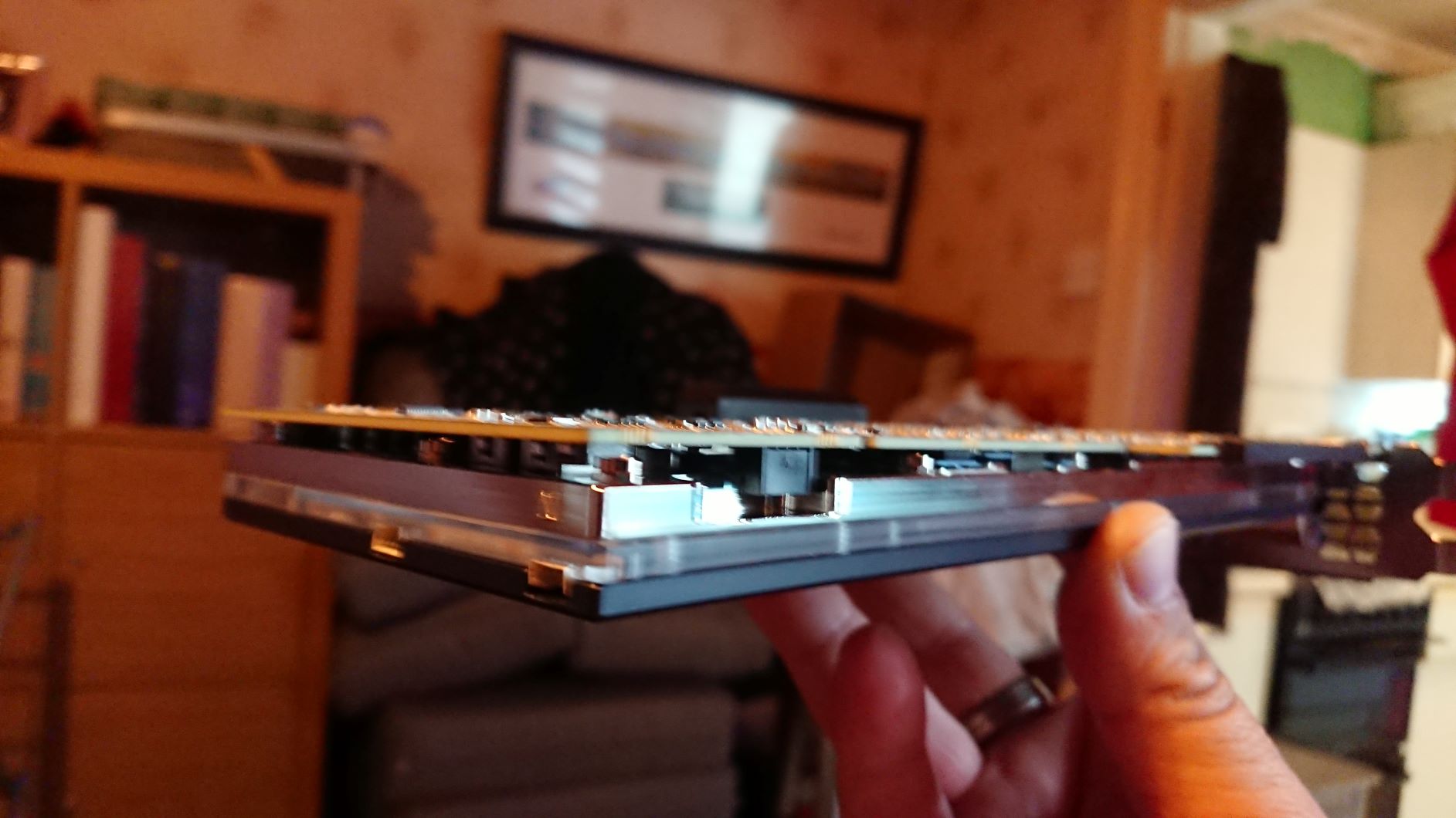

I am very disappointed at waiting 4 months for my order: 391194. To find that it doesn’t even fit my Gigabyte Gaming OC card as promised, I have attached pictures of the problem with measurements, there needs to be about another 2mm out of the slot to assure proper clearance.If you check this link : https://imgur.com/dXlTpUs it shows the difference in the FE and Gigabytes gaming OC cards. If you check the capacitors on the bottom right of the board (which is where my issue is).You can clearly see the caps are spaced out more on the gaming OC card, and you have obviously overlooked this. 8| I cannot believe that after 4 months you have still sent me a cooler with a fitment issue, I have now disassembled my graphics card assuming it would be right, and to be quite honest this is not good enough when you are charging a premium price for these, people assume it will work and it will be received in a timely manner, my experience with aquacomputer thus far is not a good one at all [font='&quot']☹[/font], I am very unhappy with the service as a whole, i have been lied to about delivery dates on 2 separate occasions, the wait is just absolutely ridiculous, especially when you factor in that you still got it wrong. I think enough is enough and you should send me a shipping label for the block and active backplate as after the wait i have had, and the fact you still made a product that is unfit for purpose, i should not be expected to pay for the return shipping, I want a full refund and i will take my business elsewhere. Sorry but, well what else can i say......... :cursing: :( X(

Samstag, 27. April 2019, 21:06
Did someone at aquacomputer promise that the Gigabyte Gaming OC card would fit?
Because the product page, in the first paragraph, states:
Full cover water block for NVIDIA RTX 2080 Ti and Titan RTX graphics cards according to reference design
I take reference design to mean Founder's Edition.
It would be helpful if aquacomputer provided a compatibility lists on their product pages, as do other manufacturers, but they have always been weak on documentation.

Posted by Stephan page 12 post 236.
Gigabyte theme: The recess for the plug will be included in the next production and be available in about 2-3 weeks. Maximum connector height 7.1mm - just like the plug on the bottom left.Stephan has attached the following image:
