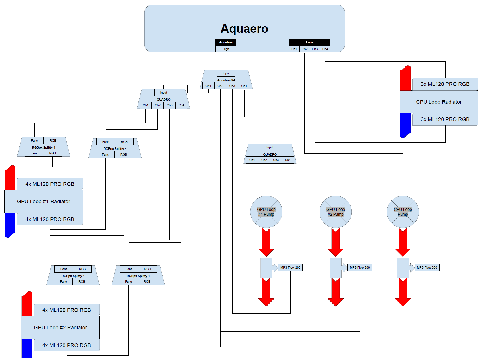

I'm starting to get the schematic laid out. It isn't complete, of course, but maybe it will help show some of my confusion.
If I knew how much power I can run through Aquabus High, that might help clear up some of my confusion.

My first concern is the Alphacool PWM pumps. I don't know if they are fully compatible with the Intel PWM specification, which if not will be a problem for the aquaero. I don't know if the same PWM issue is present with the Quadro. Hopefully someone with definitive knowledge will speak up
Second, I would not run the two Quadros through the aquabus, if memory serves you will loose 4 fan curves on each quadro. I would run them off the USB.

The Schematic looks good. Everything is connected ok.
For the RGB Stuff, you need a Farbwerk 360
Then connect the RGB Input of each Splitty4 to the RGB Ports on the Farbwerk 360.
The aquabus high connector is only for communication with aquabus devices. it delivers <2 Watts.
You need to connect the Quadro to the Power Supply Unit with the 4 Pin Molex Connector.
You need to connect the Quadro with USB to your motherboard for initial setup (to select an aquabus address for the quadro in the aquasuite software) and for firmware updates.
After that is done, you can remove the usb connection from the quadro and only use aquabus to control the Fan speed.

Good to know about the Alphacool pumps. I can run them off of my motherboard if needed. I usually just leave them at a fixed speed anyway, so not having them on a programmable curve isn't a problem. Maybe that's the best option since I would not need the second Quadro + an Aquabus Y-splitter if I did that.
Looking through the Aquaero manual (page 39 of the English manual), it looks like I can have a maximum of two Quadros connected via Aquabus. Is that not correct?

It sounds like I will need two Farbwerk 360 units in order to control all of my fan lights. That will bring the total number of Aquabus devices to 7. Maybe I should use a Splitty9 for this instead of the Aquabus X4?
Can the Farbwerk 360 be connected via Aquabus? I read the manual and it says on Page 5 that there are no compatible products as of April 2019.

No, the farbwerk 360 has an connector, but currently there is not implemented in the device firmware.
You can connect 4 Splitty4 to the Farbwerk360. A Quadro can control 1 Splitty4.
You can choose to buy either two Farbwerks, or one Farbwerk and two Quadros. Then you can control the LEDs of all the Fans.
The Quadro and Farbwerk requires an USB Connection to control the RGB LED Color.
You need a total of 3 USB Connections for the Devices. One for Aquaero, one for each Farbwerk 360/Quadro.
If your Motherboard does not have enough internal USB Connectors, you may need a Hubby7
You can use a Splitty9 for the Aquabus devices. Then you dont need the Aquabus X4 and Aquabus Y-Cables. This saves some Money.
Please set the Jumper on the Splitty9 to Aquabus, before connecting it to the Aquaero.
