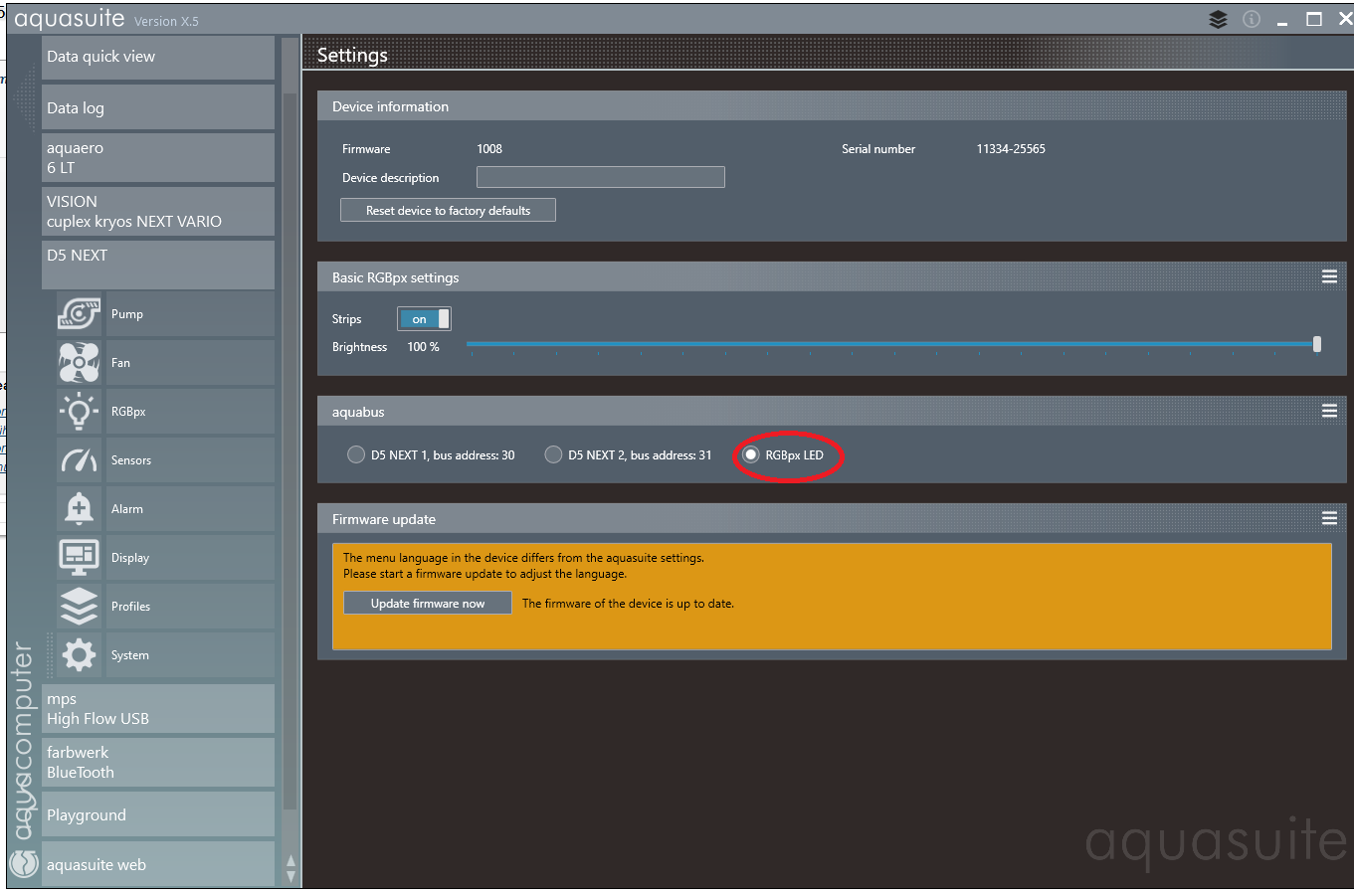

A month ago I started buying stuff for my new project. D5 + RGBpx strips are a part of it.
yesterday I finally assembled everything but I cant get my RGB strips to work. I checked them with my other D5 Next when I got the and there was no problem.
After starting my system for the 1st time Aquasuite did update firmware on D5s. Now after I choose in aquabus RGBpx LED there is only a quick blink and strips seam dead.
I believe that it might be caused by firmware update.
Just so you now - I am sure that the strips are connected in correct order/direction.
The LEDs on the pump are working fine.

You have to go to Aquasuite
And at D5 Next pump go to System and click RGBpx LED
Then all your RGB strips should work now
»DirtyBear« hat folgendes Bild angehängt:
