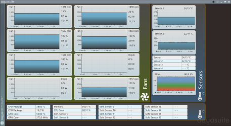

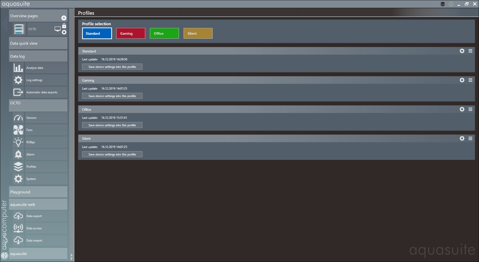

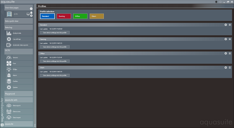

The OCTO is connected to the mainboard via USB and configured using the aquasuite software. Like all our controllers, the OCTO works completely autonomously, software is not required for operation. Nevertheless, the aquasuite can interact with the OCTO via a service running in the background and, for example, transfer temperatures from the hardware monitoring of the mainboard to the OCTO.
All sensor data can be visualized individually in the aquasuite. The data can be displayed on a preconfigured overview page. It is also possible to create your own overview pages. All device settings as well as future updates can be easily managed with the aquasuite. Any number of devices can be used simultaneously - each with its own settings and monitoring.
This means you have all the options: Configure once and then run the OCTO completely autonomously or comfortably with many extended functions. Of course, the OCTO has access to the functions of the new aquasuite Playground. This means that previously unimaginable functions can be set up in just a few minutes and make OCTO an incredibly powerful tool.

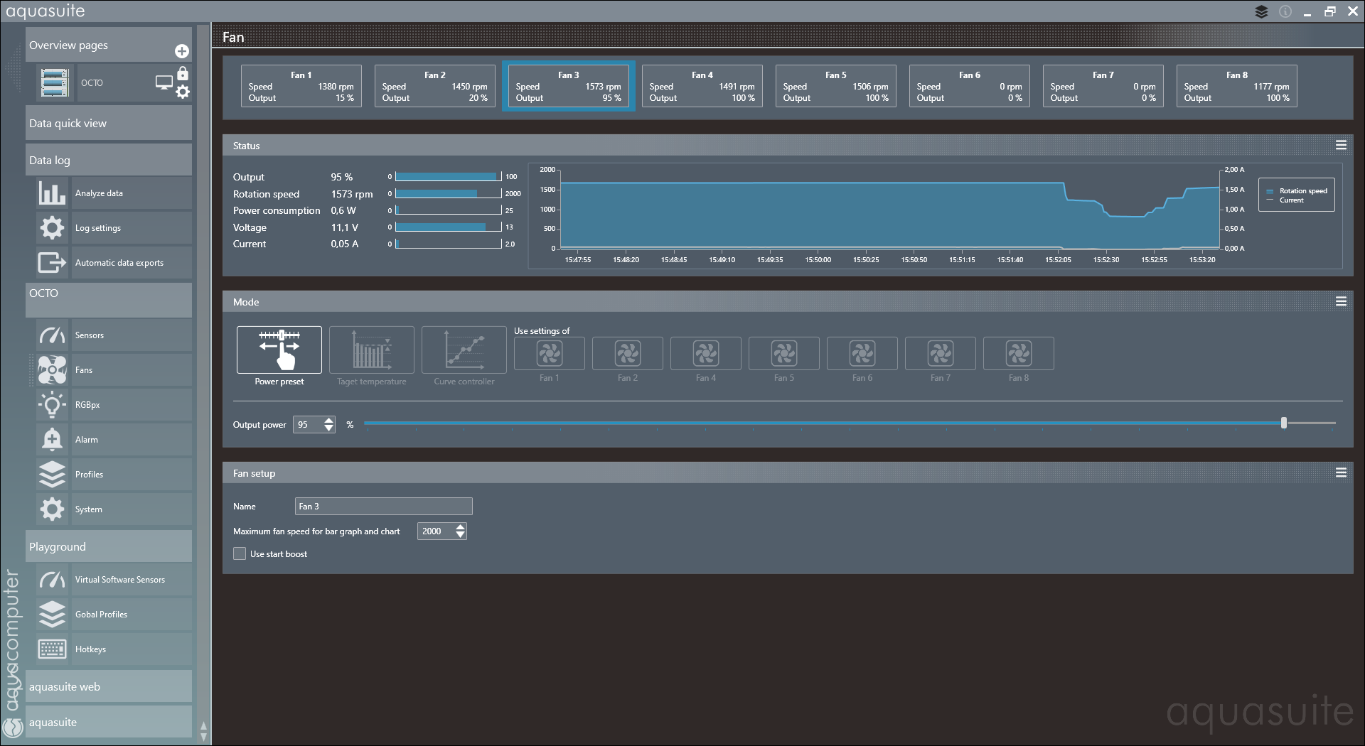

- 8 channel PWM fan control, 100W total power, active switch-off for the channels, current measurement, overcurrent protection

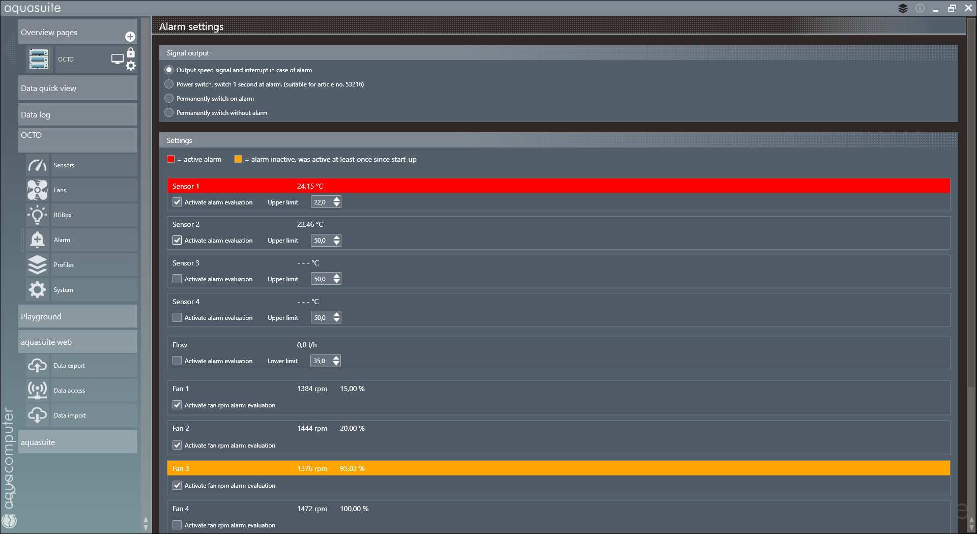

- Signal output for connection to power switch or mainboard, configurable hardware alarms

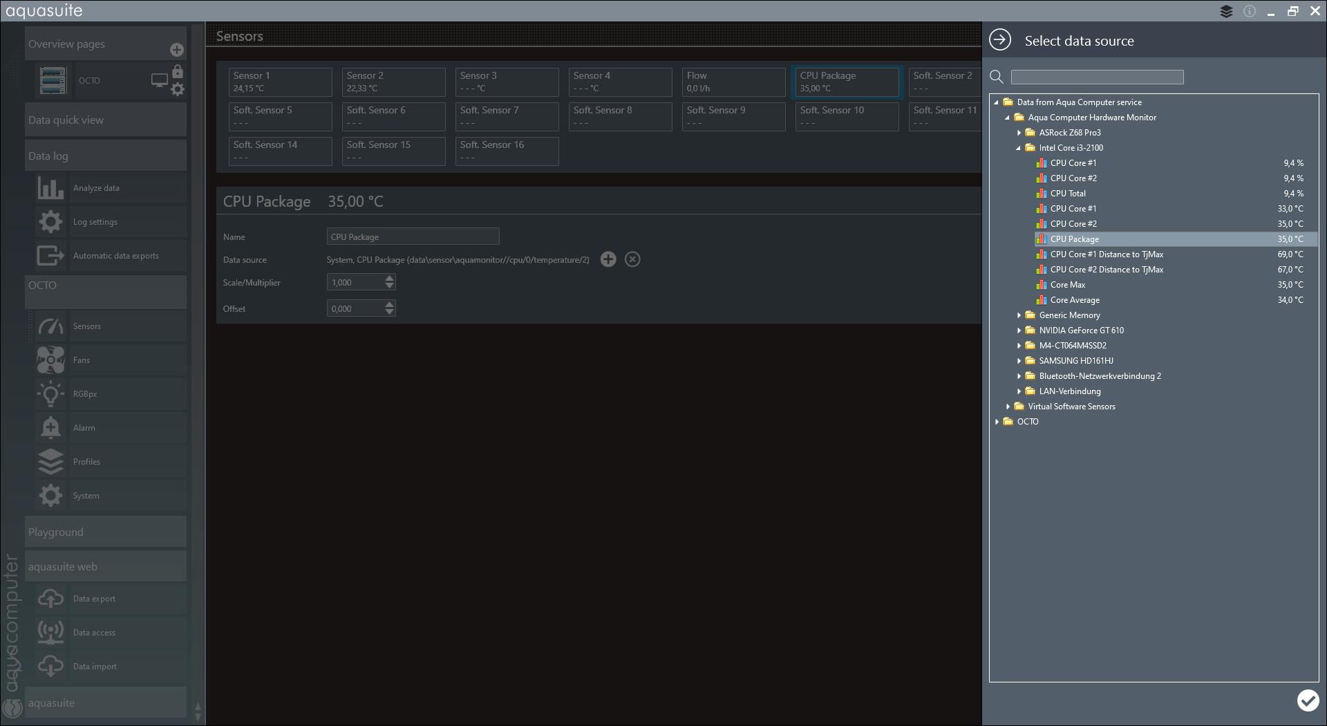

Four analog temperature sensors and one flow sensor can be connected to OCTO. Up to 16 additional sensor values can be transferred from the computer to OCTO in the form of software sensors. For example, it is possible to control outputs according to the CPU or GPU temperature or to visualize the load using LED strips.

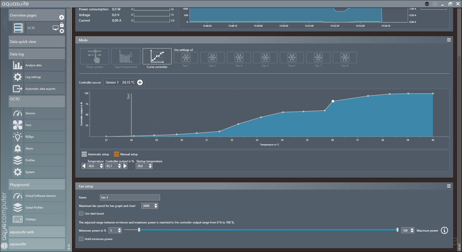

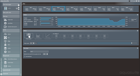

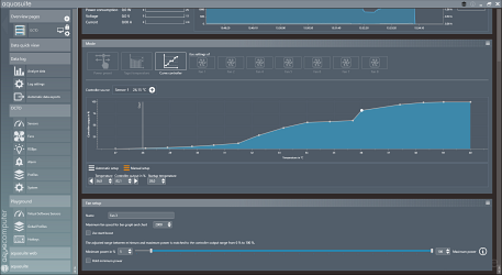

Each fan channel can be configured individually. In addition to the manual setting of the output power, automatic control is also possible. A setpoint controller with temperature setting and a curve controller are available as modes. With the setpoint controller, the desired setpoint value is set and the fan is controlled appropriate. Experienced users can optionally adjust the PID controller settings individually. The curve controller in turn defines a power curve with temperature and power value of the fan via 16 freely adjustable points.

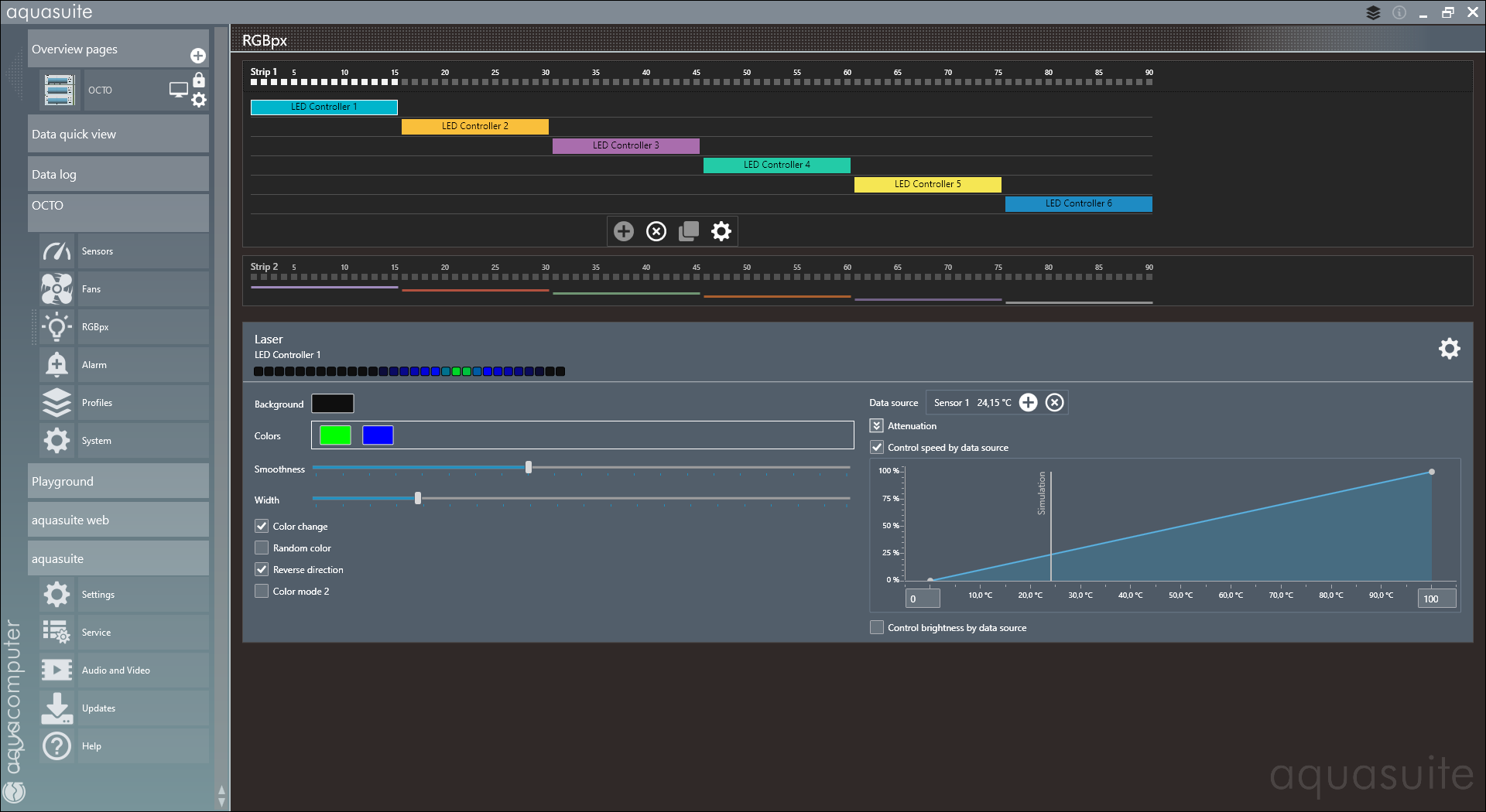

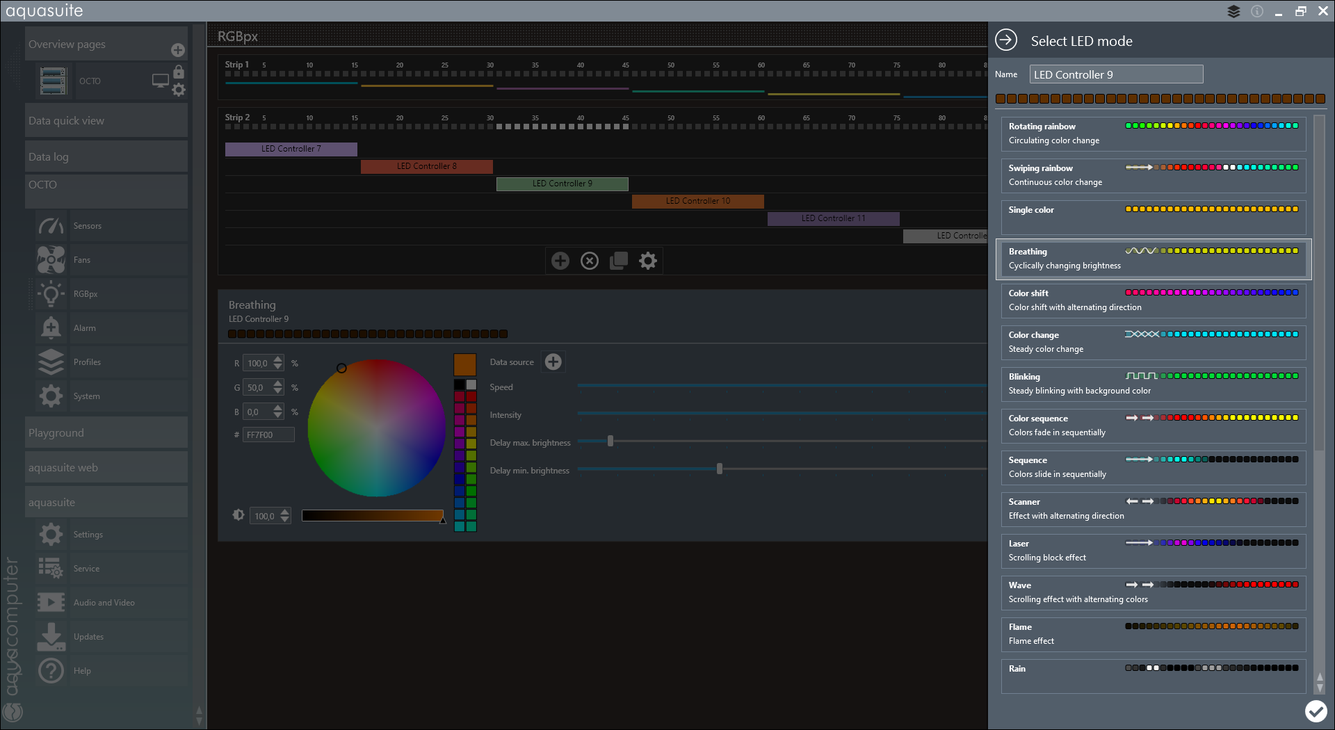

RGBpx
OCTO is equipped with the new RGBpx technology which allows setting each LED to one of 16.8 million possible colors using compatible LED strips or fans.
This allows smooth animations and breathtaking effects as well as the possibility to individually adjust the lighting to your requirements. So the workplace can truly shine in the right light.
OCTO provides two RGBpx connectors for up to 90 LEDs (up to six Aqua Computer RGBpx LED strips) each. Effects can be applied to the LED strips with twelve independent controllers.
Each of the twelve LED controllers provided by OCTO can be assigned to one of 23 effects. All effects offer additional settings. In addition to adjustments for the coloring, stepless controls also allow you to adjust the speed or intensity in a wider range.
Due to the high update rate, even slow transitions are displayed smoothly and without flickering.
Many effects can also be actively influenced by a data source. Thus, effects can be linked to any sensor values such as temperature or load.
Since the effects can be placed anywhere on the LED strips, most of them can also be combined: For example, LEDs 1 to 16 can have a continuous color change while LEDs 6 to 11 have a temperature-dependent color change from blue to red. This results in a temperature display that is flanked at the left and right by a color change effect.
The effects are processed similar to a video editing program. The uppermost LED controller is always visible and may cover the effects of the controller below and so on.

Edit: Can you do curves and all the sensors and curves like you can with the Aquaero or is this just a 'super-sized' QUADRO? I remember hearing the QUADRO was limited to that.
Every Fan Output has a own set of controllers, you can have 8 curve controllers/setpoint or manual controllers.
The same like 2x QUADRO in one.

Does OCTO comes with Quadro-like software or Aquaero-like software already?
Donnerstag, 19. Dezember 2019, 00:55
The aquasuite... it will have a tab in the aquasuite like the aquaero and the quadro, where you will find the controllers and sensor setup, etc.
There are several screen shot in the OP above.
?? what is Quadro-like software or Aquaero-like software
The OCTO use the aquasuite in the same way as all out products. Screenshots are in the first post.

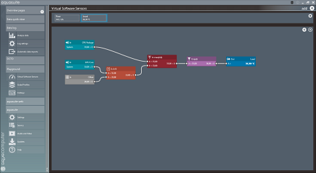

With Quadro you cant create virtual sensors (if i want to control fans with 3 temperatures at once for example)
With the playground in the aquasuite X you can build your own virtual sensors like this:
https://forum.aquacomputer.de/images-ac/…_octo_09_en.png
and forward the sensors to the octo, this is working with all devices that support software sensors. (QUADRO, farbwerk, aquaero, ....)
