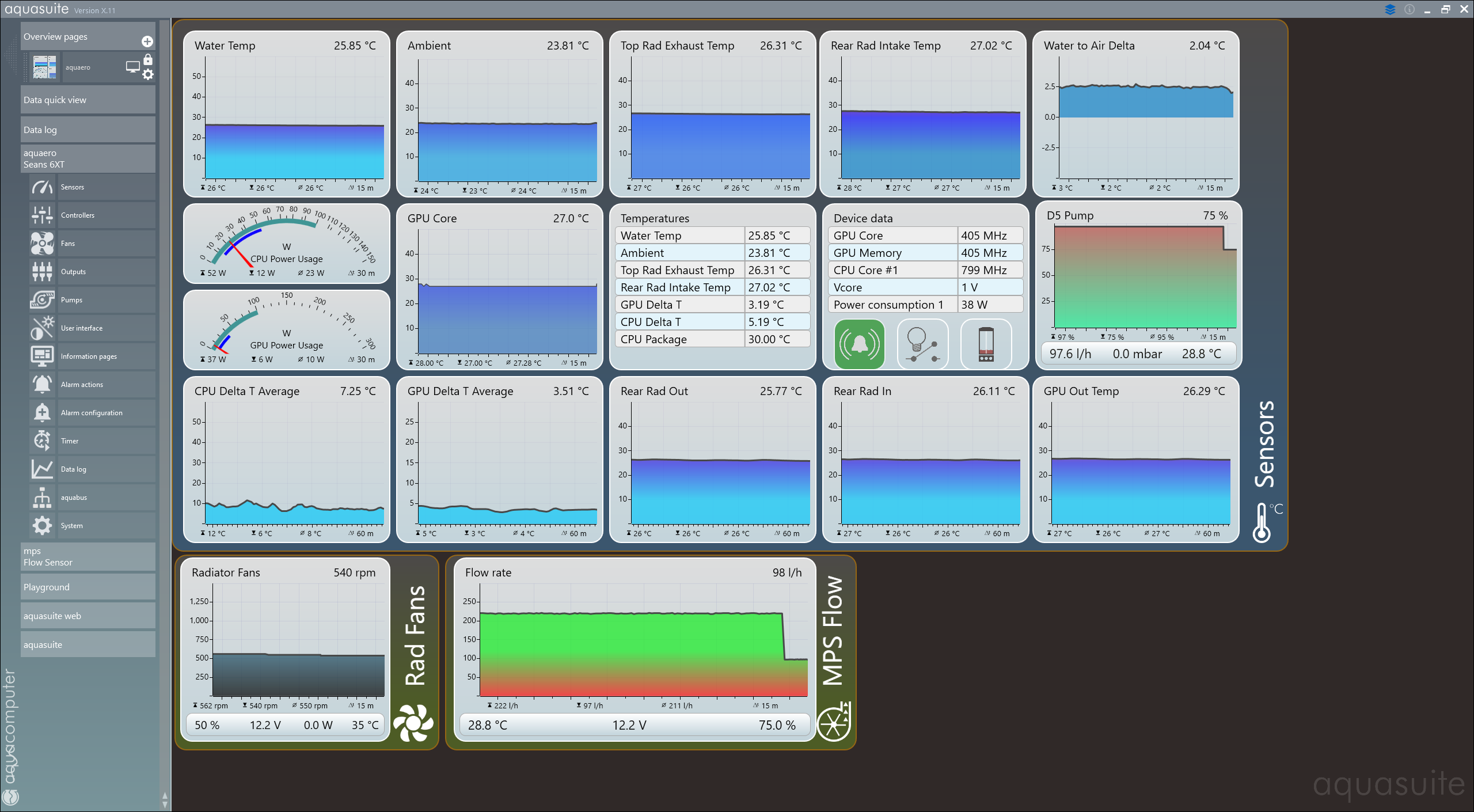

Here you can see in my screenshot just how steady the High Flow meter is vs the MPS 400
First screenshot is the MPS 400 with a pump speed of 75%
Second screenshot is the High Flow USB with a pump speed of 75%
Big difference in the flow readings without having a properly calibrated MPS400 plus the high flow sensor is just more steady.
