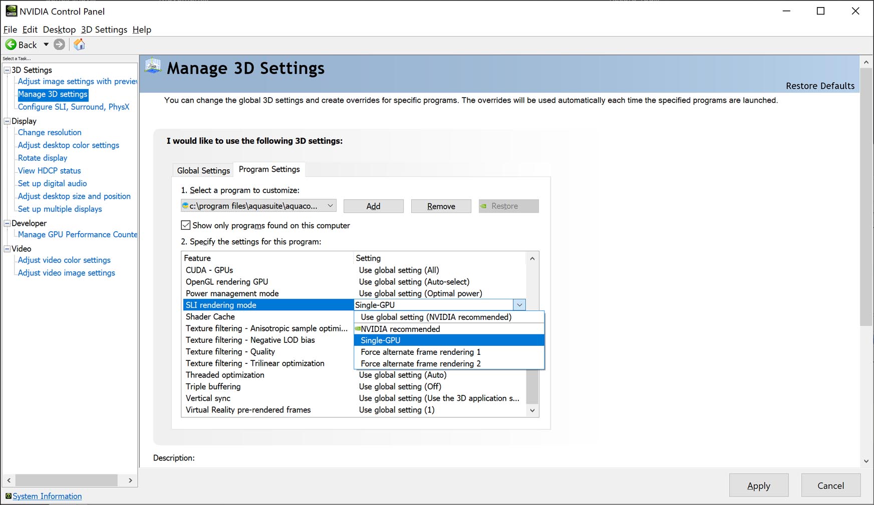

Samstag, 18. Januar 2020, 13:50
FYI I have gone to nVidia Control Panel and set Aquasuite.exe to not use SLI. Crashes stopped happening.
So if you have the same issue I do and have SLI in your machine, this is the solution.

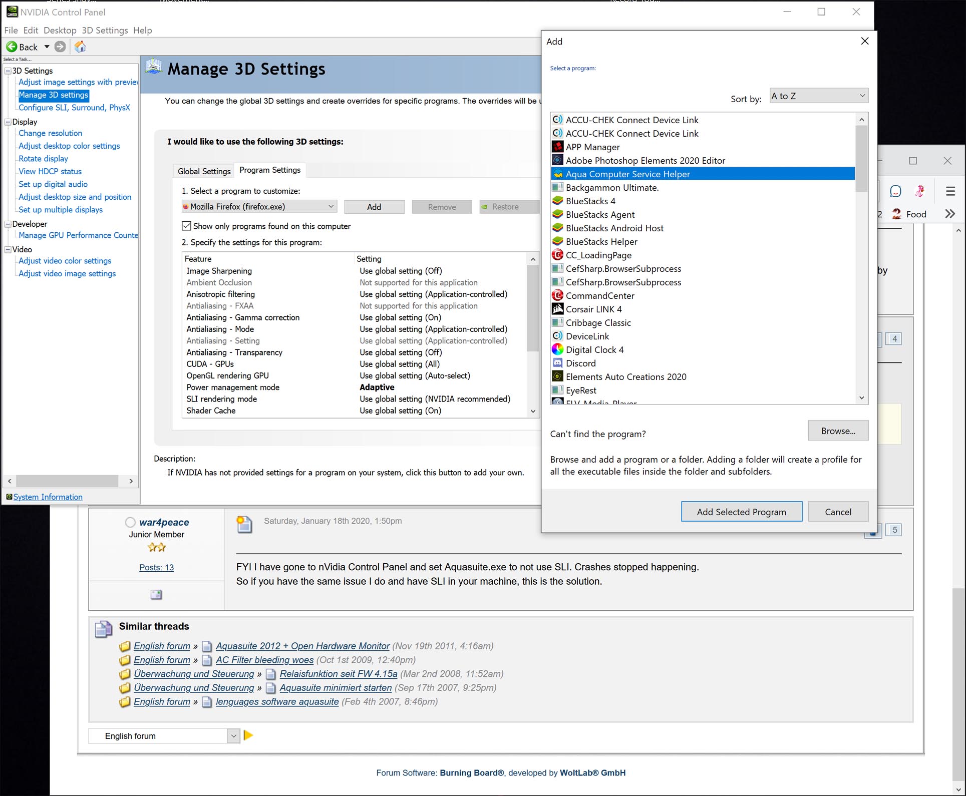

I have been having a similar issue and tried following your suggestion.
I went to the NVIDIA Control Panel and performed the actions as documented in the clips below, but did not find Aquasuite.exe in the available programs list.
Did you mean "Aqua Computer Service Helper"? And if so, is this the process you commented on?

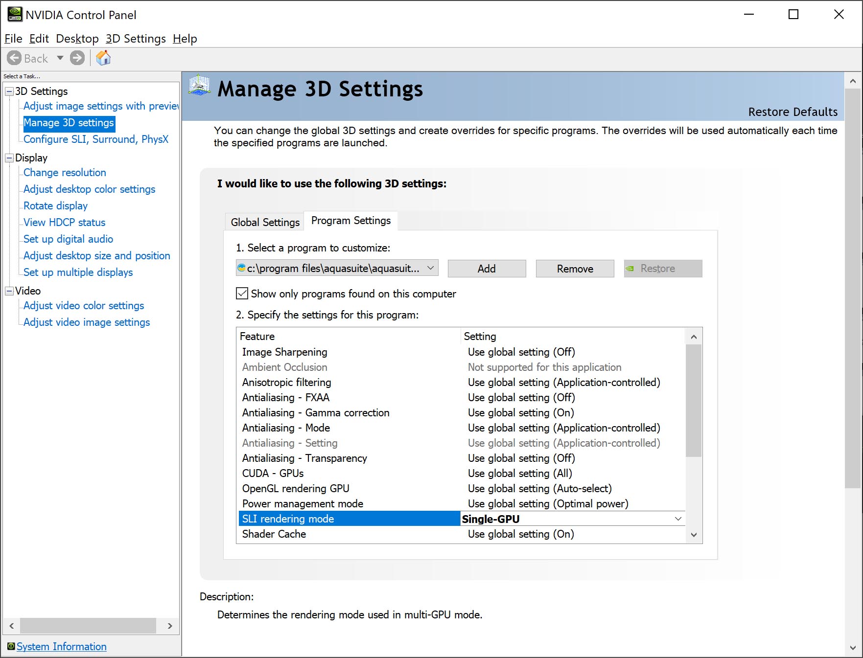

war4peace
Montag, 20. Januar 2020, 14:36
The second picture with the settings is correct, the first is not. You might need to click on Add... and then browse for the executable, go to C:\program files\aquasuite\aquasuite.exe and add it manually.
AFAIK the Service helper doesn't use GPU 3D capabilities and I didn't manually configure it.
