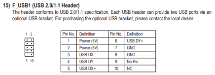

I've tried the second header (pins 1,3,5,7) available on my motherboard with the same result as with the initial connection (pins 2,4,6,8). I confirm that both times, the red side of the Quadro connector was aligned with the +5V on the motherboard. I've attached the info from my MB manual of the USB header I'm using (F_USB1 (USB 2.0/1.1 Header).
After a failed attempt at firmware upgrade, the device is no more accessible (appears as disconnected in aquasuite). What is the fastest way to make it available again for an upgrade? Shutting down the computer for 10 minutes does not appear sufficient (overnight was).
