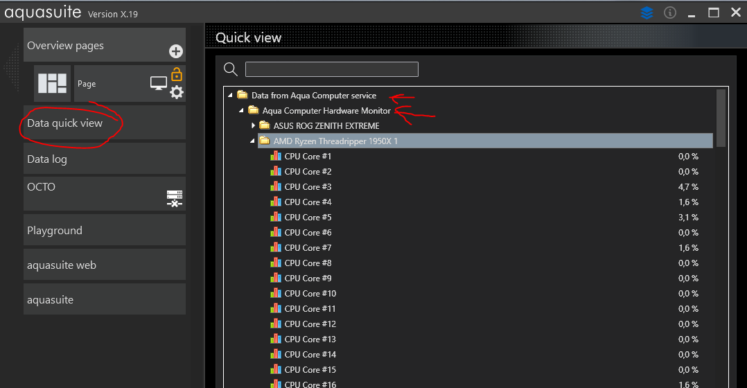

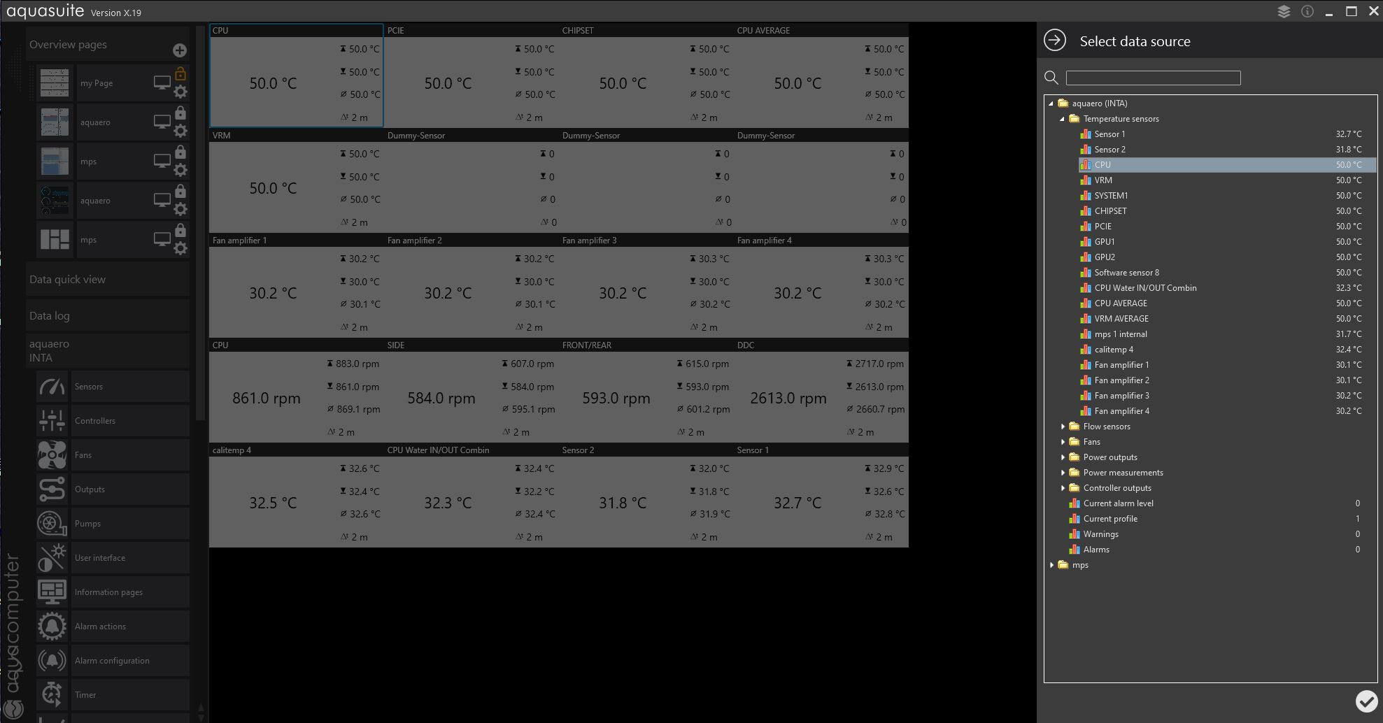

Undermoose
Sensor Pics
Mittwoch, 27. Mai 2020, 01:16
So I found something interesting regarding the sensors.
The attachments in this reply:
Pic1 shows software sensor for CPU which I changed the data source.
Pic2 shows drilling down the Aqua Computer Hardware monitor to the Gigabyte motherboard's ITE IT8688E and seeing just 5 Temperature options.
Pic3 shows Data Quick view drilling down to Aqua Computer Hardware monitor, again the motherboard's ITE IT8688E, but now seeing a big list.
Why do they show a different list to select from?
»Undermoose« hat folgende Dateien angehängt:
  • aquaero-stuck2.jpg (67,3 kB - 276 mal heruntergeladen - zuletzt: 25. Januar 2026, 05:51)
  • aquaero-stuck3.jpg (96,77 kB - 267 mal heruntergeladen - zuletzt: 21. Januar 2026, 14:20)
  • aquaero-stuck4.jpg (88,48 kB - 247 mal heruntergeladen - zuletzt: 21. Januar 2026, 14:19)
RE: Sensor Pics
Mittwoch, 27. Mai 2020, 13:45
Pic3, the 'big list', shows only 5 temperature sensors, the additional items are RPM & Volt.
Pic2, for virtual TEMPERATURE selection, displays ONLY the temperature subset (5 items) from the 'big list'
