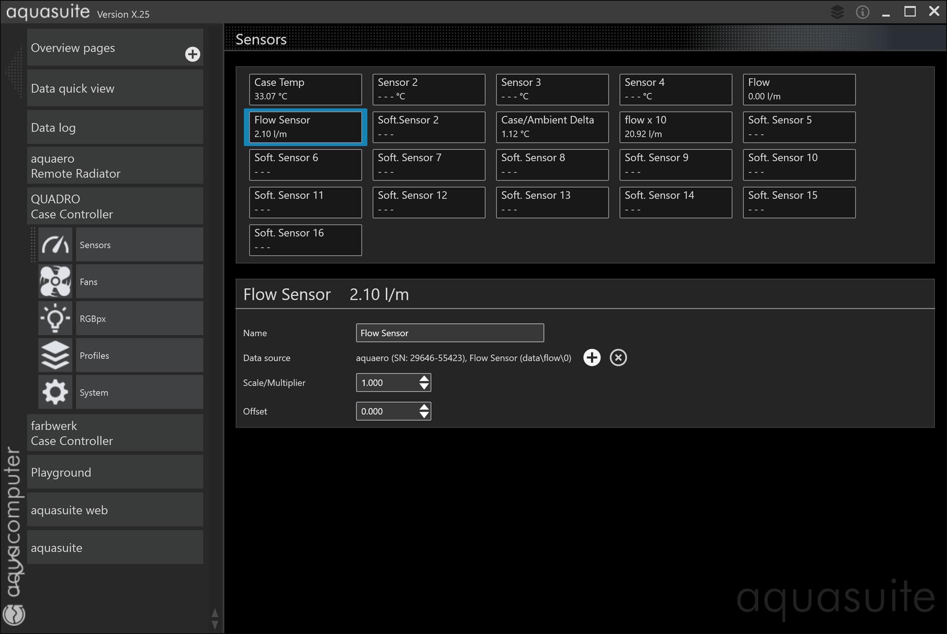

You need to import the High Flow USB flow sensor data into one of the Soft.Sensors under the octo sensors tab, then it will be available to use with the octo.
The attached screenshot is from a quadro, but the octo is the same. flowsensor.jpg
