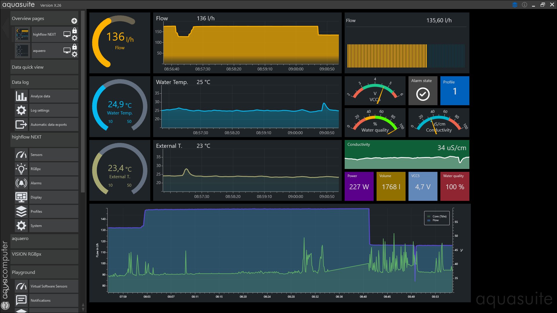

Coolant quality - good to know
Again and again we have been asked: When should I change my coolant? How do I recognize corrosion in the circuit?
Now the high flow NEXT provides the answer! We have integrated a very precise measuring system for the electrical conductivity of the coolant. This is capable to measure the conductivity between 2-200 µS and determine the quality of the coolant. If corrosion occurs or if the corrosion protection inhibitors are used up, the conductivity of the coolant increases significantly. This is detected by the sensor and corrosion and biological attack can be prevented by changing the coolant.

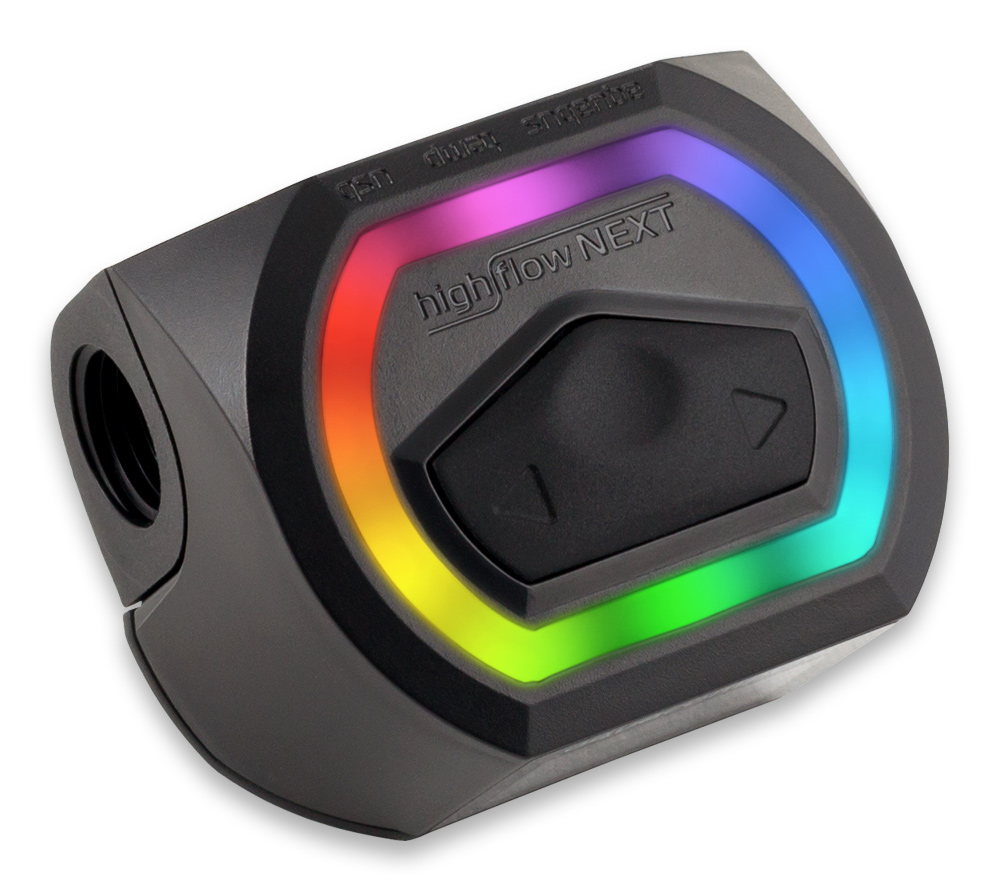

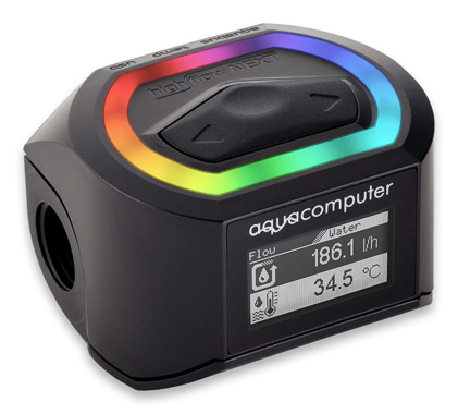

The electronics of the high flow NEXT is an absolute masterpiece. The dimensions of the high flow NEXT are much smaller than the well-known high flow while it has a highly sophisticated electronics with display, alarm buzzer and a complete RGBpx interface including AMBIENTpx support! The connection to the PC is made via the USB interface; this also supplies the required power.

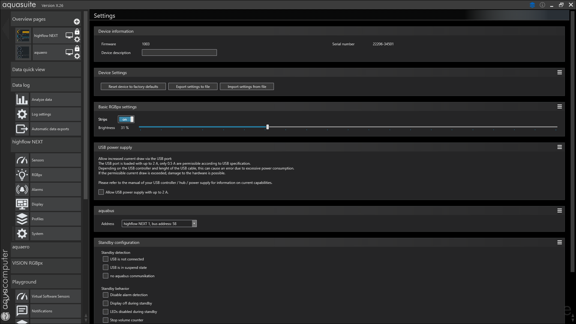

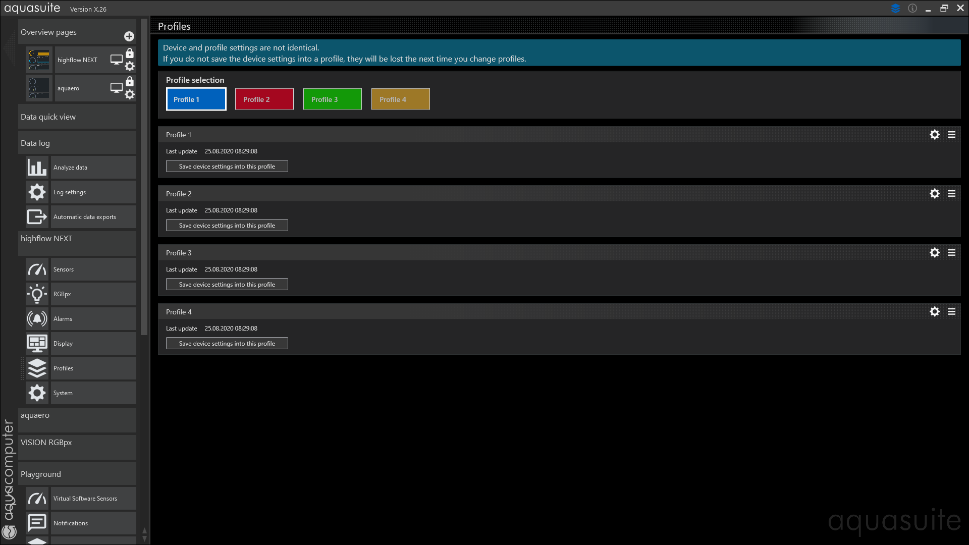

Three buttons allow a simple and direct configuration of the sensor within the menu. The graphical display can show all measured values from the sensor either as a graph or in a value format. All display pages are freely user-selectable and can be changed automatically.
To provide a visual flow control the sensor has 10 RGBpx LEDs integrated directly in the housing. In their default configuration they provide a rotating flow indicator which changes the speed depending on the flow rate. The effects can be configured freely and of course depending on sensor values using the aquasuite.
The signal output of the high flow NEXT is able to simulate the signals of the popular high flow sensor or to output a speed signal for mainboards (100 l/h correspond to 1000 RPM).
Using the aquabus interface, the data of the high flow NEXT is forwarded to the aquaero and is available for further processing. The aquabus interface can also be used for power supply, but in this case the RGBpx functionality is not available.

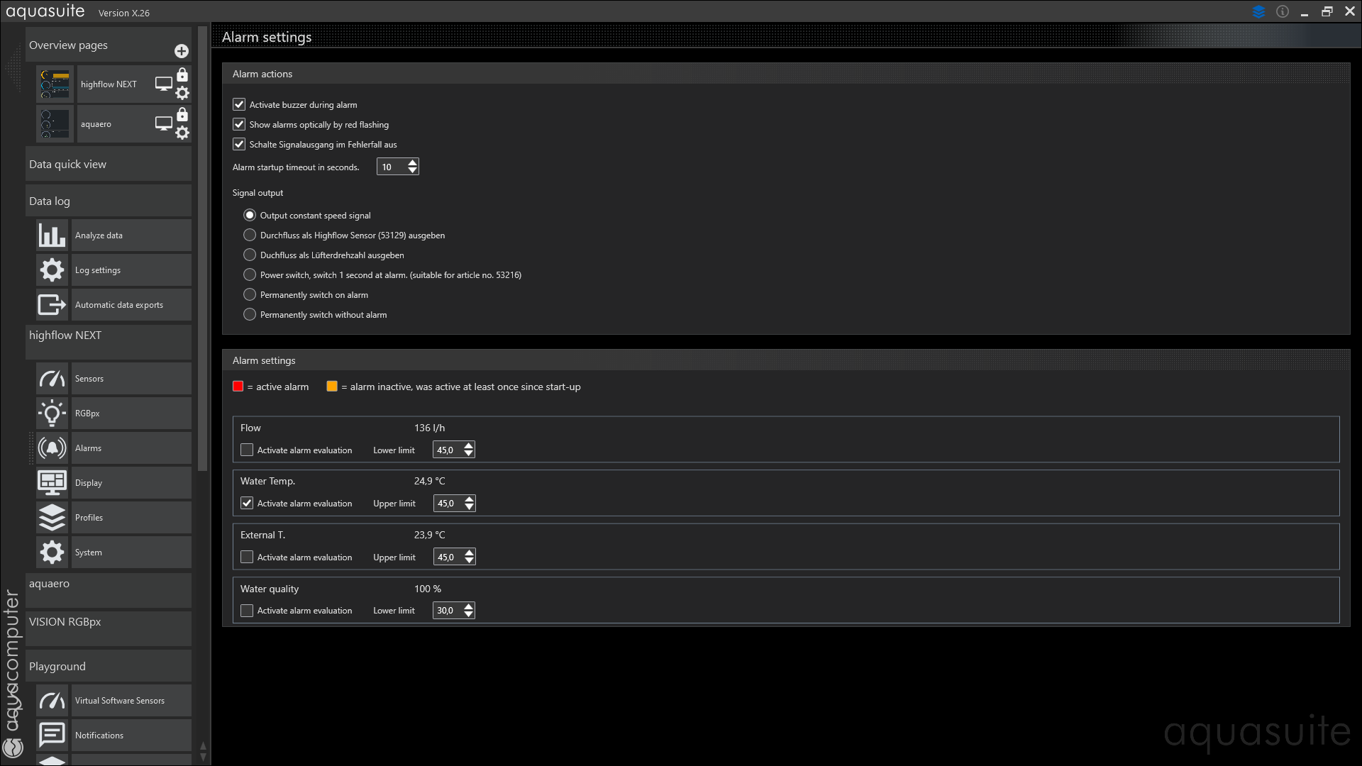

On alarm - the direct link

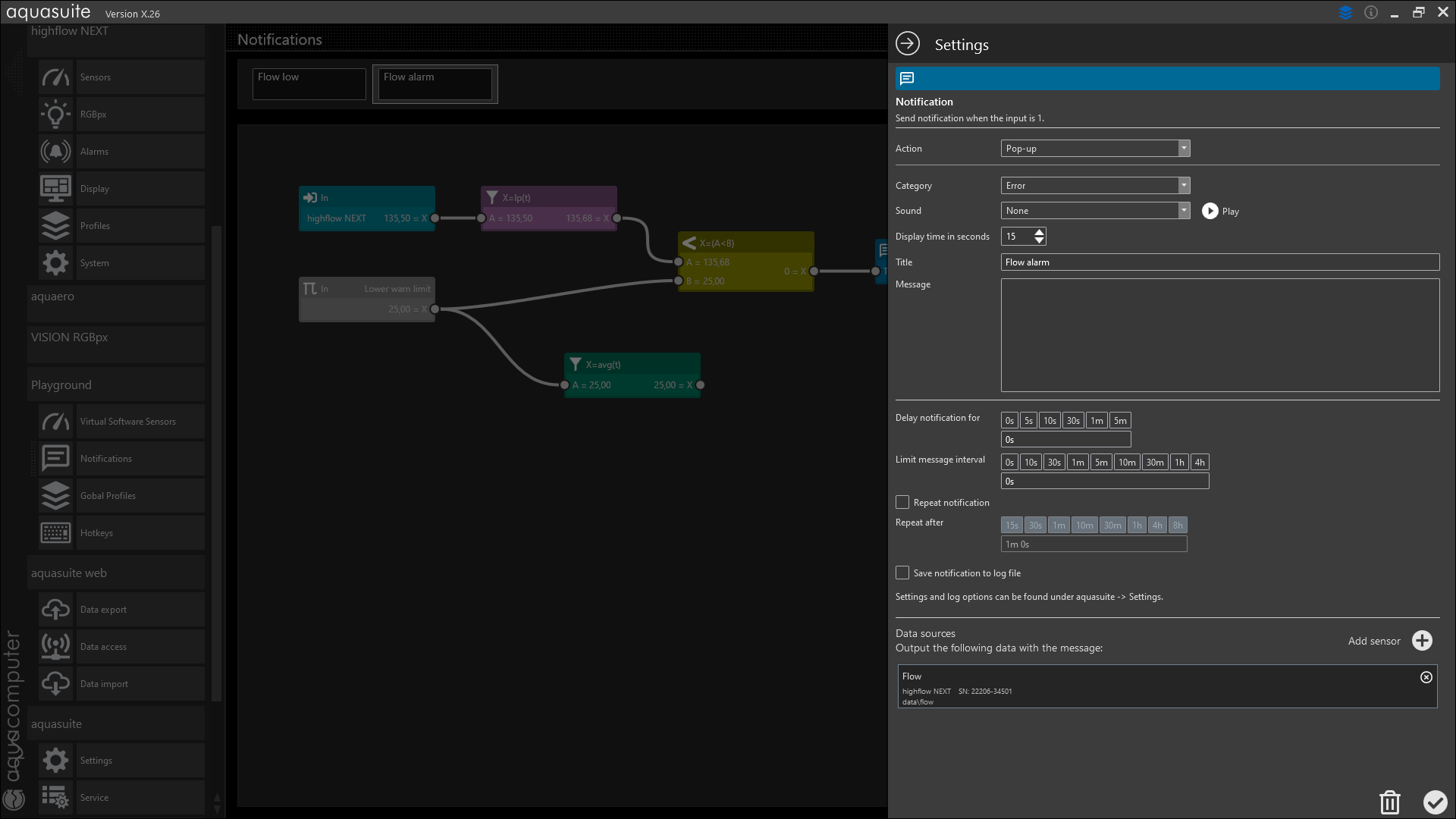

All sensors values can be monitored with alarm limits using the high flow NEXT. If an alarm occurs, it can be indicated both acoustically via the integrated buzzer and optically using the LEDs. In addition, the computer can be switched off using the signal interface of the high flow NEXT connected to the power button input at the mainboard. Alternatively, the alarms can be further processed in the aquasuite Playground section.

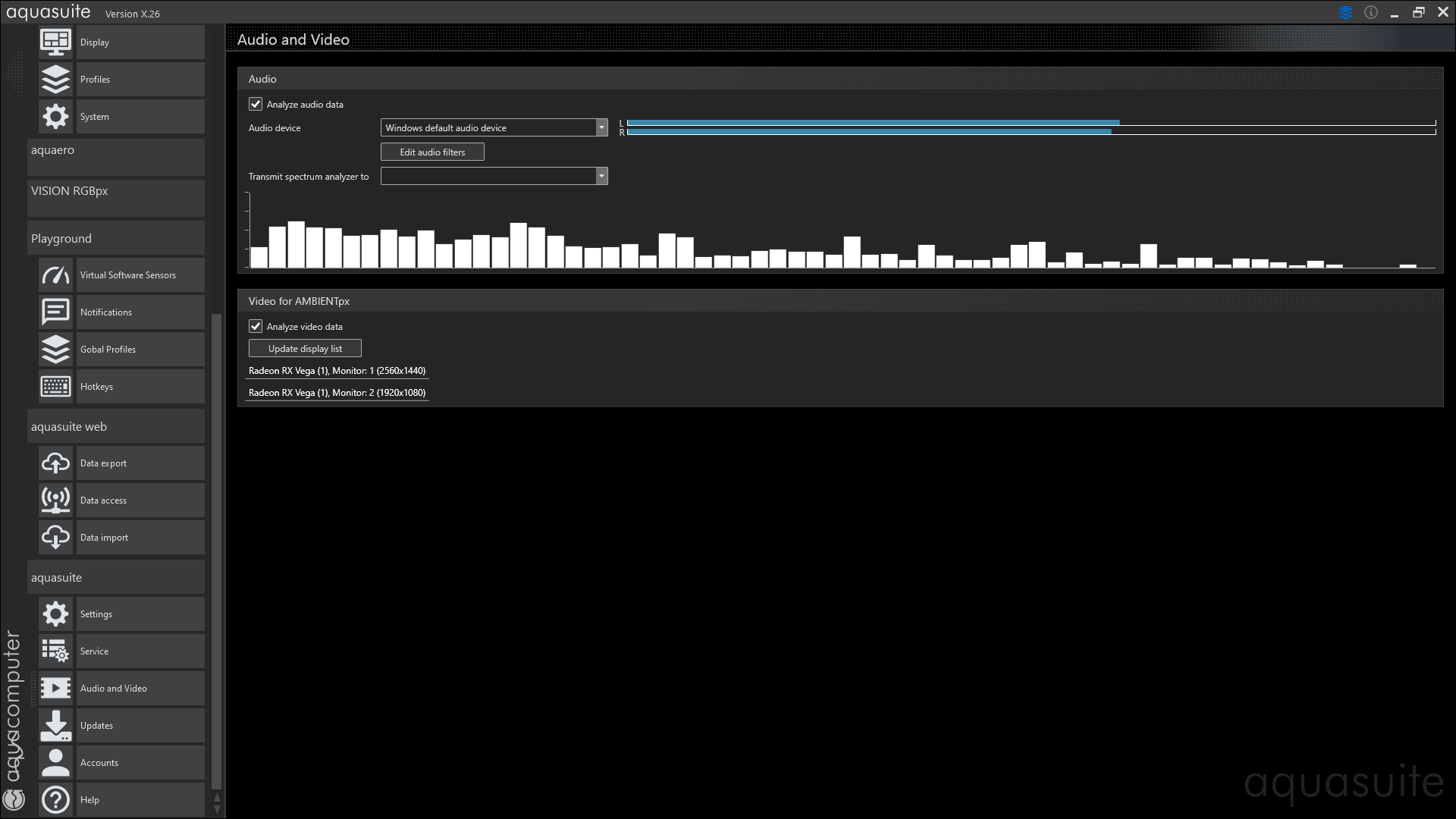

The high flow NEXT supports RGBpx and is able to control up to 90 connected LEDs. All known effects including the dynamic backlight for monitors (AMBIENTpx) are provided.

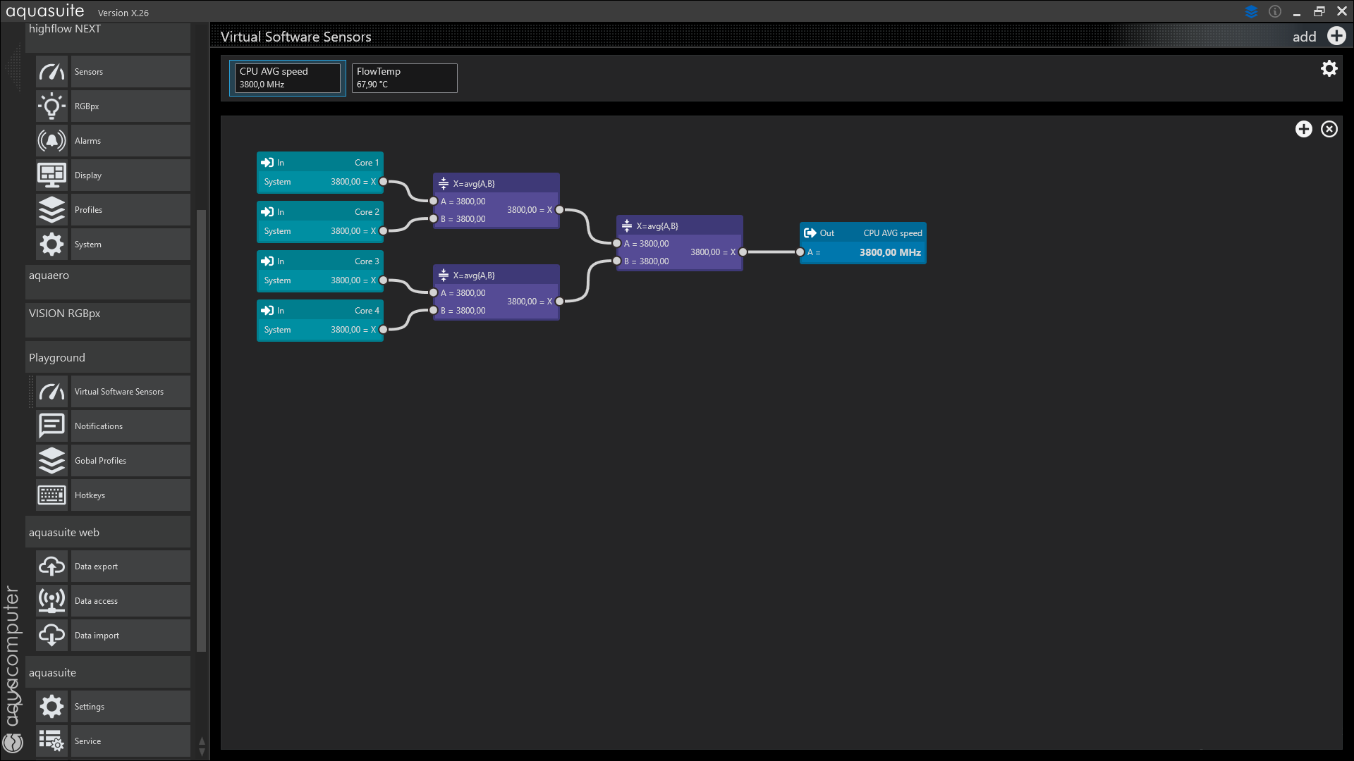

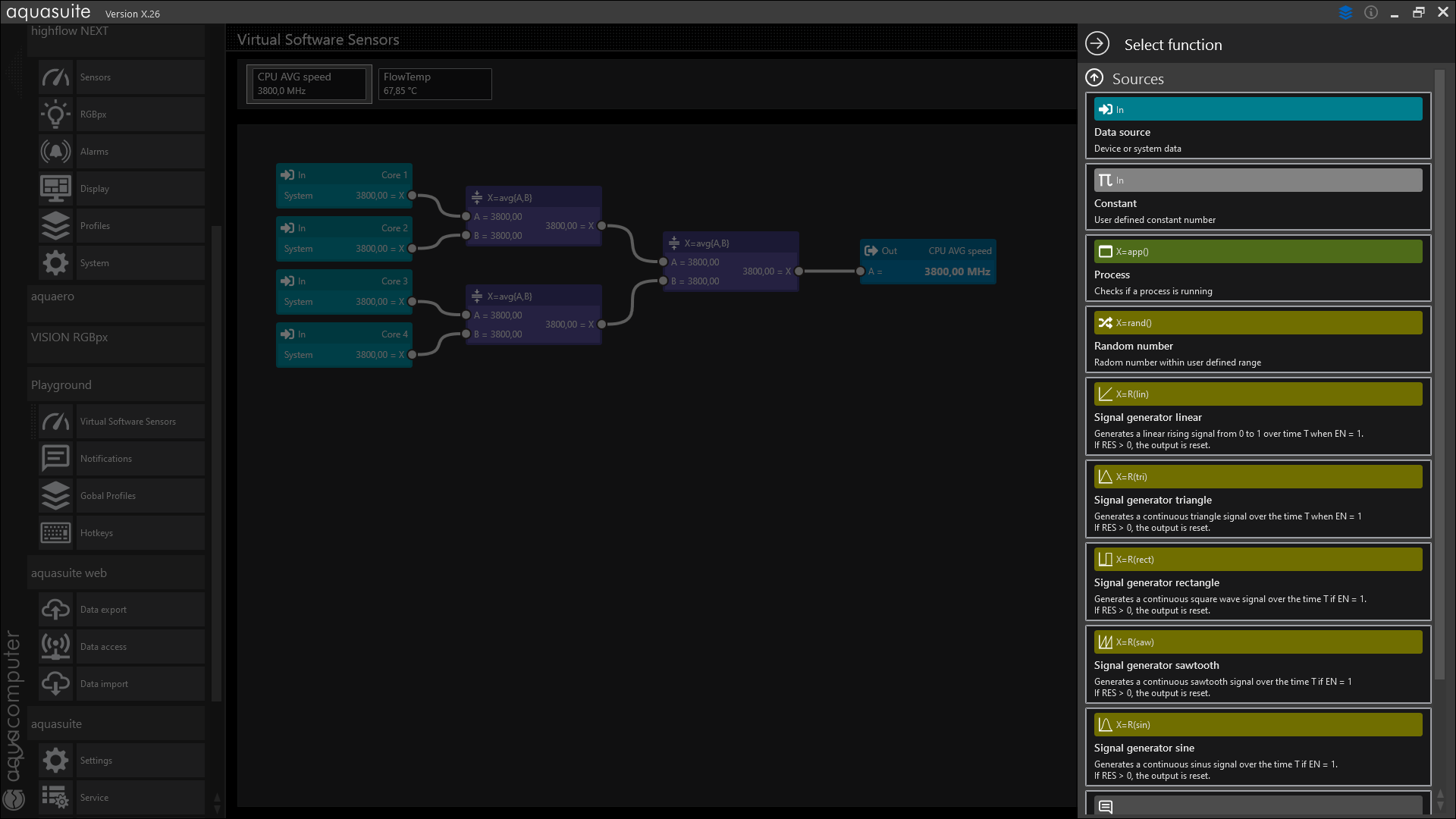

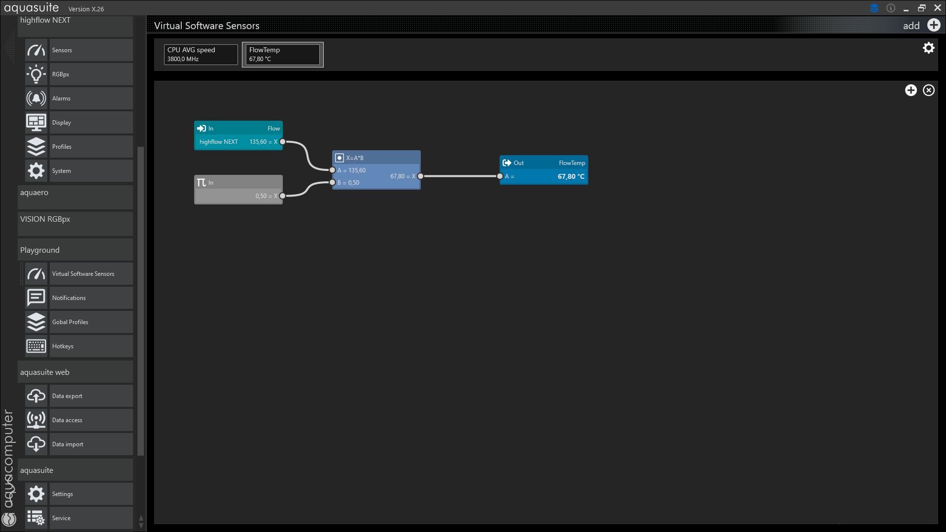

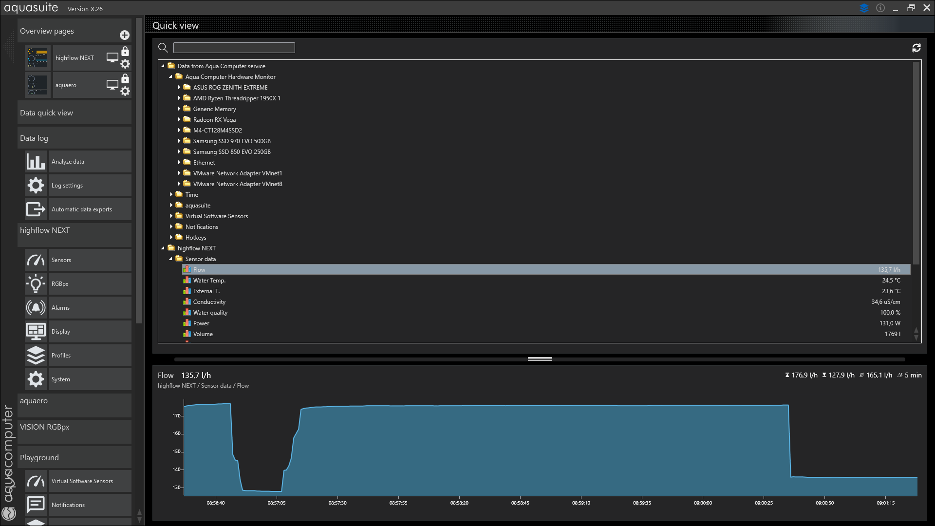

The high flow NEXT also provides the option to use up to eight software sensors. These sensors can be provided by the PC via USB to get actual measured values. The data from all Aqua Computer devices and the hardware monitoring are available as data sources.
The aquasuite software - nothing more is possible
The high flow NEXT is topped by the well-known aquasuite software and our promise: More is not possible.
No other manufacturer can provide you with a software package that offers this functionality, adaptability and depth. We will continue investing a lot of time in the aquasuite software to improve it continuously.
Completely customizable overview pages, desktop overlays, hardware monitoring, web interfaces, a playground with virtual sensors that are simply created in a graphical way and complex modules like e-mail notifications in case of alarms etc. Almost every task can be solved by the aquasuite.

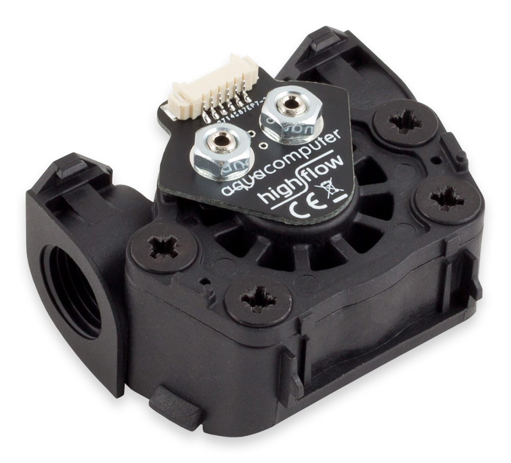

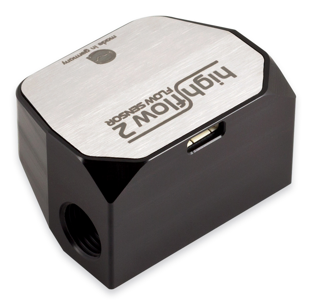

high flow 2 - The new generation with water temperature measurement
You simply need an ultra-rugged flow sensor? Water temperature measurement would be a nice addition? All this in a simple and elegant way, CNC milled from solid acetal? Then the high flow 2 is exactly the right choice.
The high flow 2 has much more compact dimensions than its predecessor. In the beautifully designed housing made of acetal, the very precise and fast water temperature sensor is integrated next to the flow sensor. The stainless steel cover of the sensor is fixed by magnets and can be easily opened with a strong magnet.
The signal of both sensors is output via a shared connector. Unlike its predecessor, a connecting cable is now included in the package. This cable is designed as a universal connector and has the required plugs for all devices offered by us. The sensor has three M3 mounting holes on the bottom side.
The high flow 2 is offered at a price of 49,90 Euro

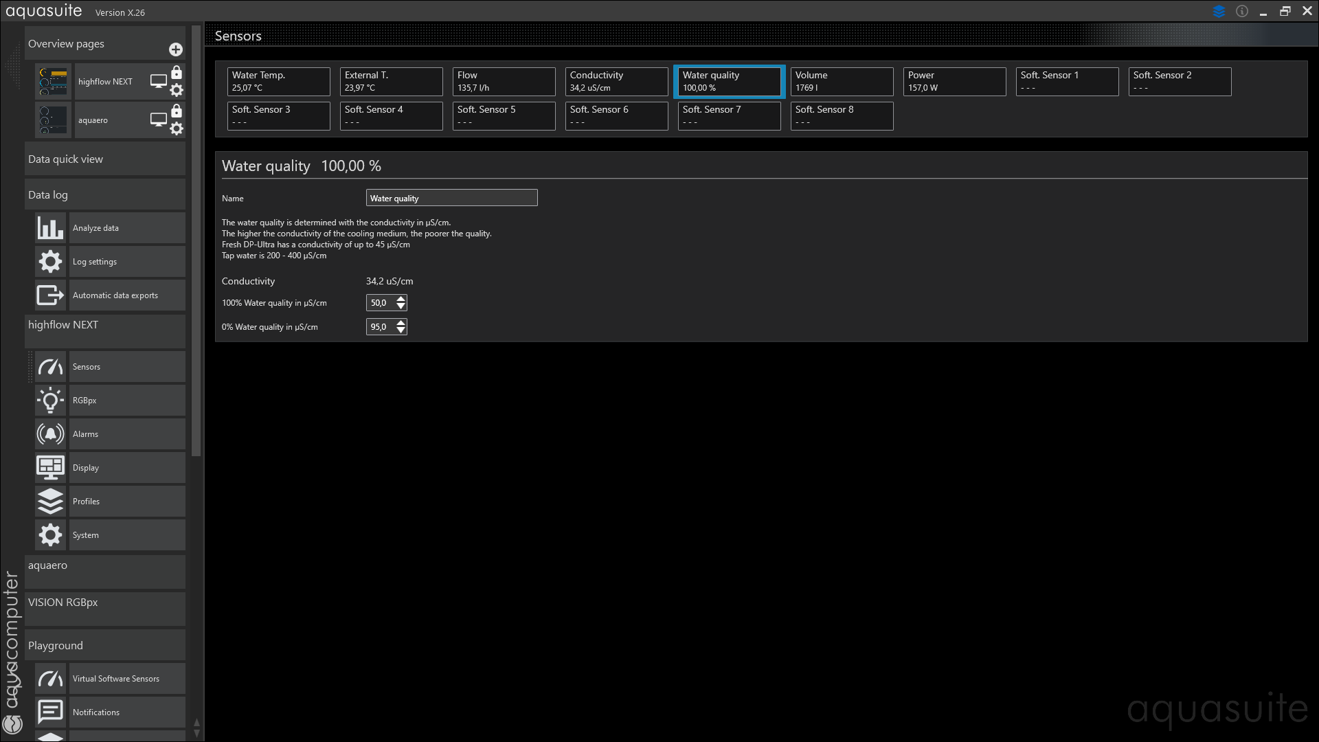

I had a basic concept of the water quality measurement, but went looking for a bit better understanding. THIS CLIP was helpful.
Now to get one.

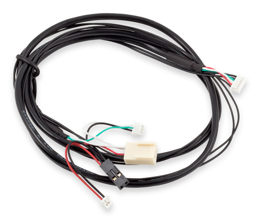

Will both of these units work with the quadro or octo and its flow input? I cant fit the Aquaero in my case, unfortunately.
high flow 2 and LT can be connected to QUADRO or OCTO with the supplied cable. To connect the high flow NEXT you will need a PicoBlade to PicoBlade connection cable (not available yet) for its signal output. This output can be set to simulate a classic high flow sensor.
