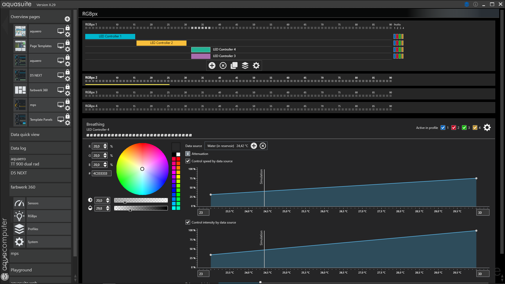

k2viper
Montag, 23. November 2020, 16:24
You dont have to connect each fan group to a different farbwerk/octo channel. Two or more groups of fans also may be daisychained to one channel until you're below 90leds/channel limit.
Any LED controller in software controls its own effect and is assigned to its own group of leds, or even more then one effect to the same led group. On my RGBpx 1 you can see three led controllers as it's 3 different led strips daisychained.
Thats how it will look like.

k2viper
Montag, 23. November 2020, 16:52
No, not automatically. Software doesnt detect which led belong to which device. You manually assign every LED controller to every led or group of leds, basing on led number from 1 to 90.
The same rgbpx port doesnt ensure all its effects will be synced. It depends on LED controllers (effects) used and number of leds involved.
But, aquasuite is flexible enough. I believe you will be able to create many pretty interesting effects with it.

kensaundm31
Montag, 23. November 2020, 20:39
thats really helpful its not obvious that you create "groups" by defining how many leds are in each device, thanks
