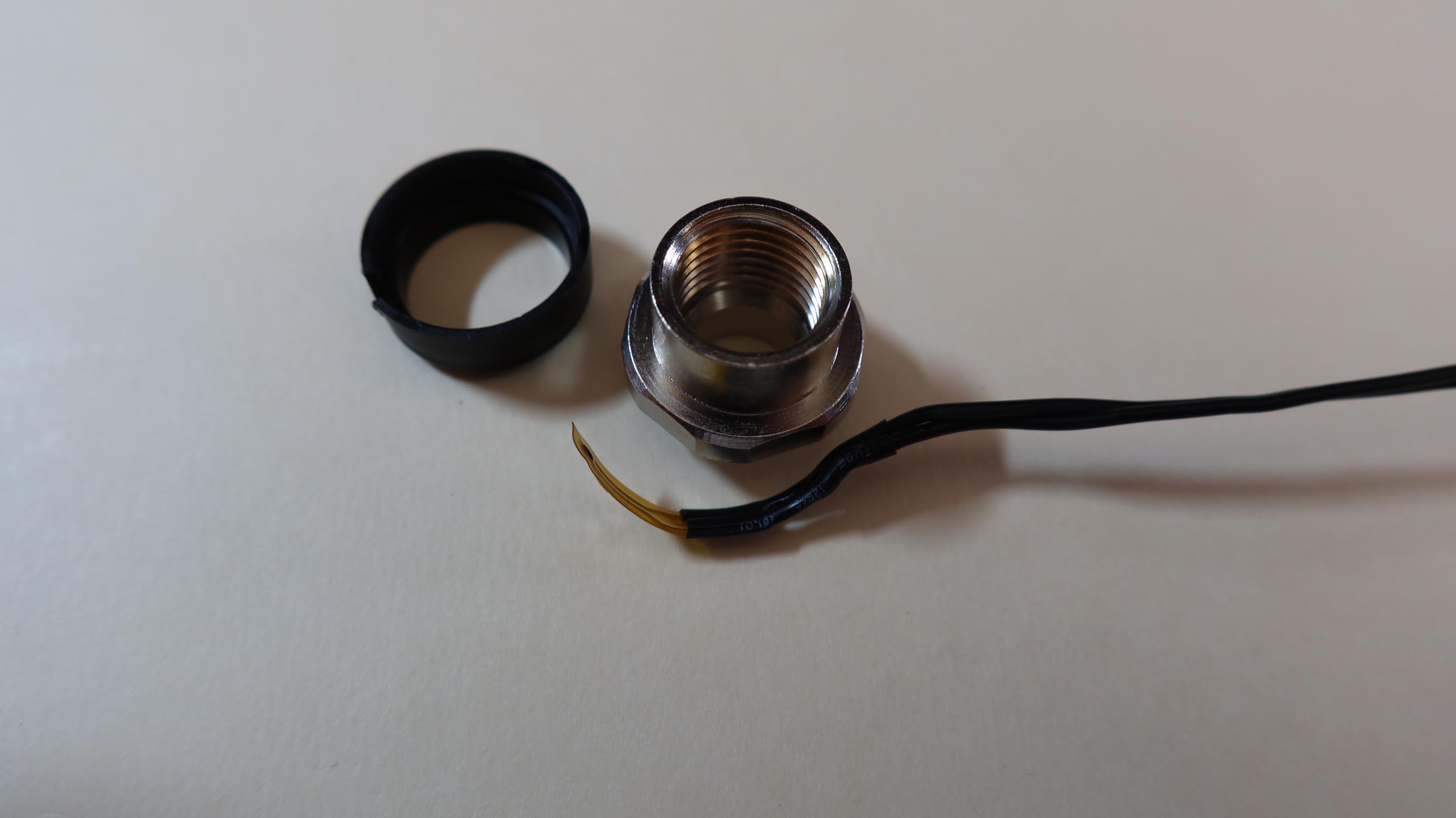

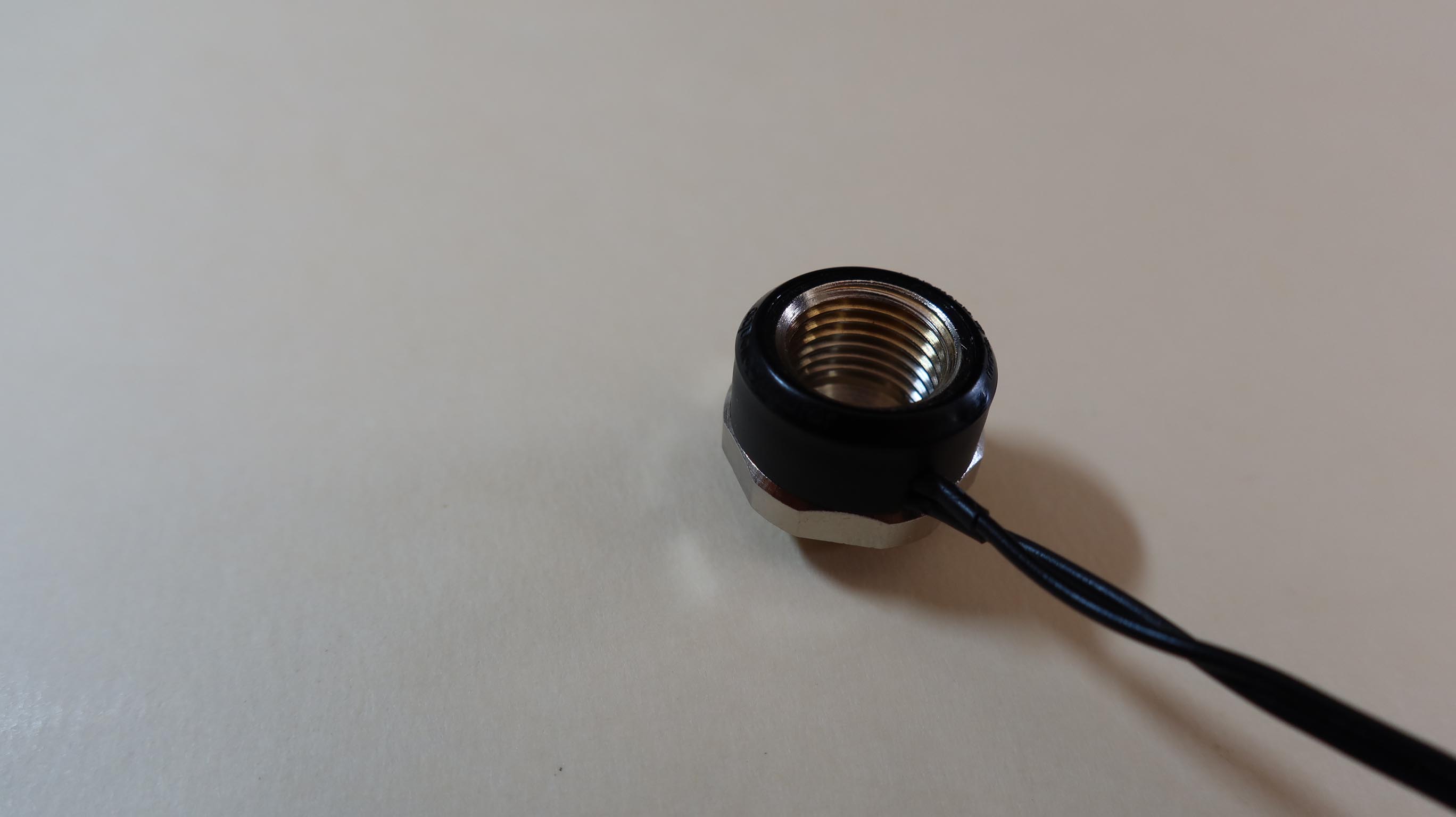

You can get 99% reliable water temp reading by taping the the flat type thermistor onto radiator end tank. You can calibrate the reading using something like digital fever meter and aquasuite temp sensor offset.
Dienstag, 1. Dezember 2020, 19:14
This is essentially what aquacomputer do for the Temperature sensor internal/external thread G1/4
Kuminauha
Dienstag, 1. Dezember 2020, 20:11
Wouldn't be surprised if every single one of "proper" sensors are made exactly the same way.
