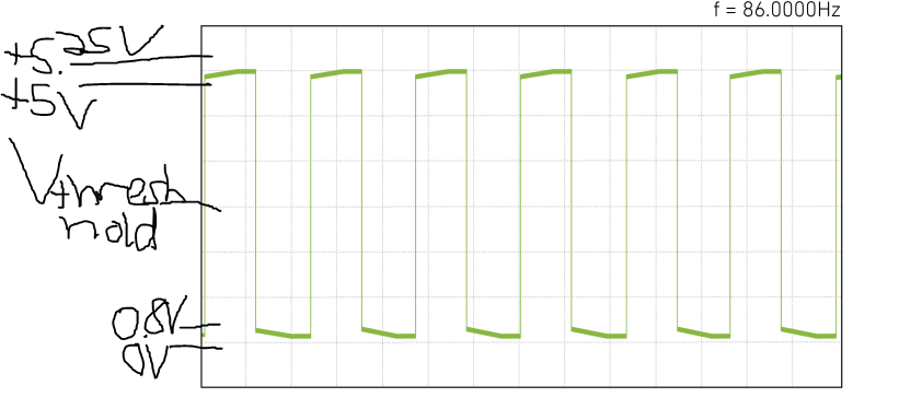

I went with my own +5V just because I am familar with the hardware I was using and I like to use things I built myself previously to troubleshoot electrical problems. You could probably use the +5V rail as long as it doesn't exceed +5.25V but I have no idea what Noctua's actual limit is. I seemed to be able to apply a tightly regulated +5.0xV voltage and it seemed to be fine but I only ran it for like 5 minutes.
What the +5.25V max is referring to is the max voltage. The 0.8V just means that 0V- 0.8V range is just giving you the low threshold range (the low point range of the PWM signal). I have no idea what the threshold voltage for Noctua's fans are (the point at which the low becomes high or 0 becomes 1) but I assume that if they followed the intel spec and 3.3V is fine for a logic high, then the voltage threshold is somewhere around 2.4V-2.6V.
I attached a crappy picture again to try to illustrate what I am saying
