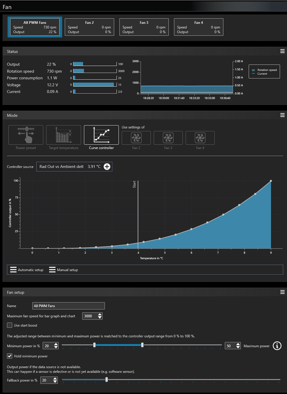

Tuning procedure:
Find high limit for the pump (if noisy), max speed while noise level is acceptable. (in my case 60% is fast enough and quite enough).
Find the low and high limits of your rad fans.
Low limit is when the fan will not spin any more, so just above that (in my case 20%).
High limit is like with the pump, the highest speed possible while maintaining low level noise (in my case 50%) and while able the keep DeltaT<=MaxDeltaT* (less or equal max ambient vs rad out delta)
Configure a virtual sensor that gives the difference between the ambient temp and the rad out temp - Delta T
Now you need to find the Maximum Delta T you allow for your system.
You can start by setting the fans to 100% and running a typical game load, this will give you the lowest achievable DeltaT by your system.
Now try settings the fans at the high limit you have found and run a typical game load, this will let you know if the fans high limit is enough for stable operation.
You should aim for the lowest possible DeltaT.
Desired lowest Max Delta T will give:
Acceptable noise level - rad fans speed lower then the high limit.
Stable system - at max OC.

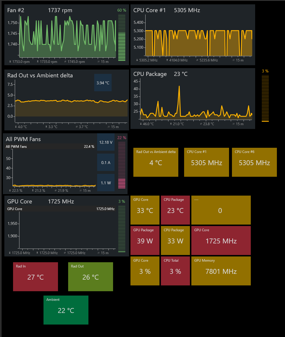

My system:
CPU: 10600KF @ 5.3GHz
3070 on air, waiting for the water block, it will be interesting to see how it will impact the tune, used to run 7700K @ 5ghz + 2070S on the same water loop - same tune.
EK-QuantumX Delta TEC
420mm Radiator
6x140mm Fans
Pump @ 60%
Fans low limit 20%
Fans high limit 50%
Ambient 22C
Idle:
DeltaT 3-4C
Fans @ ~20%
Games Load:
DeltaT ~8C
Fans @30-40%
Noise level: Super quite :) - almost no noise at all, 60cm~ away from the rad fans.

»Elior77« hat folgende Bilder angehängt:
