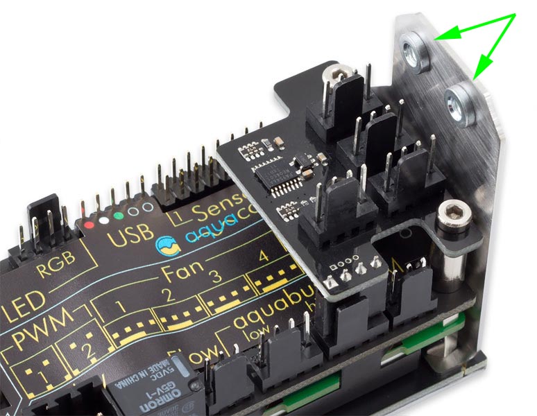

Donnerstag, 4. März 2021, 04:18
To mount/use the aquabus X4 on the aquaero you should request the 'short' screw mounts for the aquaero... I believe support can either supply them or advise what to purchase.Your op listed '15 Halo Lux Digital Frames', are they gone?
Alderaan
Donnerstag, 4. März 2021, 04:48
  • [attach]8214[/attach]
  • [attach]8215[/attach]
Oh good to know thank you!
The Halo Lux digitals are still there. I realized though that those will need to be integrated in the farbwerk 360 somehow and not the Aqauero

- If I got a 3rd Calitemp sensor, could I use the Temp sensor port on the High Flow Next to plug it into, if I did not plug the High Flow Next into the Aquaero 6 Pro via Aquabus?
- Would it be possible / what would happen if I used the X4 of the Aquarro 6 Pro, did a Y splitter on 1 of the AB ports on the 6 pro/X4 to connect both D5 Nexts to same port, and then connect the High Flow Next to that open Aquabus Port.
- Port 1 - High Flow Next
- Port 2 - Y Splitter to both D5 Nexts
- Port 3 - Calitemp Sensor 1
- Port 4 - Calitemp Sensor 2

Were this my system I would forgo aquabus to the High Flow NEXT and the two D5 NEXTs... just use USB for those three.
Then you can add up to four calitemps to the aquabus X4.
And you can use the RGBpx ports on the pumps and flow sensor.

So looking my my High Flow next sensor, it has an Aqaubus port, but I won't be able to use that as an output to my Aquaero 6 pro because if I use the RGBpx port, it has to be USB and not Aquabus?
Couple of other quick questions, sorry for asking so many.
So at the end of the day, what does the Aquaero line do that something like an Octo or all these devices with USB back to the Motherboard? It seems like the Aquearo line is slowing being phased out for all these independent devices.
Is there any advantage of Having the pumps and or Flow sensor connected via Aquabus?
Could I do the X4 on the 6 Pro, with 3 Calitemp probes connected and 1 Octo connected? I think according the specs of the Octo, it has 100w total / 25w per fan channel, which means I could just use 1 Octo for all my fans, and then have that connect back to Aquero.
Would that work?
Samstag, 6. März 2021, 07:14
Indeed, I do not see myself purchasing an aquaero in the future.
The aquaero and aquabus are useful for non-Windows systems (e.g. Linux), because the aquasuite only runs on Windows.
Would that work?
Yes, that should work... but why slave the OCTO fan ports to the aquaero? There is no gain.
The only reason for doing so on a Windows system is if you want to control the fans with the buttons on the front of the aquaero, which, in my humble opinion, is a pain in the arse.
