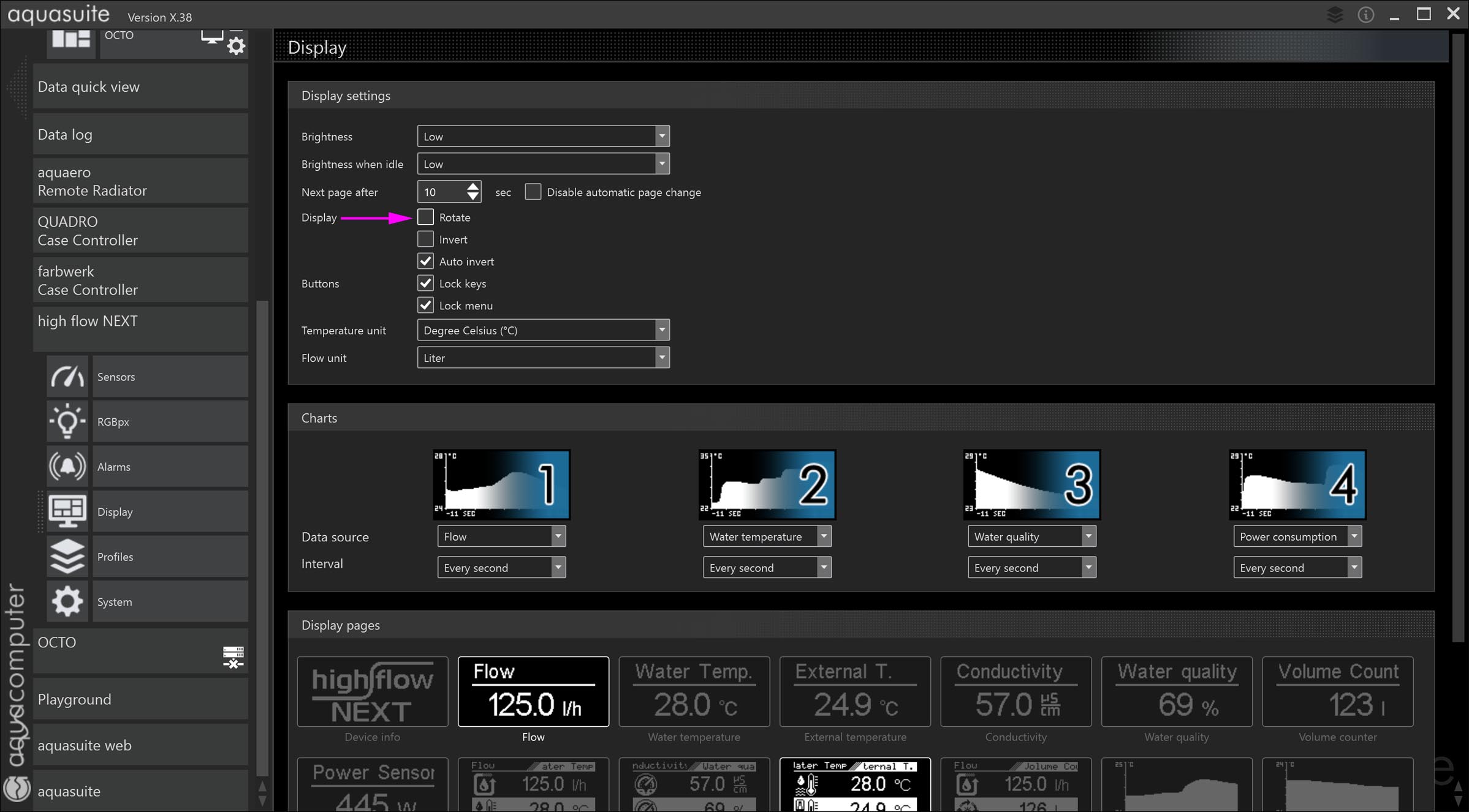

Is it possible to invert the display for running the high flow next with the LEDs pointing down, rather than up?
Montag, 12. April 2021, 14:45
Yes, you can select "Rotate" under Display Settings, and it will flip the display 180 degrees. flow_display_rotate.jpg

  1. The display may be rotated 180°, but not 90° (previous post)
