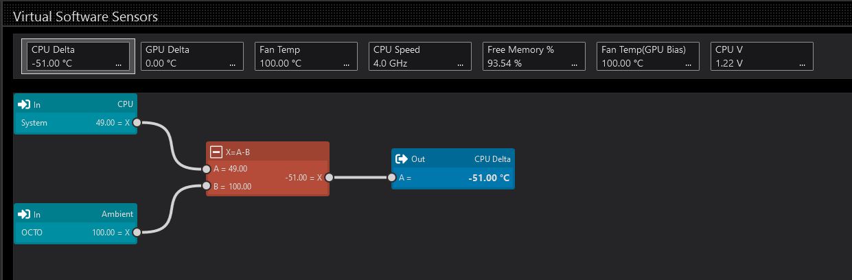

SInce upgarding to X.41 as simple calculation steps to display Delta temps are returning negative values.
Actually looking at it It appears to be be misreading the Ambient Temp as 100
NB I still have X.39 on the other W10 install on this same PC and that is reporting the ambient temp correctly so not hardware issue

Just noted that according to ASX.41 firmware also requires update.
Will try that and report back

Upgrading the firmware has resolved the temp sensor reading issue in X.41 although, as anticipated, the other W10 install running X.39 is now reading ambient as 100c instead.
