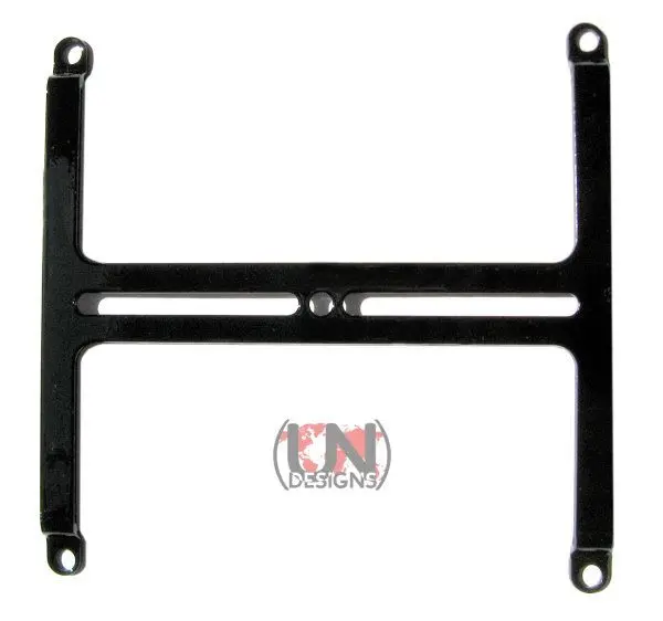

Question on the UltiTube. If i am mounting it to the radiator, anyway way to secure it at the top of the radiator as well as at the bottom? The fixation ring seems like it's meant to fill that role, I don't see any bracket that would be appropriate for radiator mount.

You could use one of the (UN)Design brackets to attach the Fixation Ring.
Can be found at PPCs.

Ah thanks, wasn't sure if there was amore official solution. Too bad the black 120mm version is out of stock and I believe (UN)Design had left the business a while ago. But seems like something similar would work!

It appears the black 120 would need modifying as there are slots right & left on the center bar, but no center hole.
A couple of coats of black from a rattle can would convert the red 120.
EDIT: I am not sure if the red 120 is properly depicted in the description.
It appears the Z3 model is the 140mm bracket with a center hole, and the Z2 is the 120mm bracket with no center hole.
PPCs website is full of errors, and generally I confirm what is shown prior to purchase.
