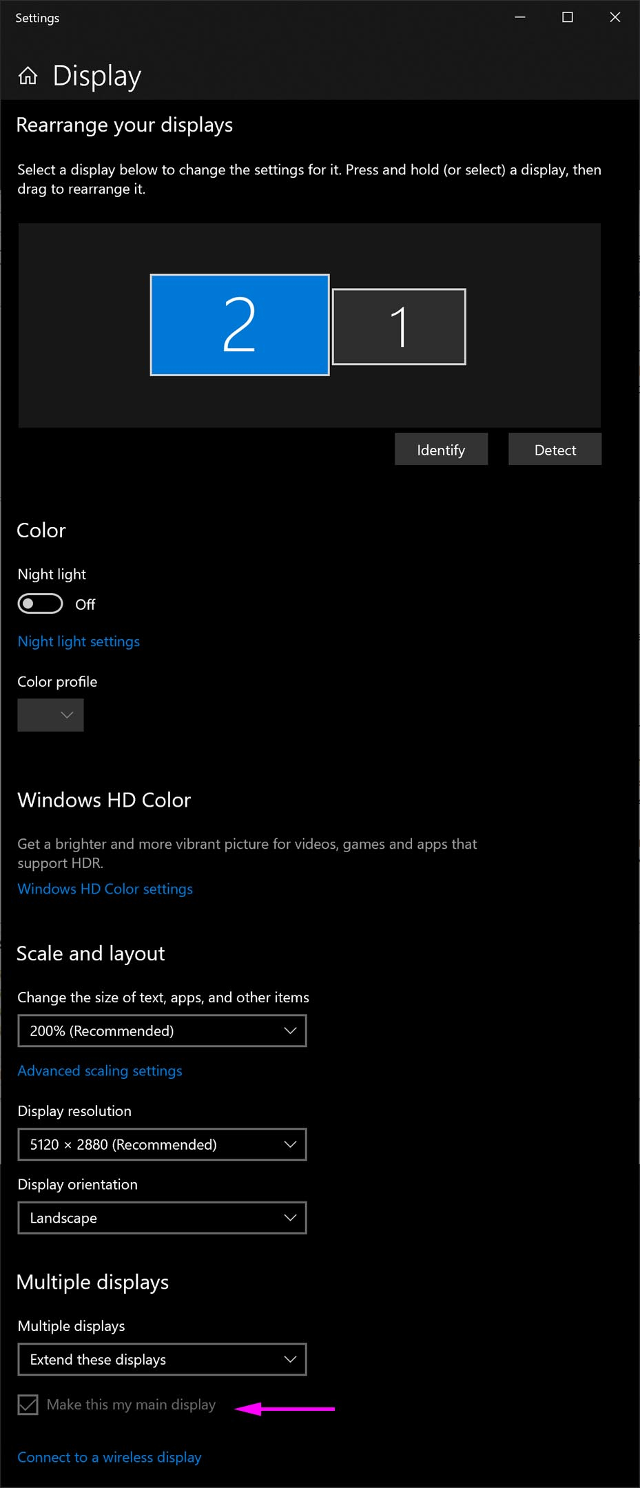

I am wondering if it has something to do with where my 2 internal displays are in the Windows raster. I have 2 main 1920x1080 displays side by side and 2 internal displays. The first one is 1024x600. The second one is 1920x400. In the Windows raster, the 1024 x 600 display upper left hand corner pixel is at coordinate (1921,1081). This places it directly below the right hand main display. The 1920x400 panel upper left hand corner pixel is at coordinate (3841,0). I originally had only the 1024x600 display and I set it so the upper left hand corner pixel was at 0,0. It worked OK but I kept having Windows apps (including AQS) jump off the main display onto the 1024x600 display. I thought ,maybe if I moved the display in the raster so it wasn't at (0,0) that Windows would stop throwing apps onto the display. It seems to work but occasionally an app will still jump onto the 1024x600 display. Now that I added a second display with a completely different aspect ratio, things got a bit more complicated. I drew a picture of the display layout which makes what I did much easier to understand. I don't know if AQS cares at all where displays are positioned in the raster but how I have it set up is kind of odd so maybe that is causing the problem. Here is a LINK to the picture. Thanks again.

In your 'Display settings' (at the bottom), have you designated page 2 as your main display page? (display_setup.jpg)
I believe that defines the 1,1 of your display matrix.
Montag, 13. Dezember 2021, 17:43
In your 'Display settings' (at the bottom), have you designated page 2 as your main display page? ([attach]8953[/attach])
Yes display 2 which is the left main display is designated as the "Main Display" in Windows. My coordinates are working fine, as is the 2-dsiplay page. It just won't stay loaded after auto-loading. It I load it manually it works fine. Same for all of the overview pages, including the AQS generated ones for my Octo and Farbwerk360's. They all auto-load for a split second and then disappear. I checked the coordinates for some of the other custom pages I made. There were some that I had entered a "0" for an X or Y coordinate (same mistake I made in the drawing I linked earlier). Maybe doing this messed something up. I am going to make sure none of my page items have a "0" as a coordinate, then export the ones I want to keep, then try a full uninstall / re-install. I have feeling this may fix the issue, so thank you for pointing out that the first pixel is at (1,1), not (0,0).
