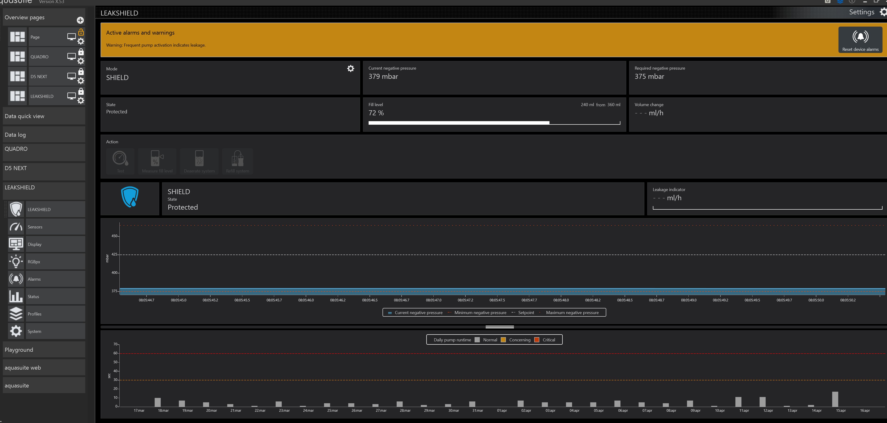

I just got a Leakshield a couple of weeks ago. I have a D5 with ultitube 150, 3x 360 radiator, a 3080TI and a 12900k being cooled. Often when gaming an alarm goes of. I have deactivated the sound. The alarm says: Warning: Frequent pump activation indicates leakage. There is no leakage. How do I disable the alarm for frequent pump activation?

I have the same problem. It was working fine, but I added a gpu waterblock today and now the alarm happens whenever i start a game.

What information do you need?
https://imgur.com/a/obIvbbi
The tubes are 16/10, it worked before i added the gpu waterblock. the coolant is distilled water and ekwb cryofuel clear from concentrate. the water level detection is always off, sometimes way off.
I think i solved the "Frequent pump activation indicates leakage" warning alarm.
My Ultitube 150 is 360ml. I had it filled to 71% when people said I had to little air in it. So i drained it down to around 200ml free but still the same warning alarm came while gaming.
I then adjusted the minimum pressure to 200 during Leakshield setup. So far no alarm.
