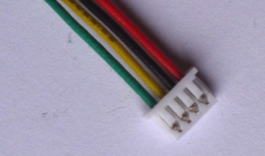

Pictures of how I've connected it are attached (melted green cable removed, yellow moved into its place for picture purpose). Also there is a pic of melted one as well. I've just push end of the wires of loose cables into an argb extension and secured it with tape for testing only. And that was it due to unexpected outcome of the test itself.
Also if I remember correctly, the smoke did not appear straight away, I guess only after aquasite loaded (or maybe on log in screen) good couple of seconds after power up.

vendredi 24 mars 2023, 19:34
[attach]10178[/attach]
[attach]10179[/attach]
It looks like you have the pin numbering on the picoblade connector reversed.
Looking at the connector on the left side of the PICOBLADE SCHEMATIC, you see the side with the two locking bumps up, and the #1 pin to the top.
Your picture shows the opposite side of the connector with label the #1 (yellow), which I believe is actually pin #4

vendredi 24 mars 2023, 20:51
I believe I did it properly. Bumps as per 1st attachment are underneath, not on top. So it is slide to the socket as on 2nd attachment.
I can only see 3 options here:
1. due to poor connection (bare wires slided into argb plug) there was connection issue - as Remayz suggested in earlier post "if your wire has a high enough resistance, it could be "seen" as a load by the quadro, and not create a high enough current to trigger a short circuit protection"
2. led strip was faulty from the beginning
3. RGBpx connector (or logic/controller) in Quadro was faulty - bought it 2nd hand, so maybe someone experimented on it.
Quote Remayz the ARGB extension wire did not melt? only the one from the picoblade cable?
No, all other cables / plugs seems looks completely fine, no sign of any overheating
If everything was connected as should I can try again, all properly soldered this time, but simply I'm a bit scared that I will fry something expensive here.
