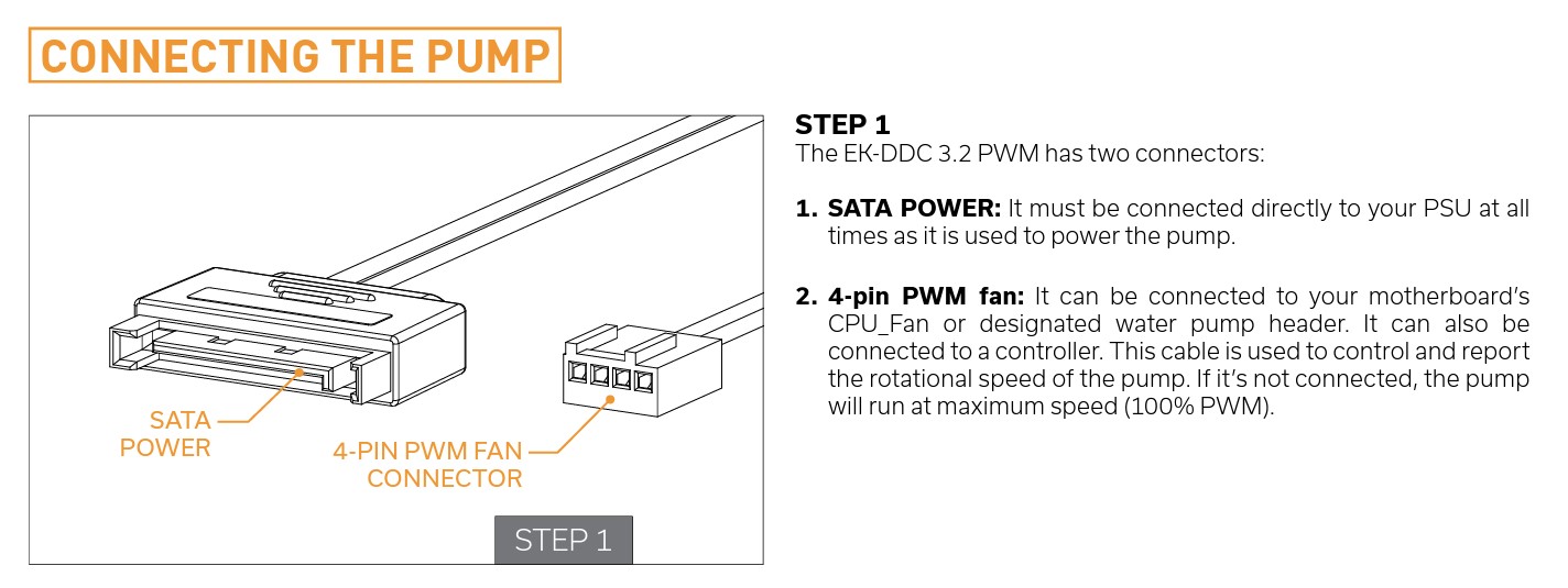

Sonntag, 24. Juli 2022, 04:06
The EK 011D G1 PWM Distribution Plate is the version with a DDC pump. The spec says it has a Sata power connection. They also have one with a D5 Pumpand one with a D5 Mini Pump. I'm not sure what a Mini D5 pump is but the specs for all of these versions say they have Sata power. Are you sure there is only a 4-pin PWM cable and no Sata power cable coming from that pump?
Dieser Beitrag wurde bereits 1 mal editiert, zuletzt von »Speedy-VI« (24. Juli 2022, 04:10)
Remayz
Sonntag, 24. Juli 2022, 04:29
i believe only the retail version of the distro plate has a DDC 4.2. The distro plate that ships with the O11 from Lian Li has another model which is PWM powered only, slightly lower power.
In that case you could do as WinstonWoof advised. If your motherboard has an AIO pump PWM header, that one would be higher power (3A usually) and likely to run at full speed by default (but you have to power on with the motherboard connected obviously).
Since you will need to be able to power the pump standalone in the future, i would probably try to get one of those :
https://www.amazon.com/CRJ-4-Pin-Sleeved-Power-Adapter/dp/B0711CR7HV/
Whenever you will change the coolant, you'll have to remember to set the pump to full speed in the Octo before switching off, or use one of those cables to only send 12V to the pump. either way should do it i guess?

Sonntag, 24. Juli 2022, 14:53
I have the older version EK distro plate which has the DDC 3.1 PWM pump. It only has the DRGB and PWM connectors on it. No SATA connector, which makes more sense to have. The thing is, the specs on it says the pump by default will run at 100 percent when no PWM signal is present. So, I think the Octo, by default, is making it run in PWM mode. I wish I knew the 4.2 version was out before I bought the 3.1 version. :pinch: I will get the SATA to PWM power adapter cable to make future coolant changes easier. I wonder if I can buy just the DDC 4.2 pump to replace my 3.1 pump? Then it will have the SATA connector on it.
