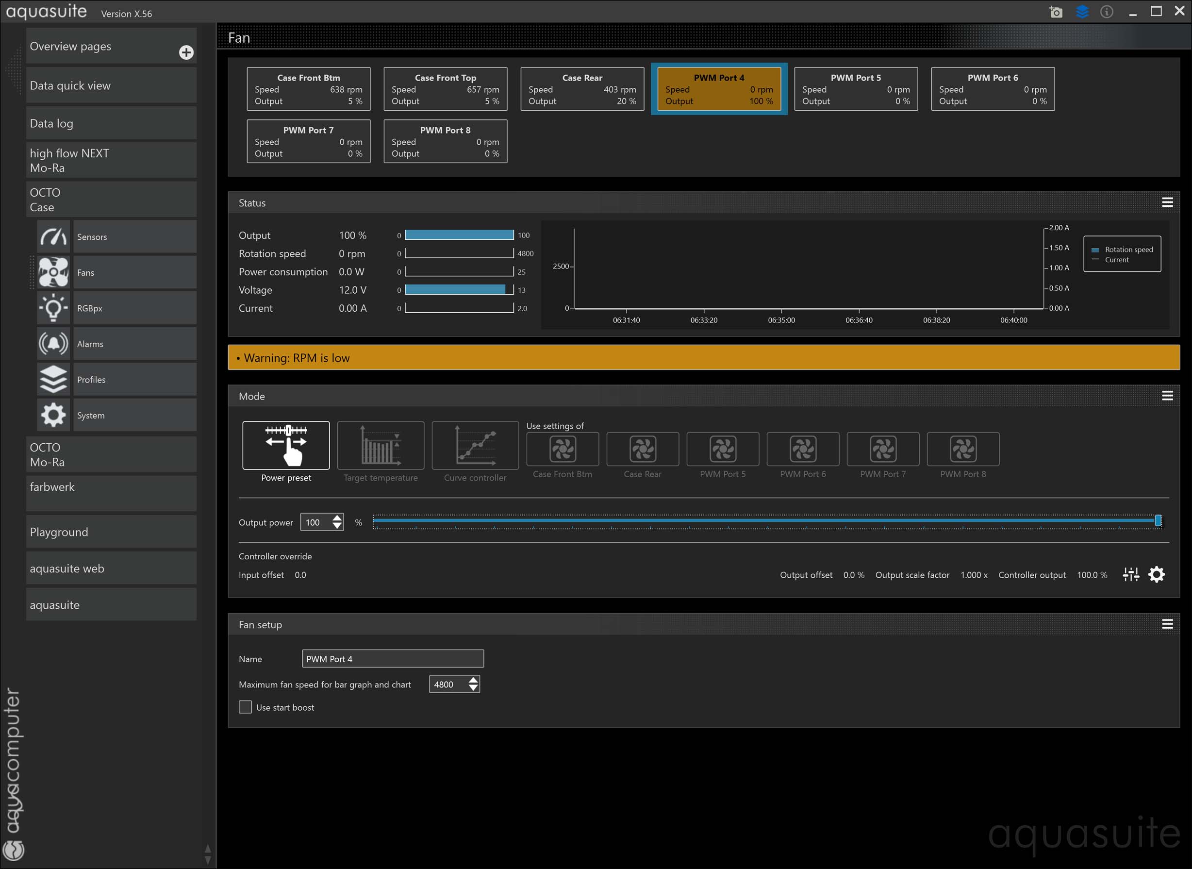

I have the PC build finished now and Aquasuite is installed and running. I tried to set the pump speed to 100 percent, but it still only runs in pulses. I am also at a total loss on how to use the software. Are there any guides for beginners on how to set all this stuff?

mardi 26 juillet 2022, 13:47
Are you getting a "Warning RPM is low' error message on the fan port you have the pump connected to? (Warning_RPM_is_low.jpg)
