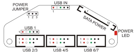

Could someone enlighten me please, the hubby7 looks like it only has 3 usb 2.0 ports on it, or am i missing something
So how many usb cables from all the above items need to be connected to the hubby7 please.

The Hubby7 has 7 USB Ports. Each 9pin connector on the Hubby7 can handle two USB Devices.

The Hubby7 has 7 USB2,.0 ports. The main USB port to the mobo and USB port-1 are both single row 5-pin headers. The headers with 2 rows of pins are 2 USB ports each - one with 5 pins and one with 4 pins. USB2.0 only uses 4 pins and ground.
If you plug in a single-row USB cable, there is nothing preventing you from plugging it in backwards. Make sure to note the polarity of the USB cable and the header on the Hubby7 when you plug them in. If you plug the cable in backwards it won't blow up but it also won't work. In this image from the Owner's Manual you can see that USB ports 2&3, 4&5, and 6&7 are all dual row headers.
