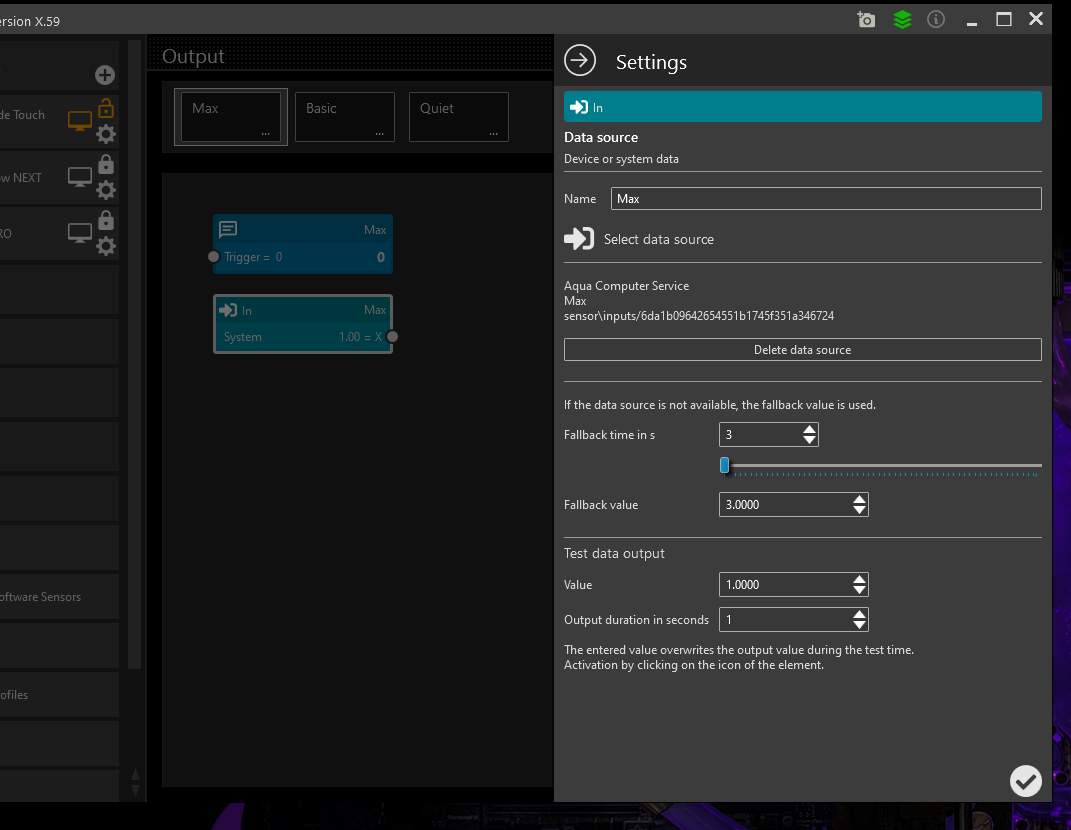

I had already created three outputs, one for each of the 3 different Global Profiles that set my desired fan and pump speeds, as you can see from the first screencap. When you create an output the option to directly change profile is there in the drop-down.
Each of these works perfectly when I select "Test Output" function from context menu of each Output.
I then created an Input of button type, as shown, with absolute value 1, and added that as a Data Source to the configuration of the revelant Output.
I added the Input to the page, but it doesn't work.
Stuck in the mud.
Hoping someone out there has actually done this exact process and can walk me though where im screwing it up, it's ruining my use tbh :/

Dienstag, 10. Januar 2023, 10:14
OK I am an idiot, didnt see I had to link the conditions.
I now have the Input condition working when I click "Output Test Data" for each of the inputs on the output tab, if that makes sense 8|
However, the button on the page flashes briefly a couple of times when I bring cursor to it, but clicking it does nothing....
Testing the button on the input page also does nothing...
Im making progress tho lol..
Next step maybe to configure a 1-3 control knob with output triggered by a set value 1,2, or 3 for each profile.. :S

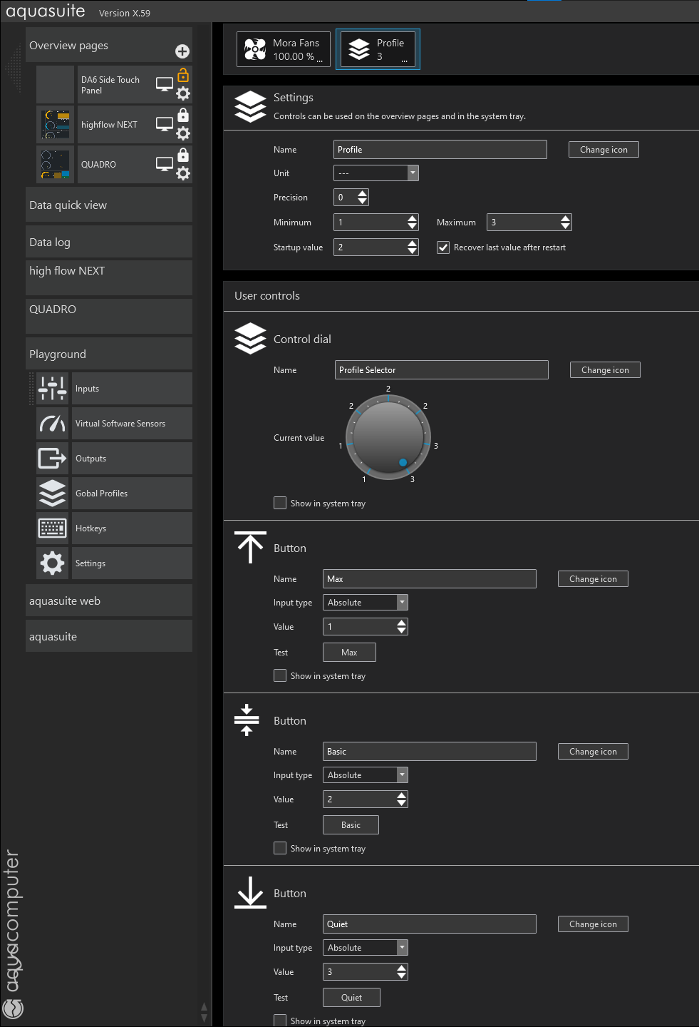

Dienstag, 10. Januar 2023, 10:24
This is working:

Dienstag, 10. Januar 2023, 11:32
This is working:
Ahhhh wunderbar, uberlekker, super!!! :thumbsup:
Thats very cool. This software is ridiculous in power and complexity... Danke, schoener mann!!!
Works with buttons or I can use rotary dial, and now can automate the rest of the mess based on water temp and flow rate also:D
Very elegant, completey bypass the output need :thumbup:
Thanks again :)
