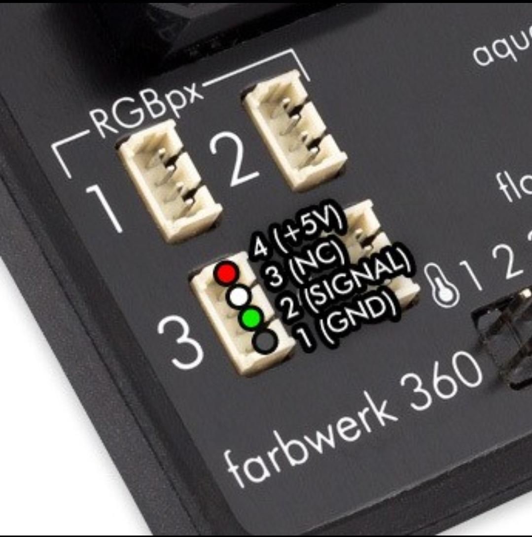

Yes you can do it. There is nothing special about Aquacomputer RGBpx LEDs. They do use a Molex pico-blade connector which is quite small and much better than the horrible connector that has became the closest thing there is to a standard. The LEDs are standard WS2812B LEDs that require +5VDC, Data, and Ground. The 4th pin is not used in an RGBpx connector.
Here is the pin-out of an RGBpx port header.
dynamike
Sonntag, 9. April 2023, 12:44
[attach]10209[/attach]
Thanks for the quick reply! Good to know it's possible and for the pinout. This will definitly help me out.
Thank you! That was exactly what I was looking for!
Please keep in mind that just wiring up the correct LEDs might not work and end up in flickering or malfunctioning (showing wrong colors) LEDs.
The reason is, that the built-in controllers in the LEDs draws current when switchting, which will lead to a voltage drop on the line - enough so that the contollers in the other LEDs might reset.
You will need to add a small capacitor in front of each LED to bypass this

Yes, I think I see a capacitor and resistor in many aRGB leds strips. Is there a schematic including these, and the values? Just to be sure.
