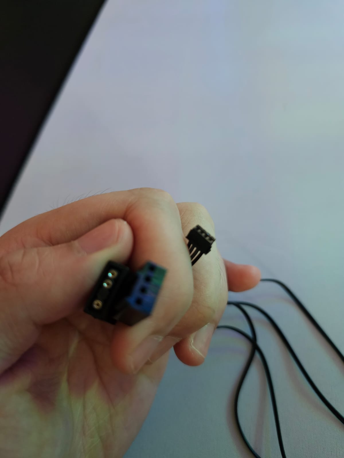

Just a heads up, I do not have that proprietary split into PWM and RGB cable for the fans as I bought 2x triple packs instead of 6x single packs. I have this single cable coming out of each fan group instead.
The Uni Hub is the one with the split PWM and RGB cable. I plan to connect that to the Quadro.
So the final connection would be
2x Proprietary 7 pin from Fans -> Uni Hub controller > Uni Hub split PWM > Quadro
Split RGB will be unconnected and the Uni Hub still has the USB connection to the mobo.
In L-Connect I would select Motherboard RPM Sync option to allow Aquasuite to take control of RPM.
Hopefully this works

Did you ever get this to work? Even when I connect the lian li controller to the quadro, set up MB sync in L Connect, Aquacomputer reports 0 RPM and can't control it. I can get the MB RGB sync to work though so I think the cable is working.
Remayz
Donnerstag, 13. Juli 2023, 21:58
if you have no speed reading, you should disable start boost in the quadro fan channel. that should still allow it to use the fan curve and output PWM even without feedback from the fans.

Hi, sorry for the late reply. Yes, I managed to let Aquasuite override L-Connect software while allowing it only for RGB control. I just had to disable start boost. Keep in mind the fans RPM will still be 0, but the RPM changes will actually take effect.
