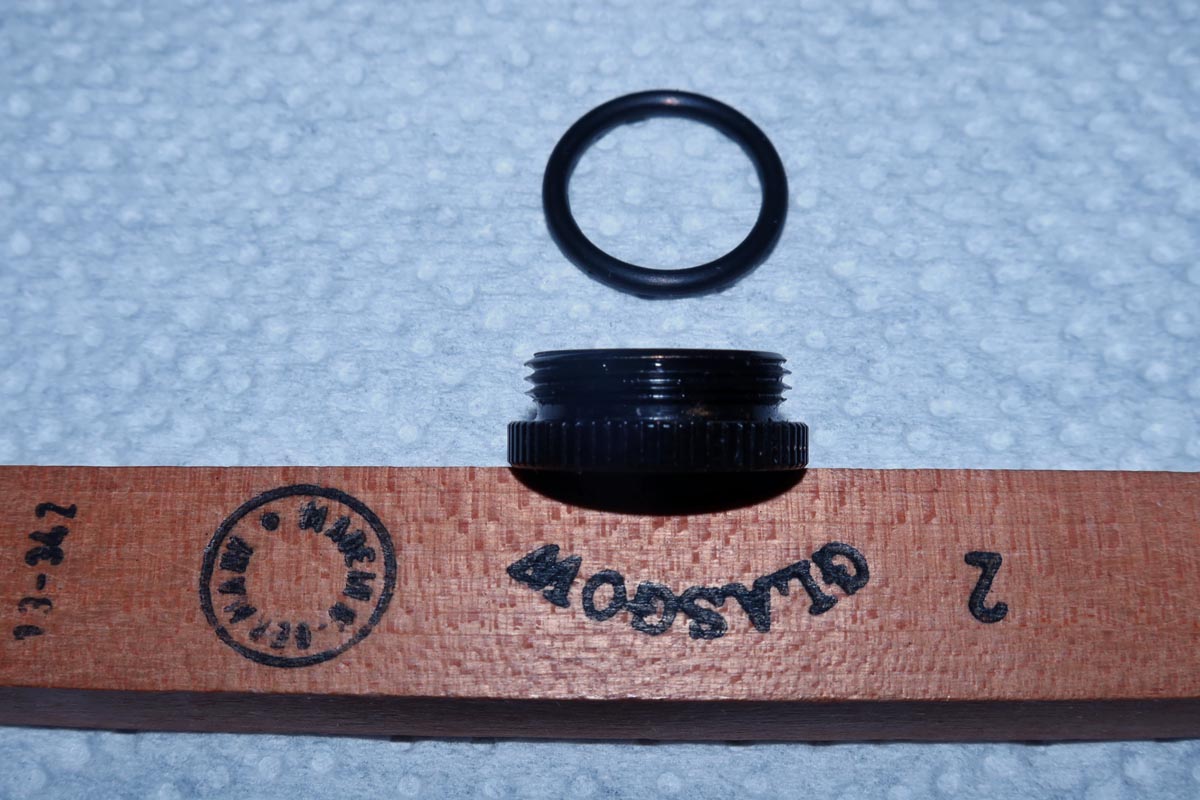

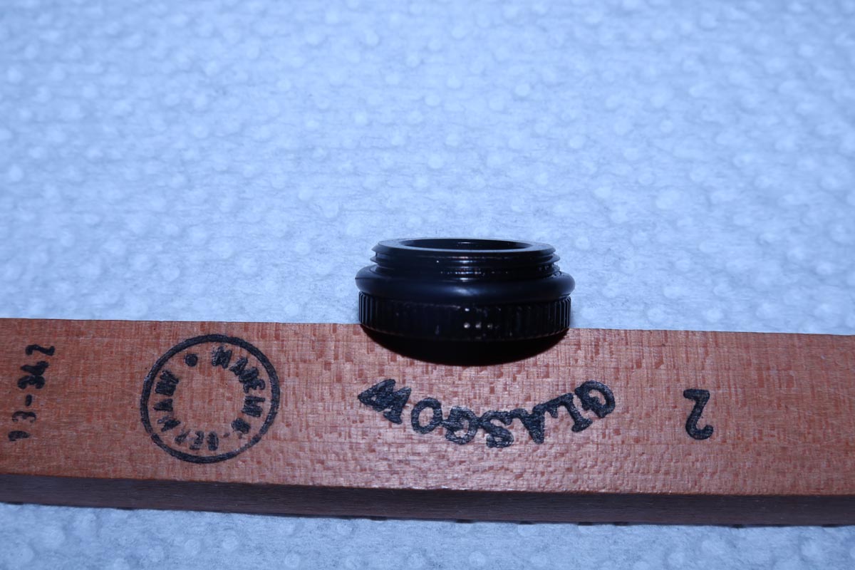

Dienstag, 30. Mai 2023, 04:05
I have one of those Bitspower water exhaust fittings, but I do not use a leakshield.
If the provided end cap was not installed, the fitting would ooze coolant over time.
Adding the end cap seemed to stop the discharge, even though there is no O-ring.
If you are using the end cap, you may try adding an O-Ring to get a better seal.
I used a Bitspower ML O-ring for 16mm OD tubing
(no_o-ring.jpg)
(with_o-ring.jpg)
accat141
Dienstag, 30. Mai 2023, 16:14
Thank you to both people who have responded. I really like both ideas. I was thinking of an o-ring , but was unsure of the size to use. It would definately work better then teflon tape. :)
