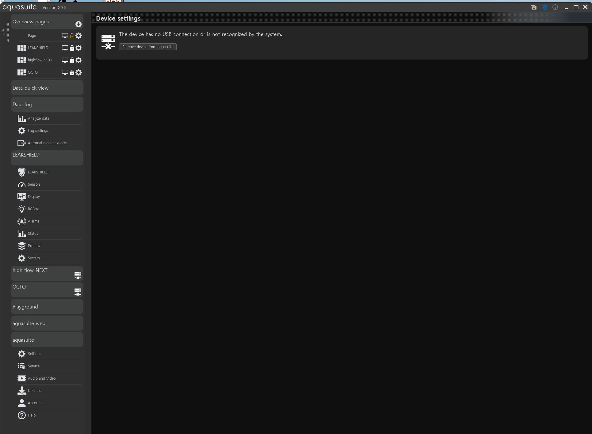

USB connection issues with OCTO and High flow NEXT after Aquasuite version update.
Freitag, 10. November 2023, 20:49
After update of Auqasuite version to X.76. There is USB connection issues with OCTO and High flow NEXT.
After turning on the computer, there are several sounds of usb connection and disconnection. And then It shows The device has no USB connection or is not recognized by the system.
In order to fix this, I have to reboot the computer and If I am lucky then there is no problem, if I am not then it keeps happening again and again.
I am using window 11. I have no clue how to fix this.....
Anybody had this issue???
So frustrating....
»jameslim« hat folgendes Bild angehängt:
switch off the power supply unit correctly. Unplug the power cable for at least 1 minute.
Uninstall the usb device from you control panel, restart your computer.

I already tried that several times.. I never experience this problem before. Is there any way to go back to the previous version?
This has nothing to do with the aquasuite.
Uninstall the USB device in Windows. Settings -> Devices -> Remove
