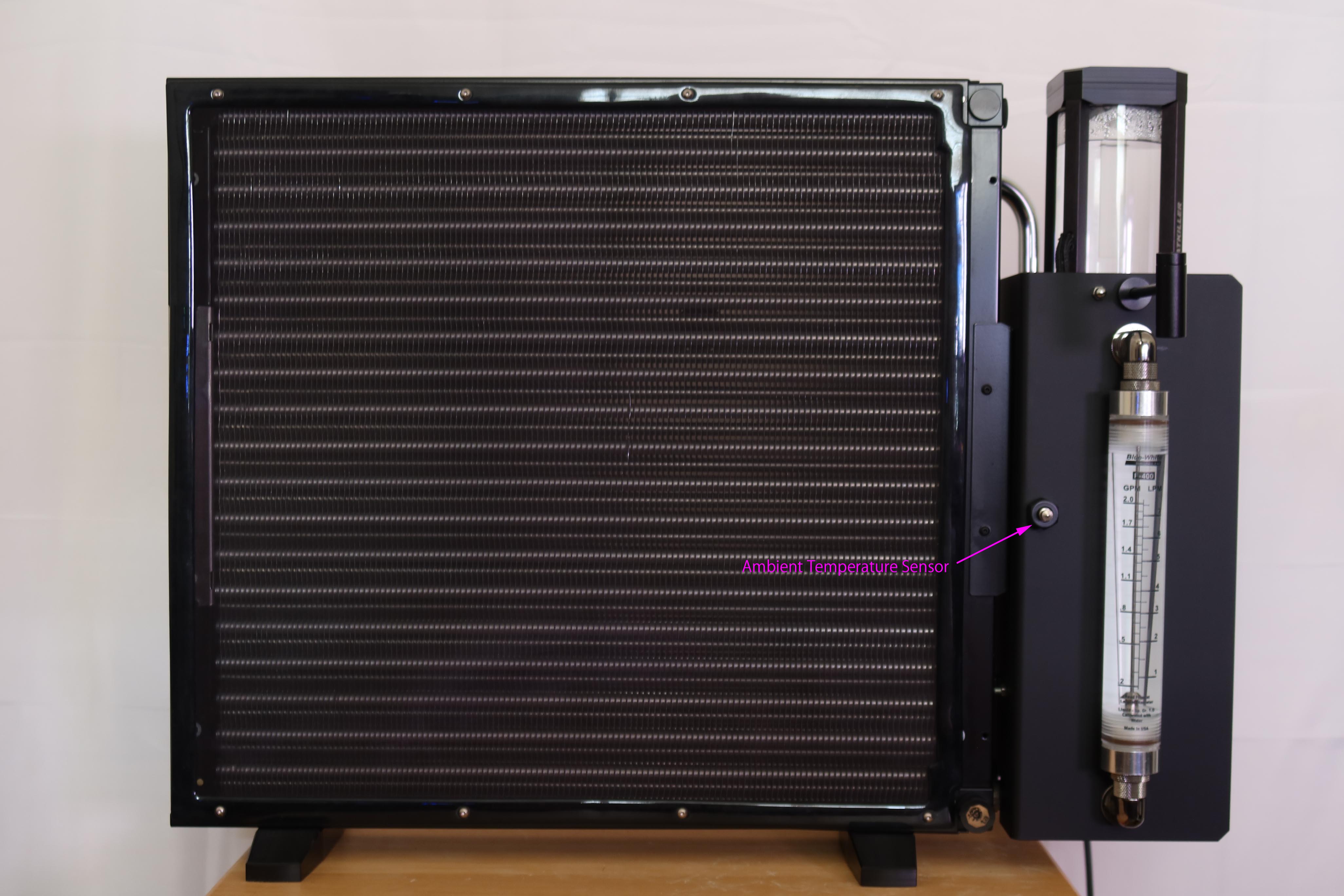

Placement of the Ambient Temperature Sensor is important, as radiators radiate. I hang a 90cm 'Stop Sensor' out the back, about a 30cm above the floor. On my current system the ambient sensor was initially located at the front of the radiator, but I found the reported ambient rising as the system load grew.
Hera is a picture of the old location showing the relationship to the radiator, The new sensor cable can be seen going down at the right side below the analog flow meter. (mora.JPG)

Thx Info. My one working air sensor cable is only about 12cm long ... all the other long ones are returning silly values.
