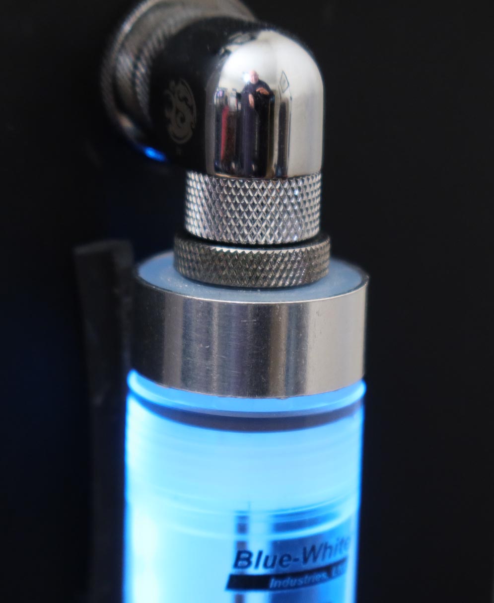

I have a 3/8" BSPP bottom tap that I have used in the past, but I did not tap the NPT end connector this time
I used a Bitspower 3/8 to 1/4 adapter, and since the thread depths is only 5mm, it seated the o-ring just fine before any binding presented it self (fitting.jpg)

I used a Bitspower 3/8 to 1/4 adapter, and since the thread depths is only 5mm, it seated the o-ring just fine before any binding presented it self ([attach]10582[/attach])]
Thanks for the tip about the Bitspower BP-BSWP-C23. May I ask where you bought them? I checked ModMyMods, Performance PCs, Titan Rig, and Frozen CPU for the this fitting. No luck other than Performance PCs, where it does come up in a search but when I click on the item, the product page is not found. I need to make a final decision on which model to get, then I can worry about finding proper adapter fittings. I have found NPT to BSPP adapters but so far they are always the same size on both ends, so if I use an NPT Male to BSPP 0.250" Female, I will have to get the -4 version of the flow meter. I would prefer a nickel-plated brass adapter and wonder if THIS hydraulic hose fitting with 18 threads per inch will work. AFAIK, standard water cooling fittings have 19 threads per inch. I will search McMaster-Carr and Grainger some more. Generally, I find it oddly amusing that we water cooling enthusiasts have to become precision plumbers. :D

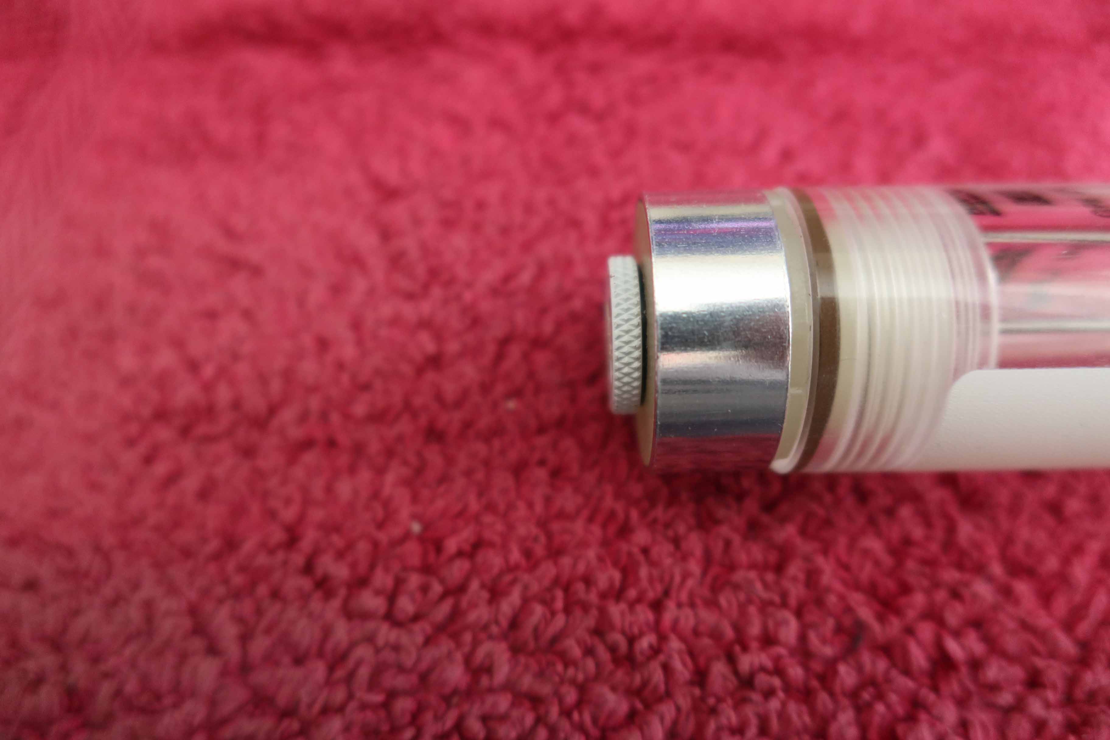

Got the Blue-White F400 with the 1/4 NPT ends.
The threaded female ends on the flow meter are slightly beveled at the top of the thread, causing the o-rings to on the G-1/4 fittings to not seat properly.
The standard o-ring supplied with Bitspower fittings look to be 1,5mm thick, so I tried 2,5mm thick o-rings I had laying around, and that seemed to work.
It is an option if the overall height of the flow meter with the adapter fittings is too tall.
2.5mm o-rings: oring1.JPG
Fitting with 2.5mm o-ring: oring2.JPG
