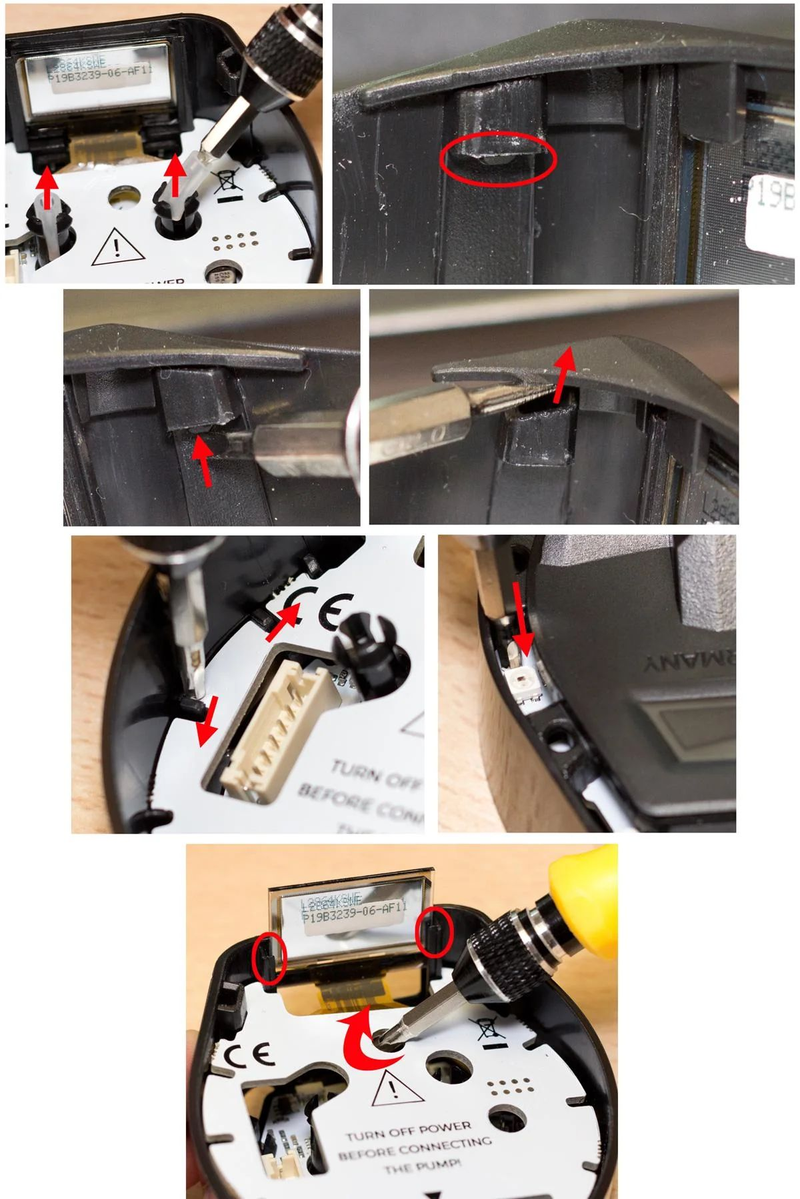

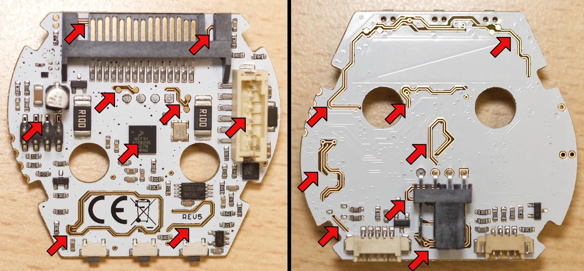

I have not had this happen to my D5 Next but have seen posts about this happening before. There are multiple moisture detection locations on the main circuit board (see pic #1). I recall reading that they are VERY sensitive so the slightest bit of moisture is enough to trip the alarm. In THIS THREAD OP was able to fix it by taking the pump apart and drying it out; I don't know if the Moisture Detected alarm will reset after doing this (OP did not say).
Here is a LINK to a post from Shoggy (Aquacomputer Rep) from the Aquacomputer Official Support vendor sub-Reddit that provides detailed disassembly instructions. Pic #2 below is from that post. If you search this forum and the Aquacomputer Official Support Reddit you will find more posts about this. I am providing this info FYI. You may want to wait and see if you get a response to your post from Aquacomputer. If you do decide to take the pump apart to dry it out, be very careful.

[attach]10942[/attach] [attach]10943[/attach]

No, that feature works reliable and can be only triggered when one of the sensing lines became wet.
