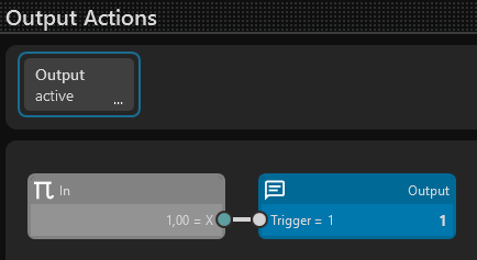

the repat is automatic enable wenn the trigger is > 0. You have to map a 1 value to the input to enable the notification.
finalist5344
Mittwoch, 19. November 2025, 02:09
[attach]11197[/attach]
And now it works! Thank you very much.
