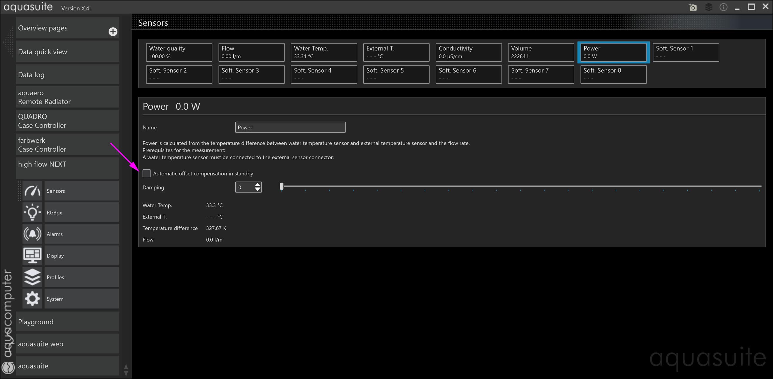

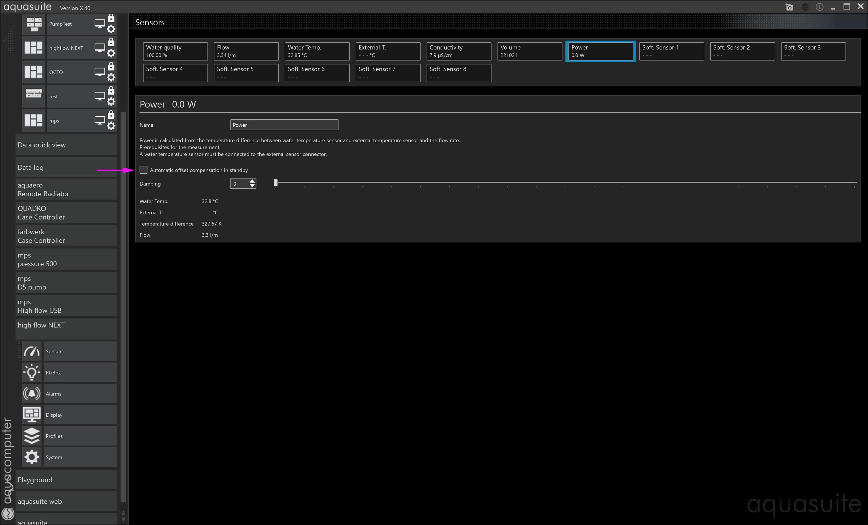

My questions is, does the 'Automatic offset compensation in standby' continue to function with 'Display off'? (flow_next_auto_compense.jpg)

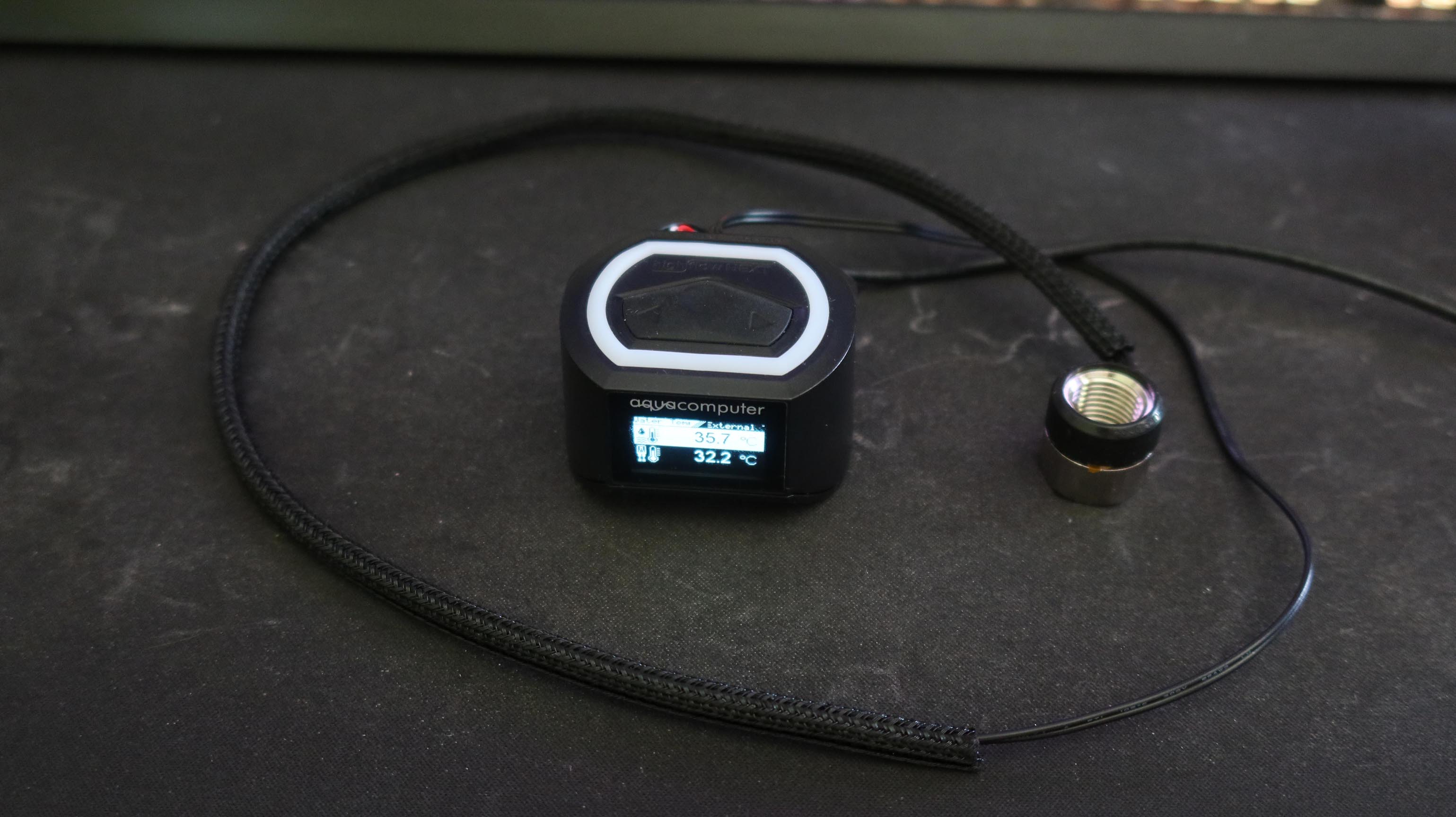

High Flow NEXT internal temp sensor bias
Mittwoch, 28. Juli 2021, 15:39
It appears there is a bias on the internal temperature sensor of the High Flow NEXT, most likely due to proximity to internal electronics.
In air:In water, no flow (similar to system OFF)
Not using the aquabus option, I disabled all optional functions, with no vissible impact to temperature (flow_next_standby.jpg)
I suspect the bias may not be apparent on the internal sensor with the warmer temperatures when the system is running.
But I believe it would heavily impact the 'Automatic offset compensation in standby' function, by adjusting the offset on the external sensor by some 3° (flow_next_automatic_offset.jpg)
If the 3° bias on the internal sensor 'disappears' under working conditions, it would be additive to the external sensor with 'system on' status.
Bottom line, it appears the 'Automatic offset compensation in standby' function should not be activated.
Dieser Beitrag wurde bereits 3 mal editiert, zuletzt von »InfoSeeker« (28. Juli 2021, 15:55)
Mittwoch, 28. Juli 2021, 16:39
The high flow NEXT temperature sensor doesn't work correctly when there is no flow.
Of course the complete device including the sensor will heat up due the heat of the LEDs, Display, PCB. So you need at least a small flow to measure exactly.
If a flow is applied it's one of the best water temperature sensors available at the market and less influenced by ambient air then many other sensors.
