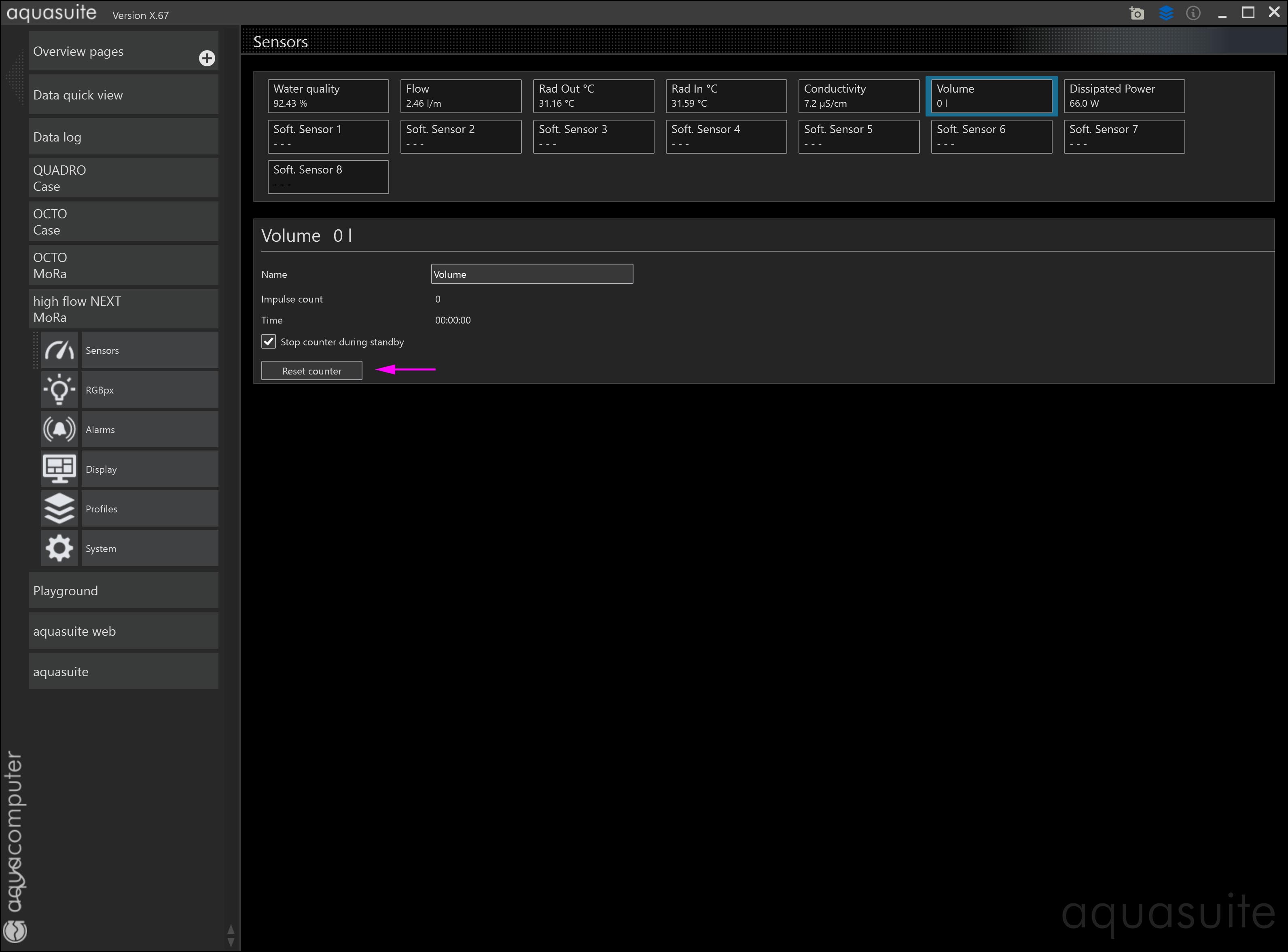

Could I have a different unit for the volume, its now at around 1 million litres so it not such a practical unit anymore.
the standard SI prefixes would be fine. even in the play ground there is no other units for volume
You can reset the counter in the Sensors Tab (reset.jpg)

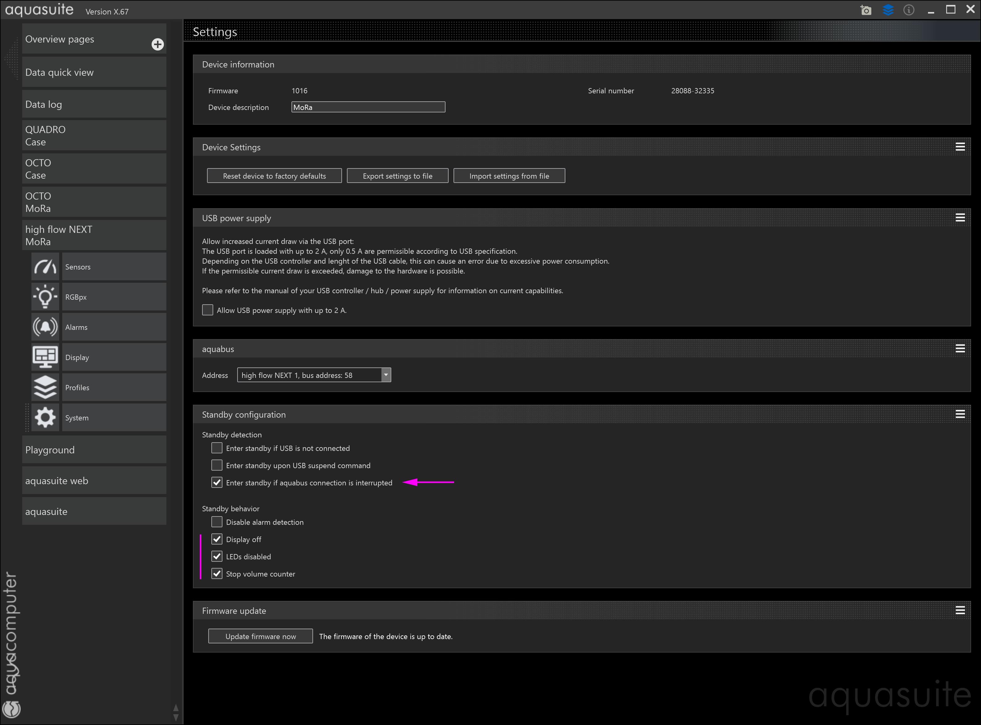

I turned mine off in the System Tab (volume_off.jpg)
  • I do not have an aquabus connection, so selecting "Enter standby if aquabus is interrupted" should place the unit in standby
  • then I select "Display off", "LEDs disabled", "Stop volume counter", disabling all three

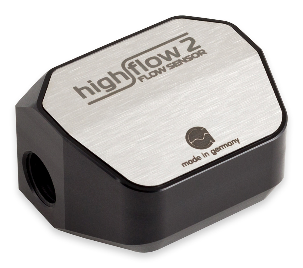

high flow 2 - The new generation with water temperature measurement
I picked one of the above up, really liked that included connector ... but it does mean I am left with some straggly wires. I shall try to sleave some of them.
But ... I have some questions ...
Q1: The connector to the flow hardware is small, finicky and once I got it it I am unsure how to get it out. Any hints regarding extracting it without pulling the wires out?
Q2: Does purchase of this flow meter extend the software license?
I have an aquaero 6 and I have the 3 pin plugged into the flow header and the temp plugged into one of the temp sensors. I am assuming the other (smaller) plugs are for other bits of aquacomputer hardware (Quadro?).
i
Remayz
Freitag, 3. November 2023, 20:28
grab all the wires firmly, flat, and pull :P
the very small white connector is for quadro and octo yes.
And no it doesn't extend your aquasuite update subscription. it is not a USB device.
Peter von Frosta
Freitag, 3. November 2023, 20:30
Q1: just grab all wires close to the connector, wiggle and pull at the same time.
Q2: I don´t think so, because you need an additional Device to read the flow signal (e.g. Quadro or Aquaero) with a (expired or active) license.
Q3: Yes, the spare connectors are for other Devices such as Quadro, Octo, etc with smaller sockets

Freitag, 3. November 2023, 21:04
Thanks guys.
