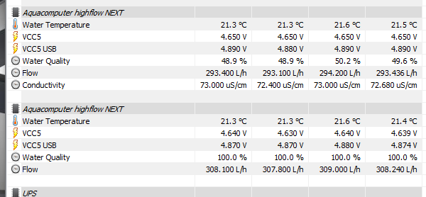

I have 2 high flow next units since I have separate loops for my CPU and GPUs. I am testing both on my test bench using new EK cryofuel clear. Both make a high pitched click and one gives a conductivity of 0 with the other one 79 to 100. They are both on the same line. Reducing the flow doesn’t seem to help the noise that much. My older 2 high flow sensors don’t make any noise at all even with flow rates greater than 200l/hr.

Here is the data from HWInfo.
»Hopper64« hat folgendes Bild angehängt:
Samstag, 13. Februar 2021, 04:44
That's about a 5% delta in flow rate between the two units, which is not atypical for analog flow meters, but I expected better accuracy/repeatability for digital.
And that water quality result is dismal... the devices may not be calibrated for EK fluid. but I would expect a much closer result between the units.

I expected better results as well. My older aquacomputer flow sensors work well with no noise even with flow rates greater than 300l/hr. I was looking forward to having conductivity along with temp and flow rate as routine data for my loops, but this is disappointing. Hopefully it will be addressed quickly.
Samstag, 13. Februar 2021, 11:48
@Hopper64, do you know why the Conductivity value is missing for the bottom unit in the HWiNFO report?
The Water Quality calculation may default to 100% if no value is received?

Hopper64
Samstag, 13. Februar 2021, 12:50
I thought about that too. I assume since it’s zero it’s not reported but I don’t know for sure. I’m using the latest beta of hardware info 64.
