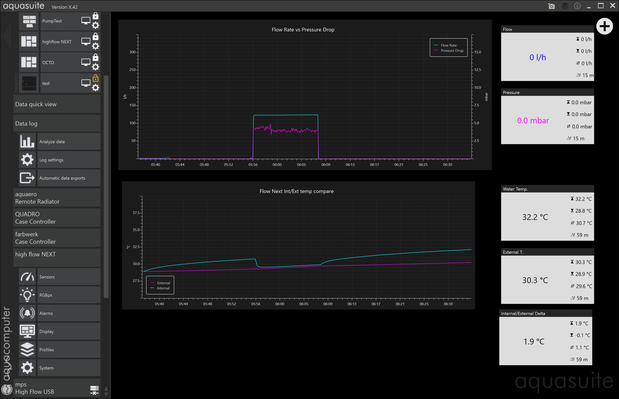

I would not use the 'Automatic offset compensation in standby' option.
The internal temperature sensor in the Flow NEXT is biased due to it's proximity to the internal electronics. When coolant is flowing, this bias is overwhelmed and the sensor appears to read an accurate coolant temperature. But when there is no coolant flow (standby mode) the sensor experiences a 2 to 3 degree temperature increase over the stagnant coolant.
If this raised temperature is then applied to the external temperature sensor, the external sensor will be off by 2 to 3 degrees. The bias on the internal sensor will again be overwhelmed when coolant flows, but the external sensor will remain incorrectly biased by 2 to 3 degrees.

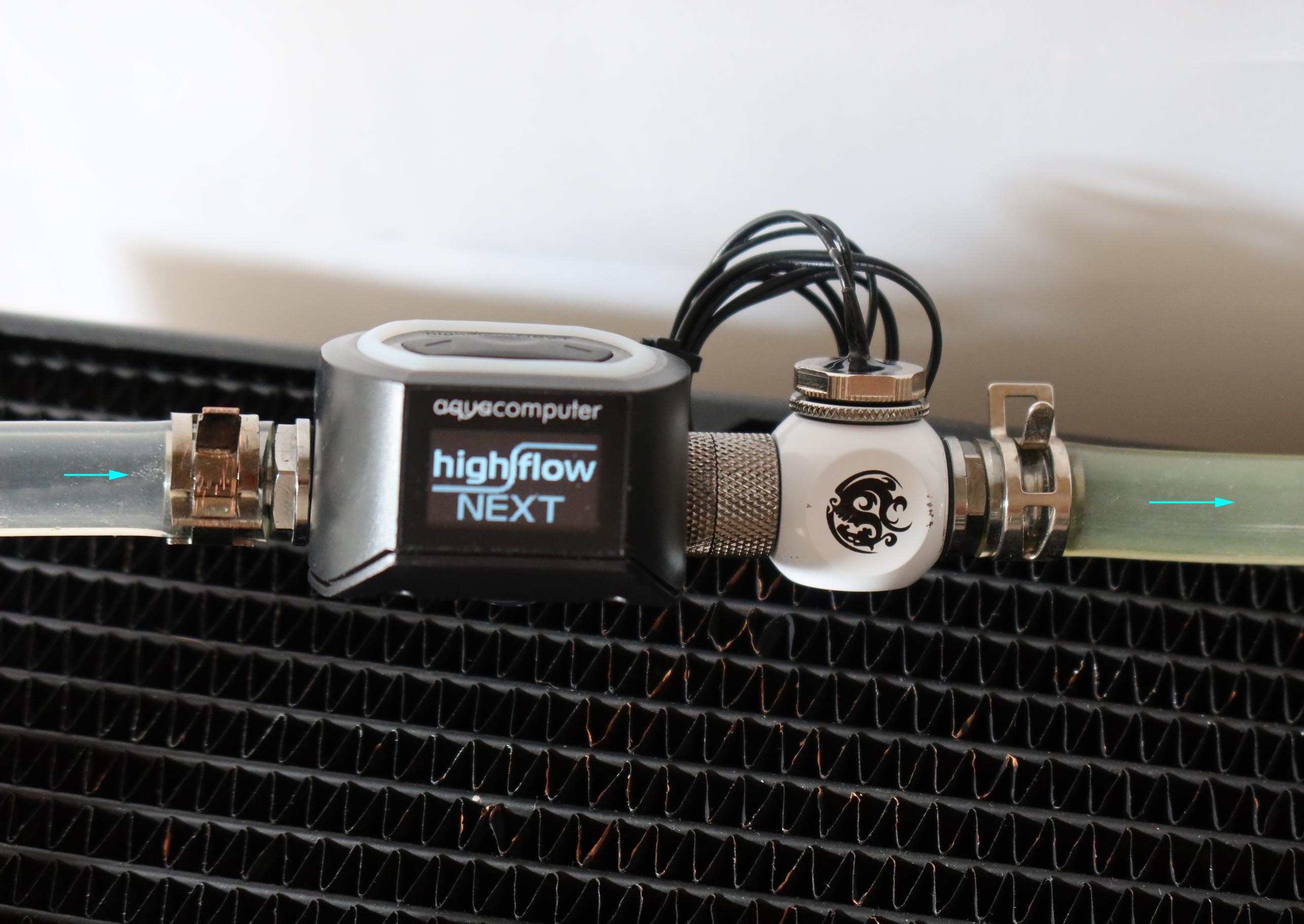

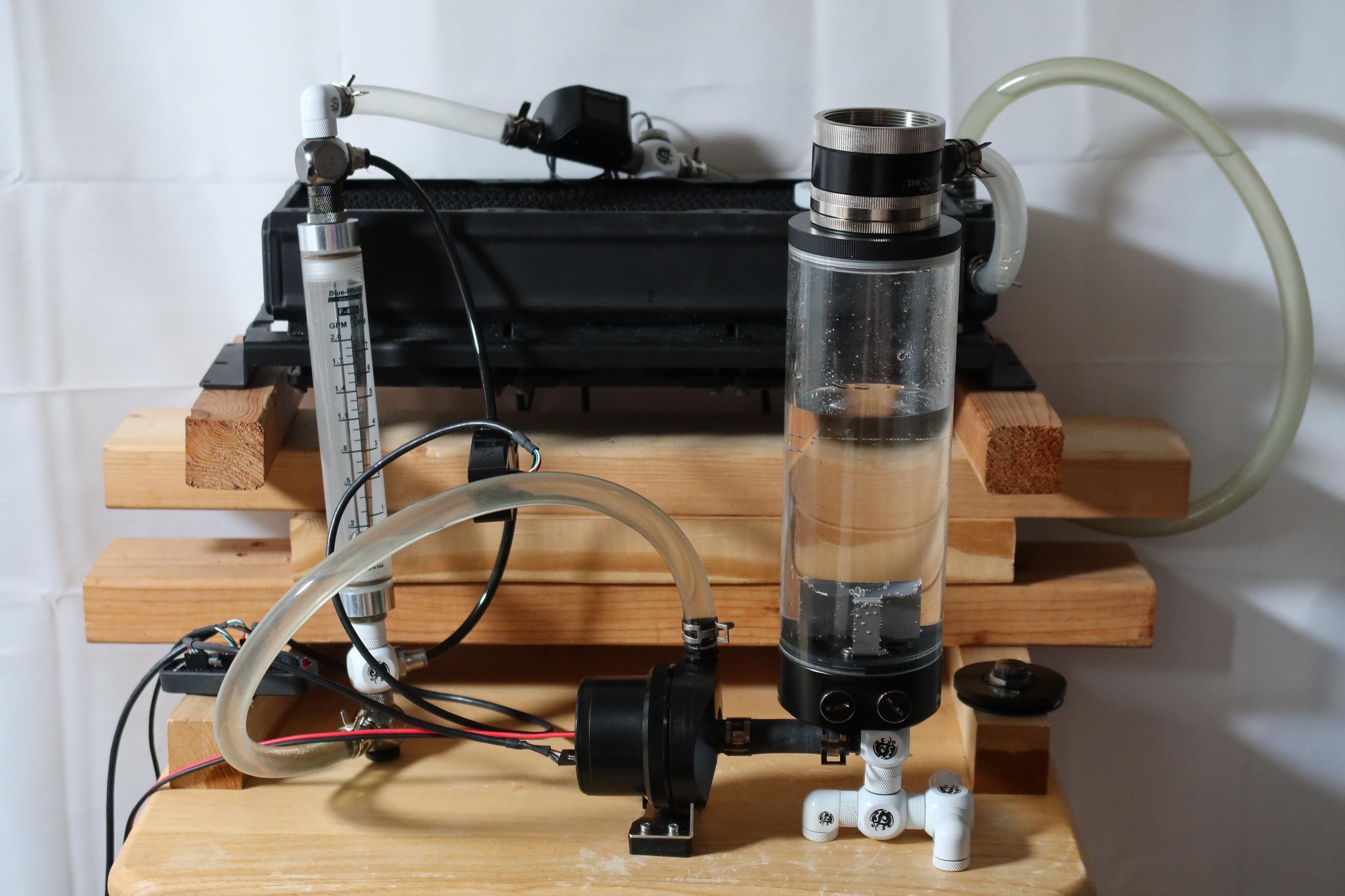

I made a simple test setup, with the only heat source being the pump (setup.jpg)
Flow NEXT relationship to External Sensor (hfn_ext.jpg)
Charts showing temperature sensor status according to coolant flow (flow_next_temps.jpg)
  • at start, when the hubby7 gets plugged in, with pump unplugged, both internal and external sensors are within 0.1° (28.8 vs. 28.9)
  • the Flow NEXT internal rises as time goes by
  • when I activate the pump, the Flow NEXT internal sensor drops quickly while the external sensor remains steady
  • when I de-activate the pump again, the Flow NEXT internal sensor rises, while the external sensor remains steady
  • that is what 'standby mode' looks like, and matching the external sensor to the Flow NEXT internals sensor would introduce a large error to the external sensor
The
coolant.
2 to 3 degrees.
I made a simple test setup, with the only heat source being the pump ([attach]8687[/attach])
Flow NEXT relationship to External Sensor ([attach]8688[/attach])
Charts showing temperature sensor status according to coolant flow ([attach]8690[/attach])
  • at

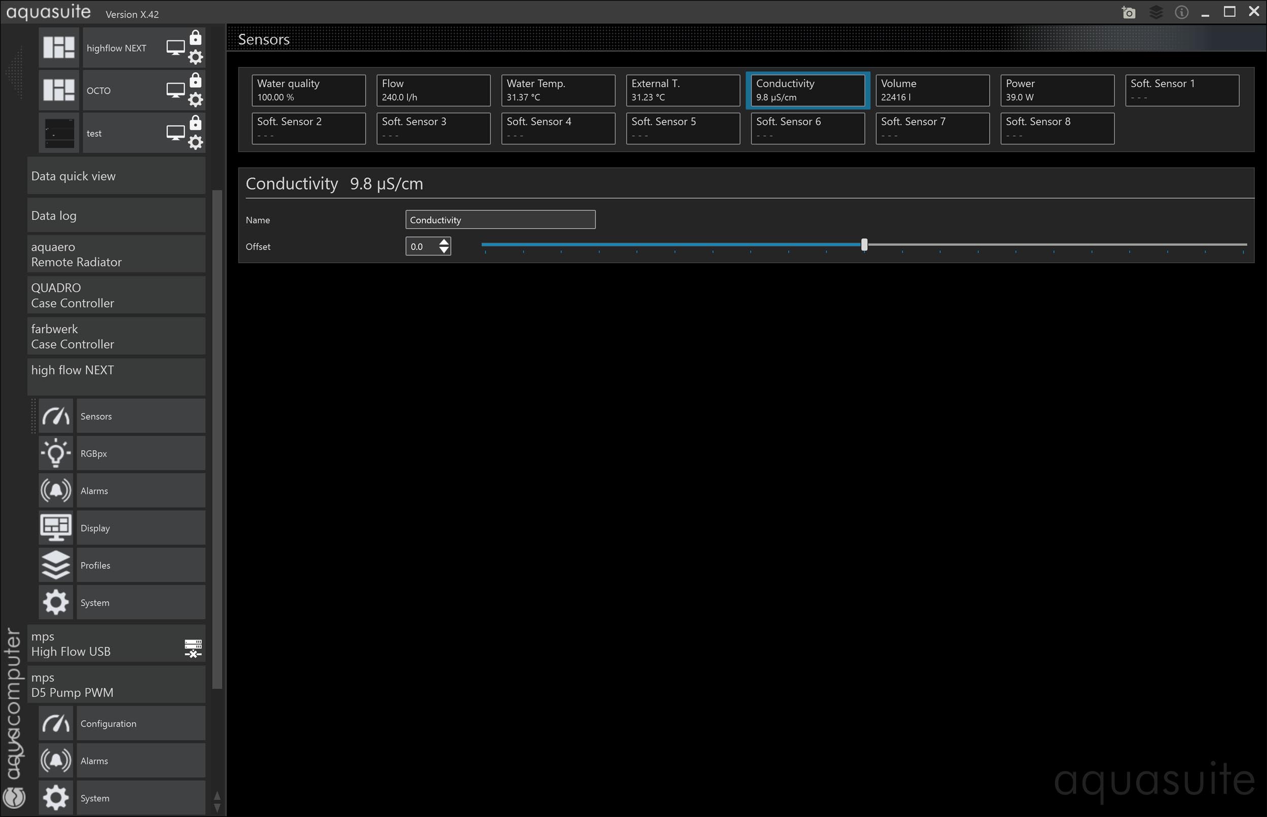

Samstag, 21. August 2021, 21:04
I'm running distilled water in my little test loop which yields 9.8 µS/cm (distilled.jpg)
